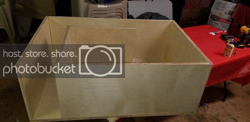

This Christmas my fiance got me 2 Alpine Type r 12s and a JL JX1000/1D which was a huge surprise knowing that we are saving for a wedding I was so happy she wanted me to have something since I'm on empty after getting rid of everything go save for our wedding I'm so grateful to her.

Box Measurements:
36Wx14.5Hx24D
Box Specs:
Net: 4.03 ft3
Gross: 5.84 ft3
Port Width 5.5 in.
Tuned: 32~33 hertz
Port area: 71.5 In2
Port Volume: 1.61 ft3
Port Area Per Foot: 17.74 in2
Merry Christmas to me!

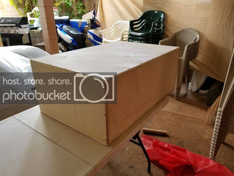

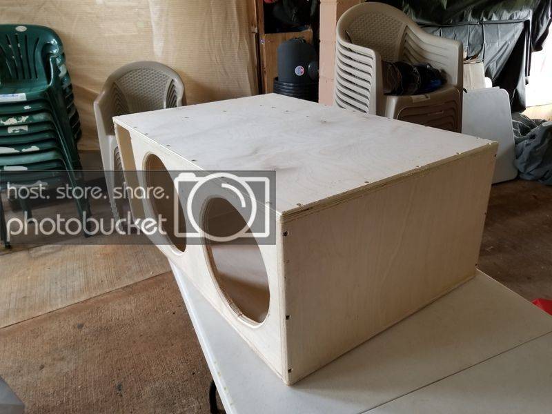

No 45s this time just a daily no competition some bump in the trunk

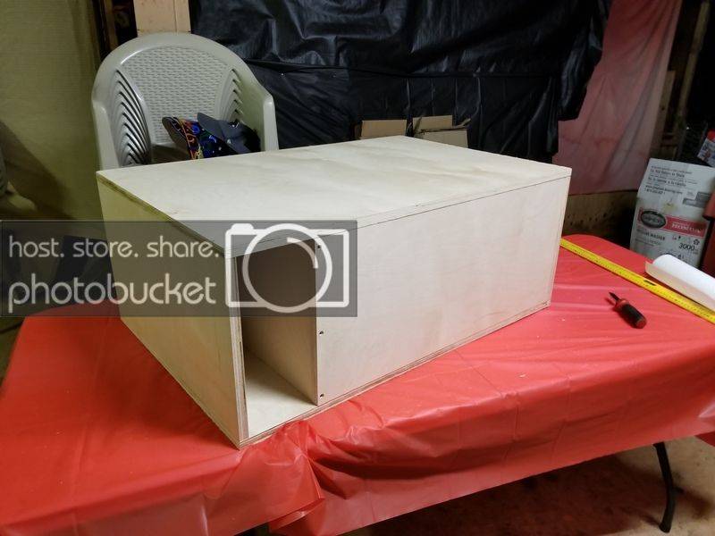

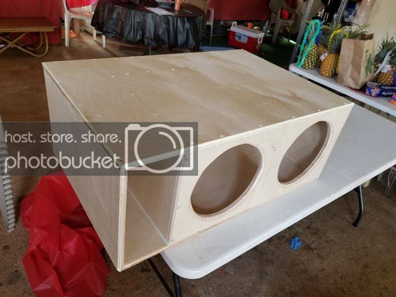

Rounded the whole box looking real clean

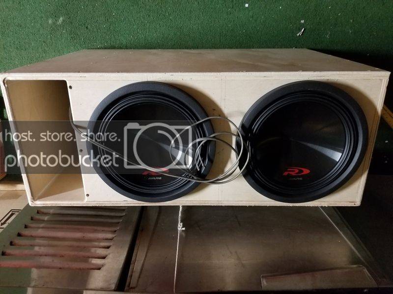

My mistake the router slipped and took a bit from the port
Didn't wanna use any terminals right now till I decide what type I want to use.
1/8/18

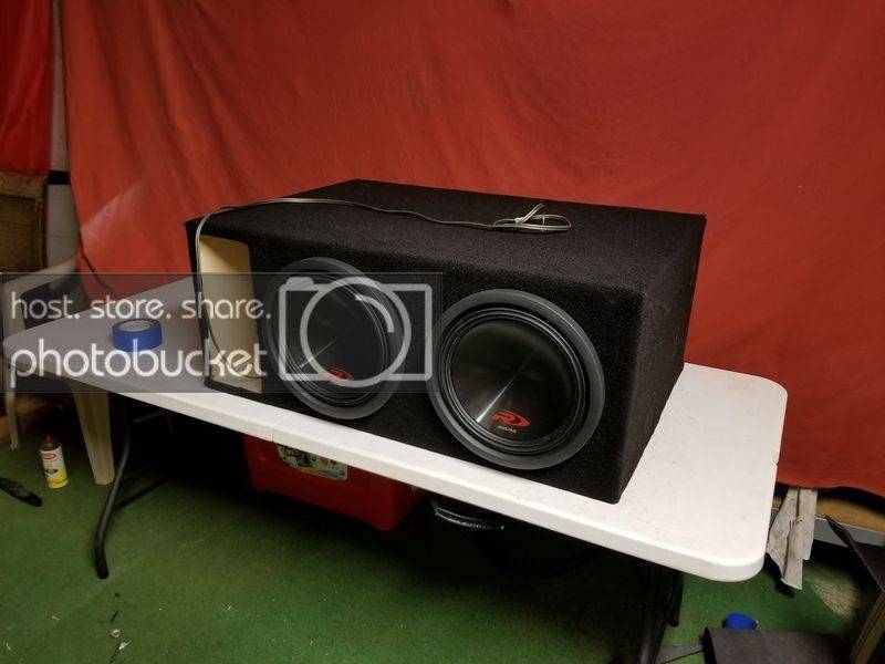

Wifey said no need paint the port black so no need but took my first shot at carpeting a box. 1 thing make sure you get the right carpet cause this carpet was pretty thick but it was from my father in law so... I went at it. The wifey had to do some patches for me I'm so thankful.
Very nice. Congratz to you man. Planning to deaden the trunk?
Actually the first year I bought my car back in 2012 I did everything already foamed the bumpers the trunk lid, I matted the whole trunk and put I forget what it's called but a 1/2 inch I think AC or was it garage insulation around the lid and I redo it every year. And just couple days ago I rolled bedliner into the trunk since all off the deadening was getting nasty and sticky.
I would just go with a ported box tuned from 32 hz. - 35 hz.
