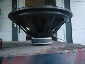

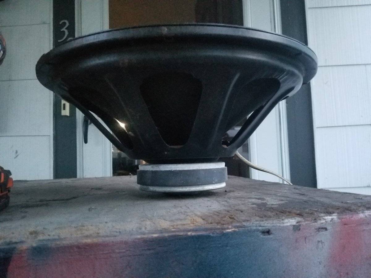

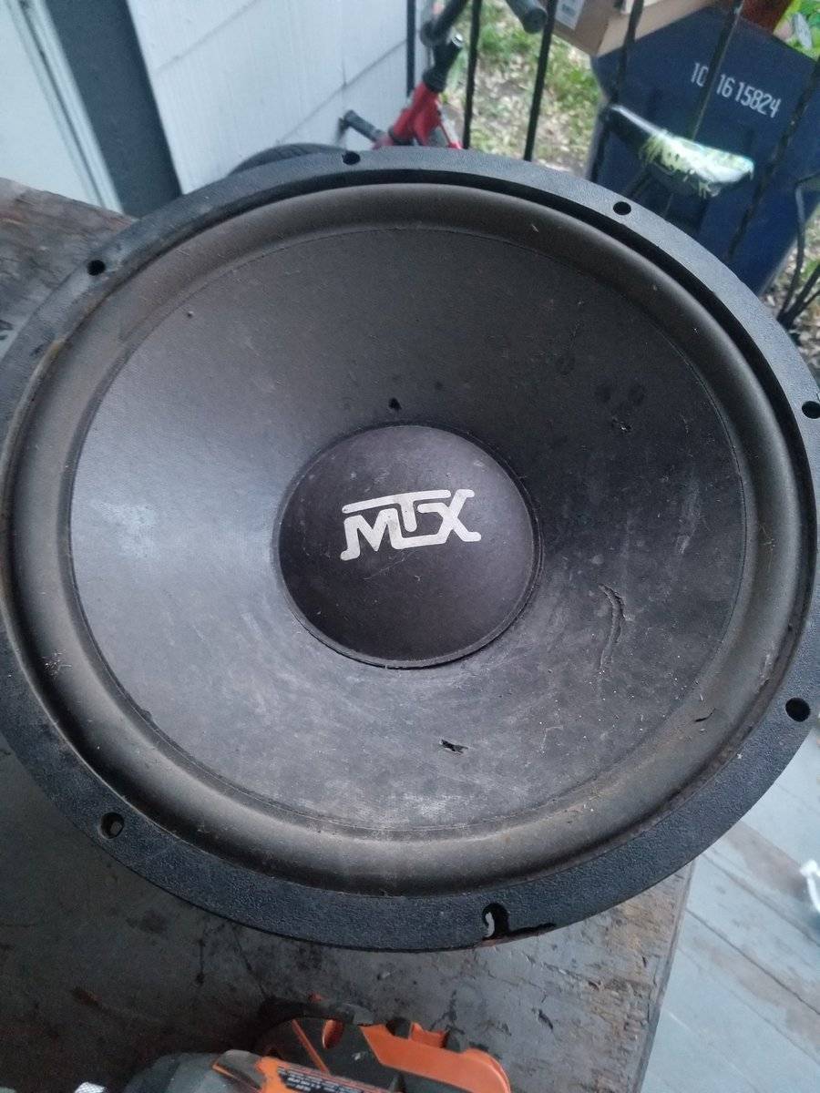

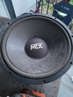

I picked up this 15in mtx sub without model
Does have 15rd954 listed on magnet but nothing shows online that matches this sub
Cone is paper
Help looking for specs as building proper box too would be helpful thanks in advance

Mate, if you are daring, just get a screw driver and open one up to see the driver. MTX made good gear back in the day, (showing my age here!)  :laugh:
But jokes aside, do open one just to take a look.  I remember, Cerwin Vega 'red surround' series  the XL series were used in PA systems as well and they were made to be used in vehicles as well!

The code gives it away mate.  The 15rd954.  Its a Road Thunder 15 inch series, made in 1995 and its 4 ohms.  If you plan to use it then give it a clean and seal the hole in the surround using salistic / guey silicone based black tar looking glue. Just apply a dab from the back of the woofer cone so you cannot see it from the front.  You may have to seal the tear with some glue first before you apply the black glue.  Also the dust cap seems to be giving away so seal that with super glue as well!  Now as long as the voice coil is all good, it should give you years of enjoyment in your car, home or man cave! :fro:

With those old school subwoofer, they would suit larger size box and given its a 15 inch, go for at least 2.5 cu ft box , ported with 4 inch port x 9 inch length, should make it sound good mate!
That is TOTALLY it! Thanks all! I couldn't find it for the life of me.
