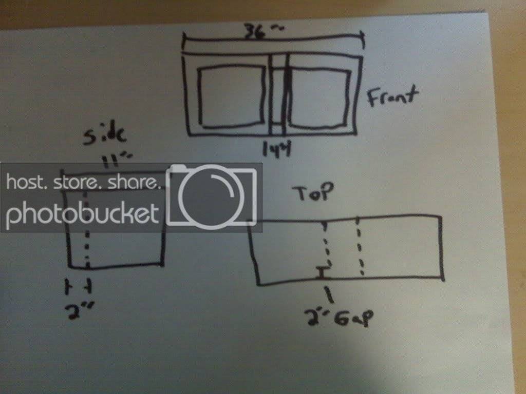

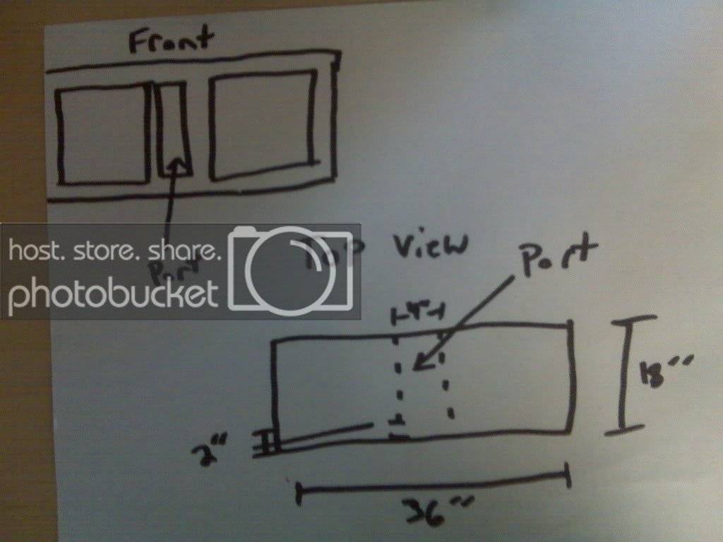

Hope they show this time.
Yeah it's understandable enough.
Seriously though, build or buy a sealed box until you can get a properly built ported box.
Yeah my friend has an extra one.... hopefully id be able to get it from him. What would happen to the subs having it in the ported box?
If you're not sure of the actual tuning...
1.) They can sound like crap
2.) Mechanical failure(depending on the tunning)
And due to improper tuning it may not be loud enough for you, so you are more likely to clip your signal trying to gain that missing output, or low end extension.
1.)Okay... how do you determine what a box is tuned at?
2.) Also if a box is sealed does that mean it is not tuned?
3.)If not with a sealed box does different size sealed boxes sound better than others?
btw thank you very much
