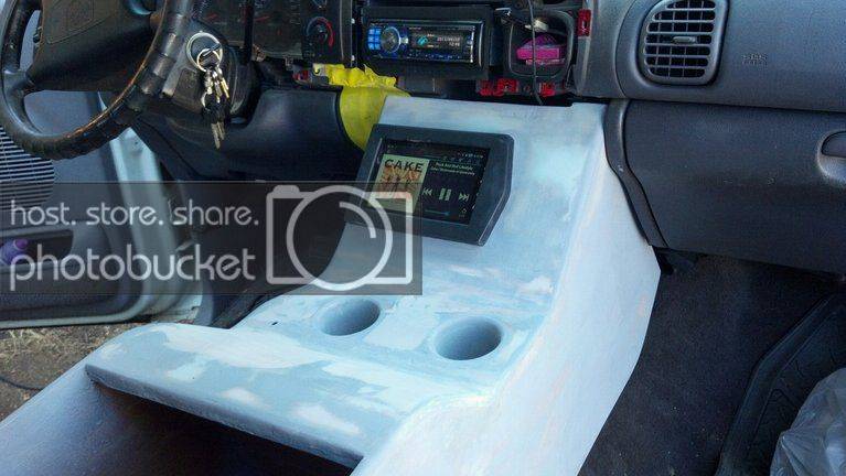

It's far from finished but, here's a test fit of a console I'm building with a Galaxy Tablet in it. I know it's not a dash install but there is a good bit of glass work in the console itself. And, the cradle and frame for the tablet is custom built with neodymium magnets and alignment pins to hold it in place while still allowing the device to be quickly and easily removed...
And... I'm only ~200 miles from you. A lot of people come here from Dallas and leave all their money at the casinos... with me, you'll have something to show for your hard earned cash. :)
Looks good, but I'd ahve to see more of a final product before I head down that way. On the amount of glasswork, I shouldn't be a lot. I'll outline my plans for it below, I have it planned out I just dont' have time to do it.
I wouldn't expect you to drive and spend on one or two pics of a half finished project. When I'm done with this thing, there will be a build log and, of course, final pics and video. And you're right, what you want isn't a lot of glasswork but it is intricate glasswork and to be sure, the bondo you experienced should have been resin or kitty hair. Bondo is filler, not a foundation.
But in the long run, I would recommend going back to a head unit and building some sort of outboard housing for the tablet. Perhaps it's just because I'm near a half century old but, I just think it's a good idea to have something a bit more reliable as the preamp and source switch than a tablet. After all, if the outboard tablet crashes, you could still source music with your phone or some other mp3 device through an aux input, a cd, a USB device or... not that I would ever do this personally... FM. :)
