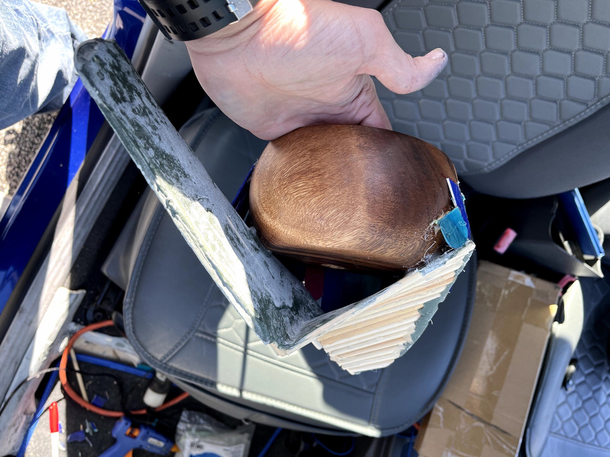

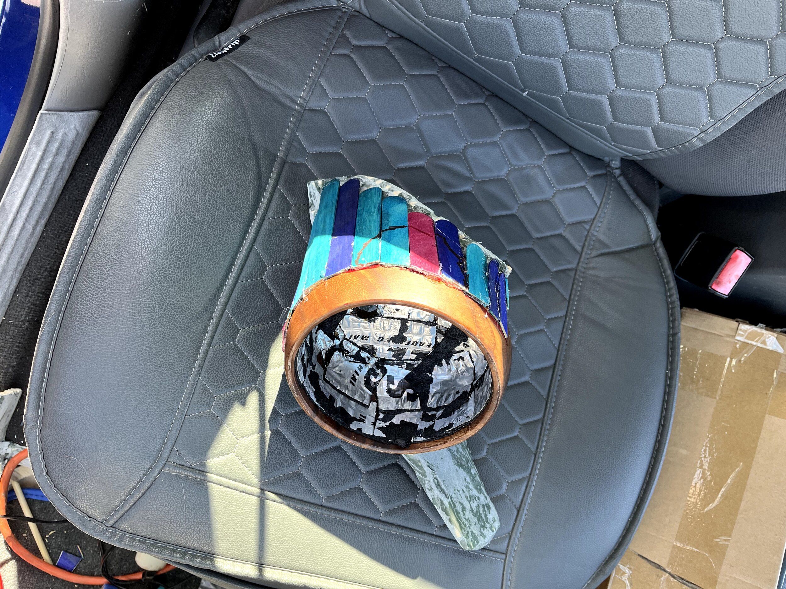

Here are a few more pictures of the mounts for the "salad bowl" enclosures. I put down a layer of tape, and drew a template so I knew where my outline was. Then I used hot glue and wooden dowels to get the initial form that I could cover in some reinforced fiberglass.
This is why I like working with bamboo. The next couple of photos show me trying to glue a dowel rod to the others but it is straight. It doesn't match up with the contours of the panel. In the second photo you can see by some "cooperative" bending the wooden dowel takes the shape of the door panel. You can feel the fibers being crushed when you bend it. Its a satisfying sensation. You can't bend it into a circle but it does move quite a bit.
Once all that nonsese is complete we end up with something like this..

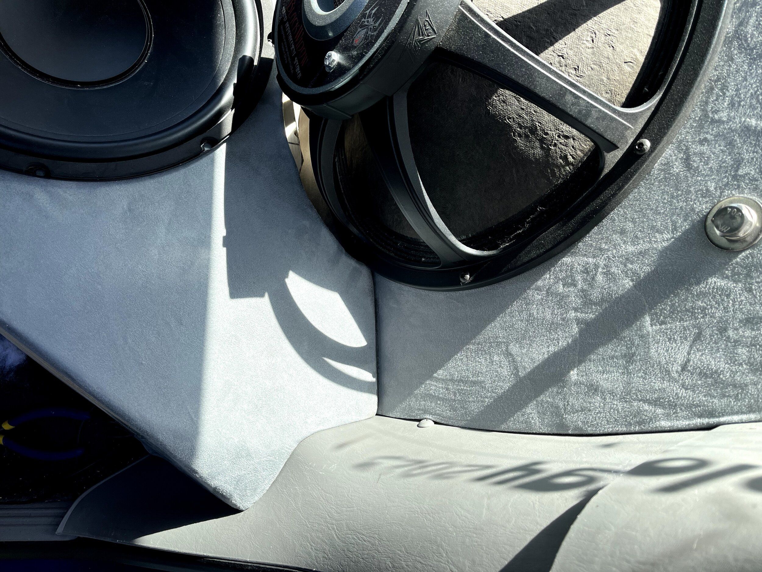

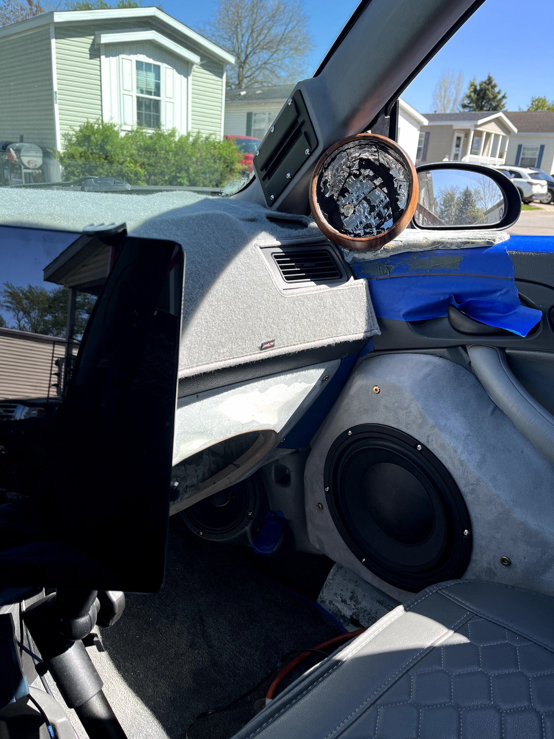

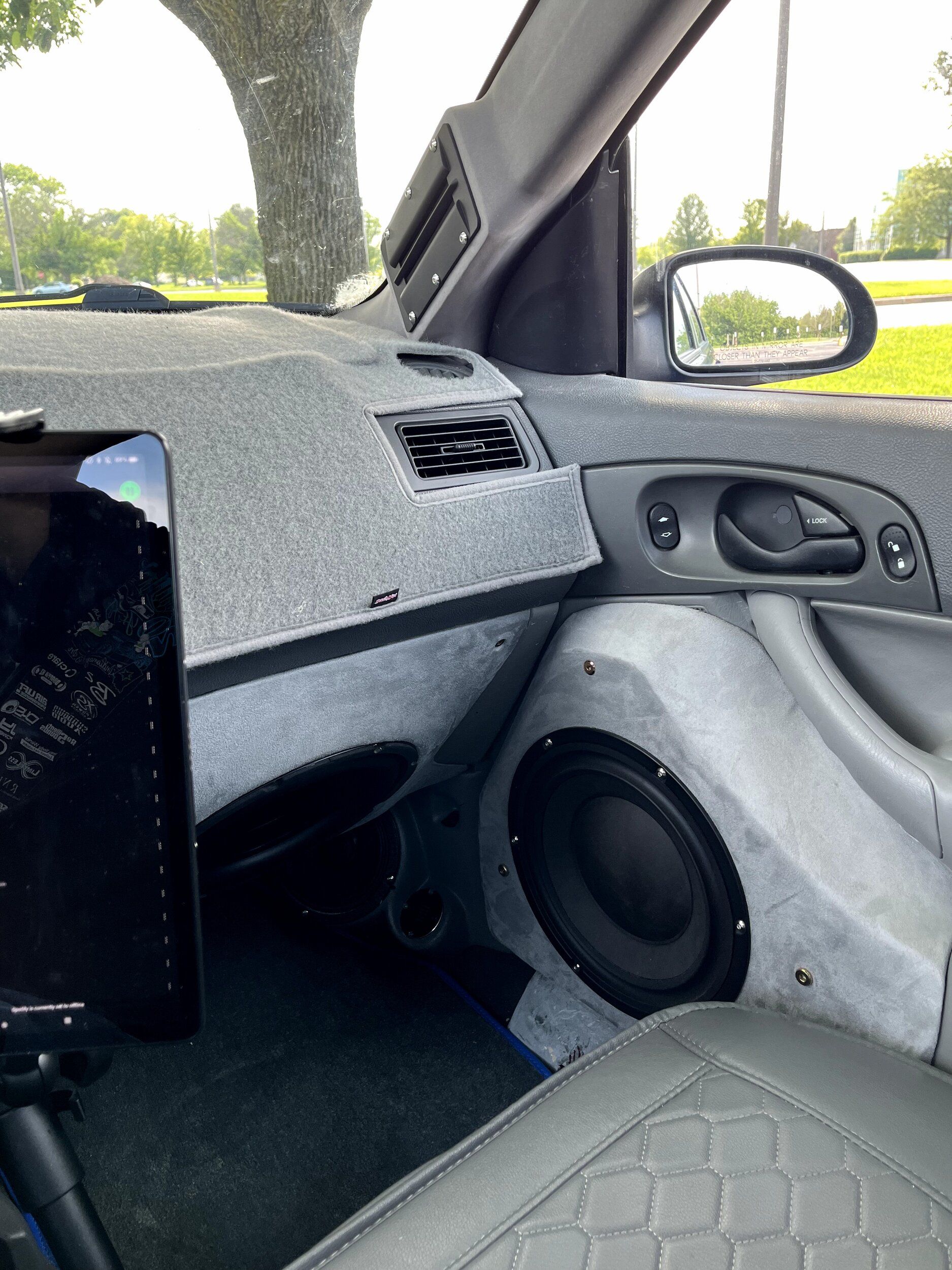

So the midbass trim panel has been covered and they have been wired up not screwed down yet. I spent a good amount of time working on the fullrange at the top of the door and the glove box sub today.

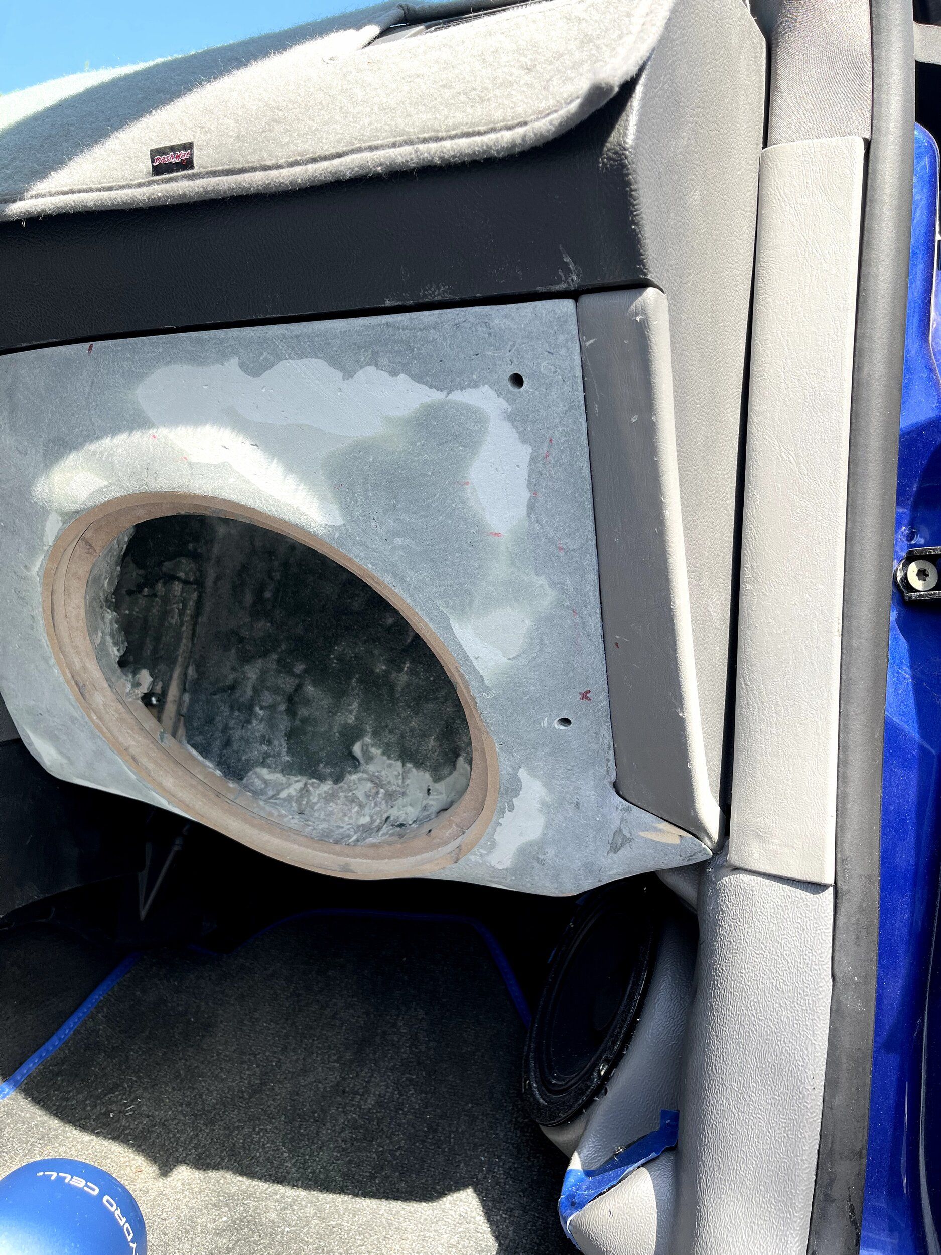

I added a same little section to face of the subwoofer so it closes up the gap where it meets the kickpanels. There was a 3" open space and it was driving me crazy.
After I added a couple layers of reinforced filler and sanded this is where were at. ..
Here is a closer shot. You can see the two holes on the right of the enclosure. These are two of the three mounting locations. I used some m6 rivnuts and sank them into the skeleton of the dash.

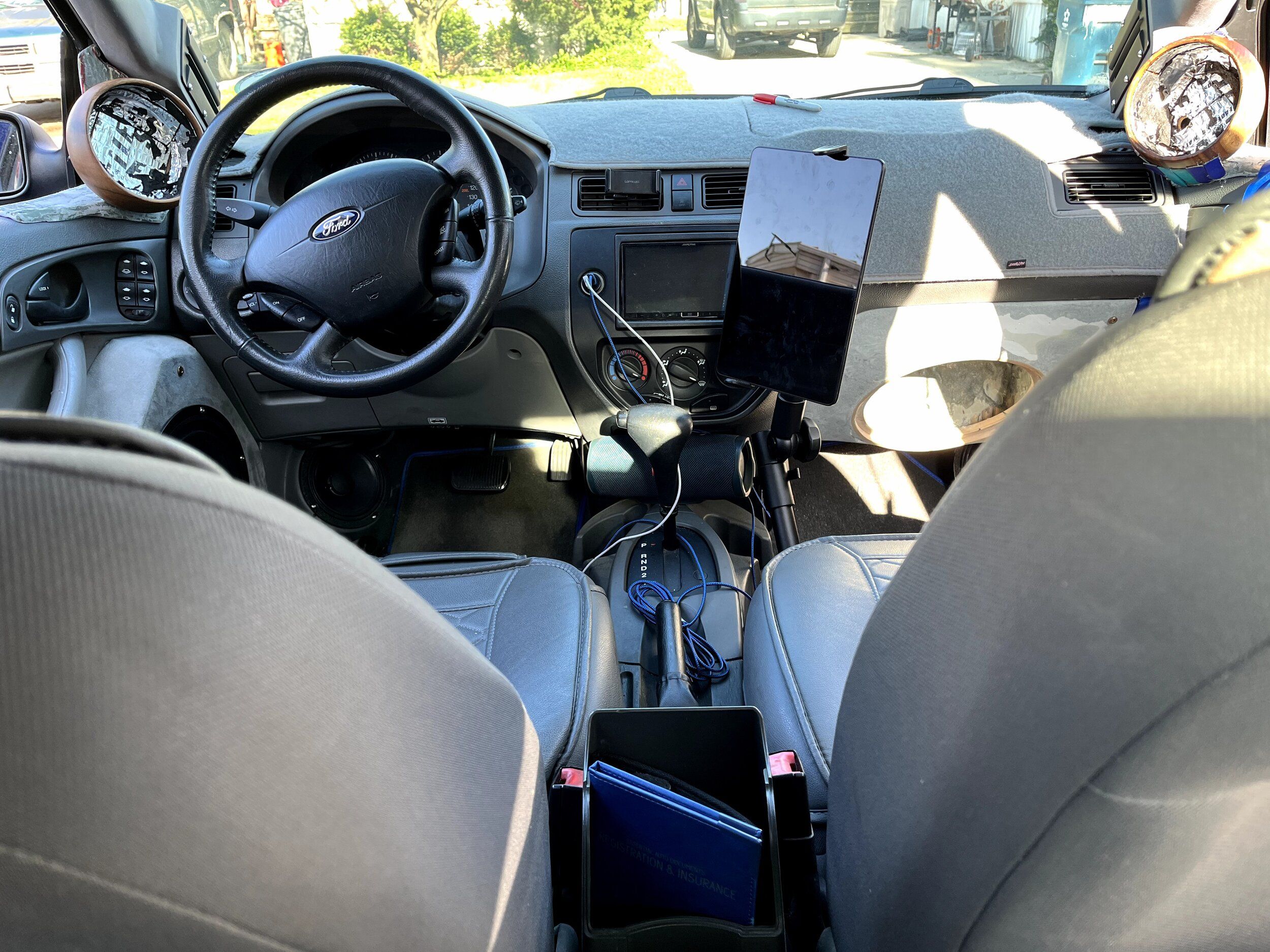

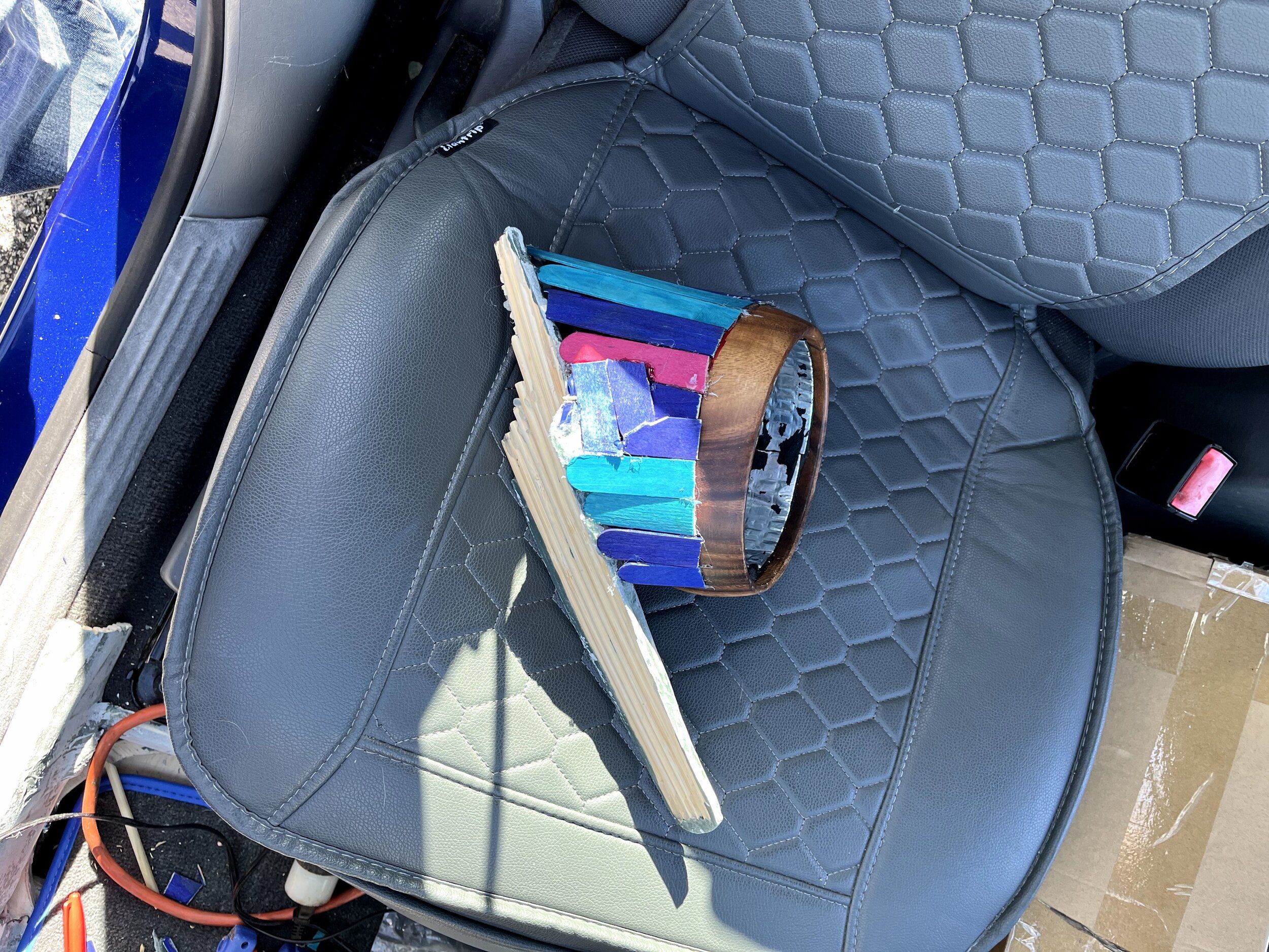

So this has been a pain in the butt as I will show you. The fabrication is the normal stuff but getting the two to line up and match is proving difficult. Still I do have some progress photos that I can share with you.
Like the previous post. This is the goal. They are meant to be cross firing with a slight upwards tilt. This pic shows the frame with the popsicle sticks already attached.
Here is a shot of the drivers side temp glued. As you can see the alignment is off. The left still needs some bodywork so they will match closer. I did this three times. lol And let me tell you; crawling into the back to take the photo everytime must have been hilarious to watch.
It might be saturday before I get to post on the build so stay tuned.

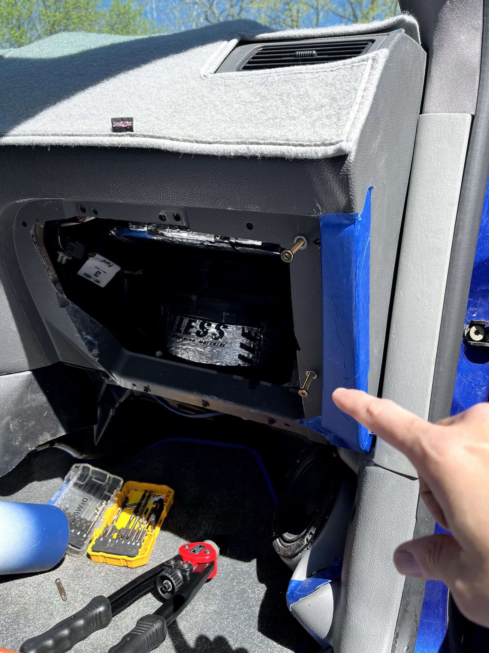

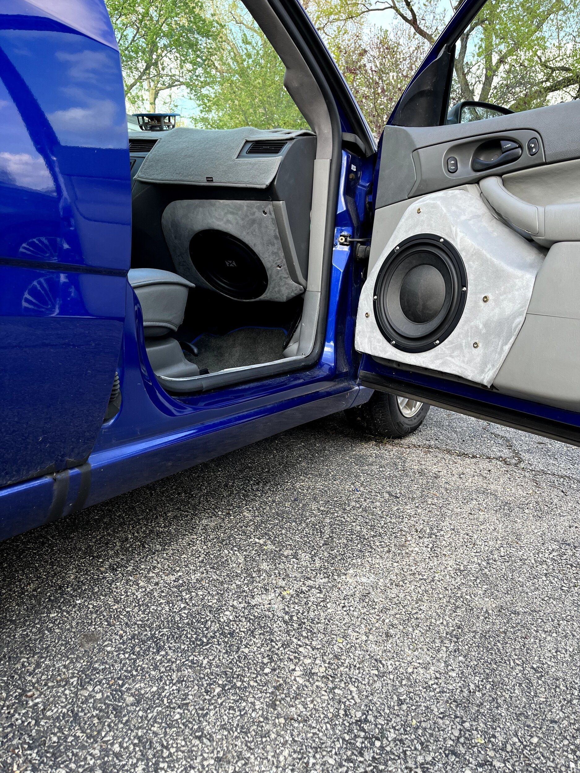

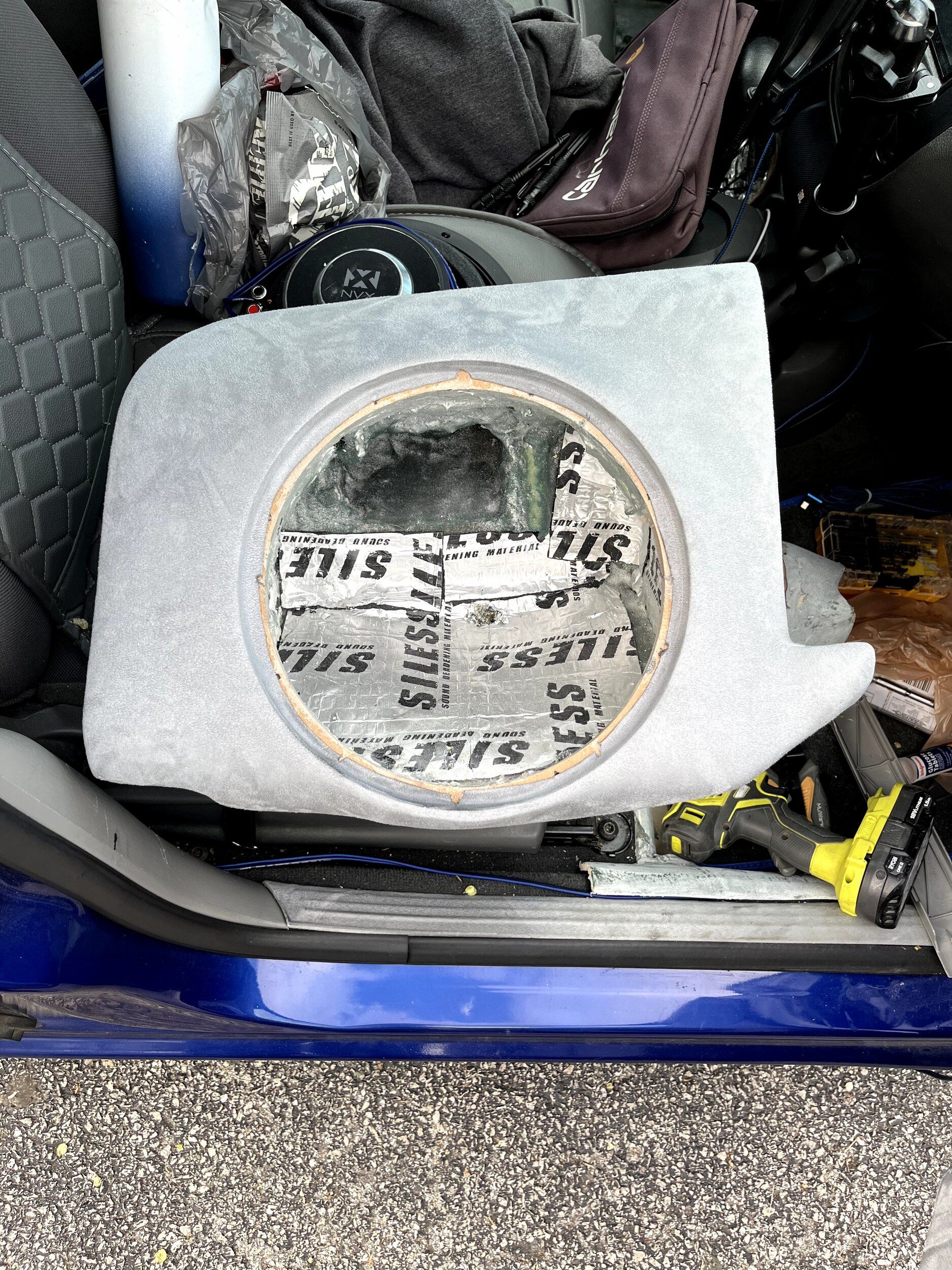

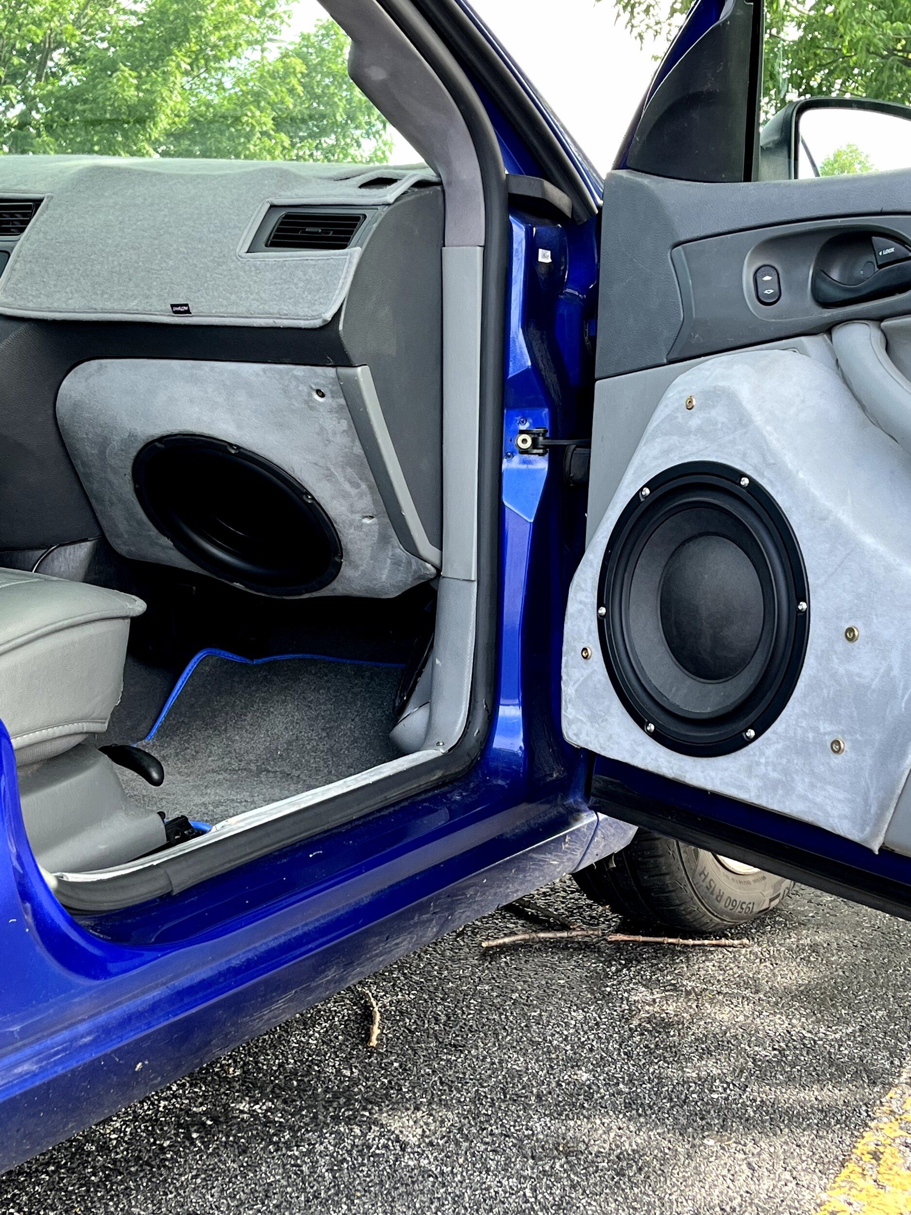

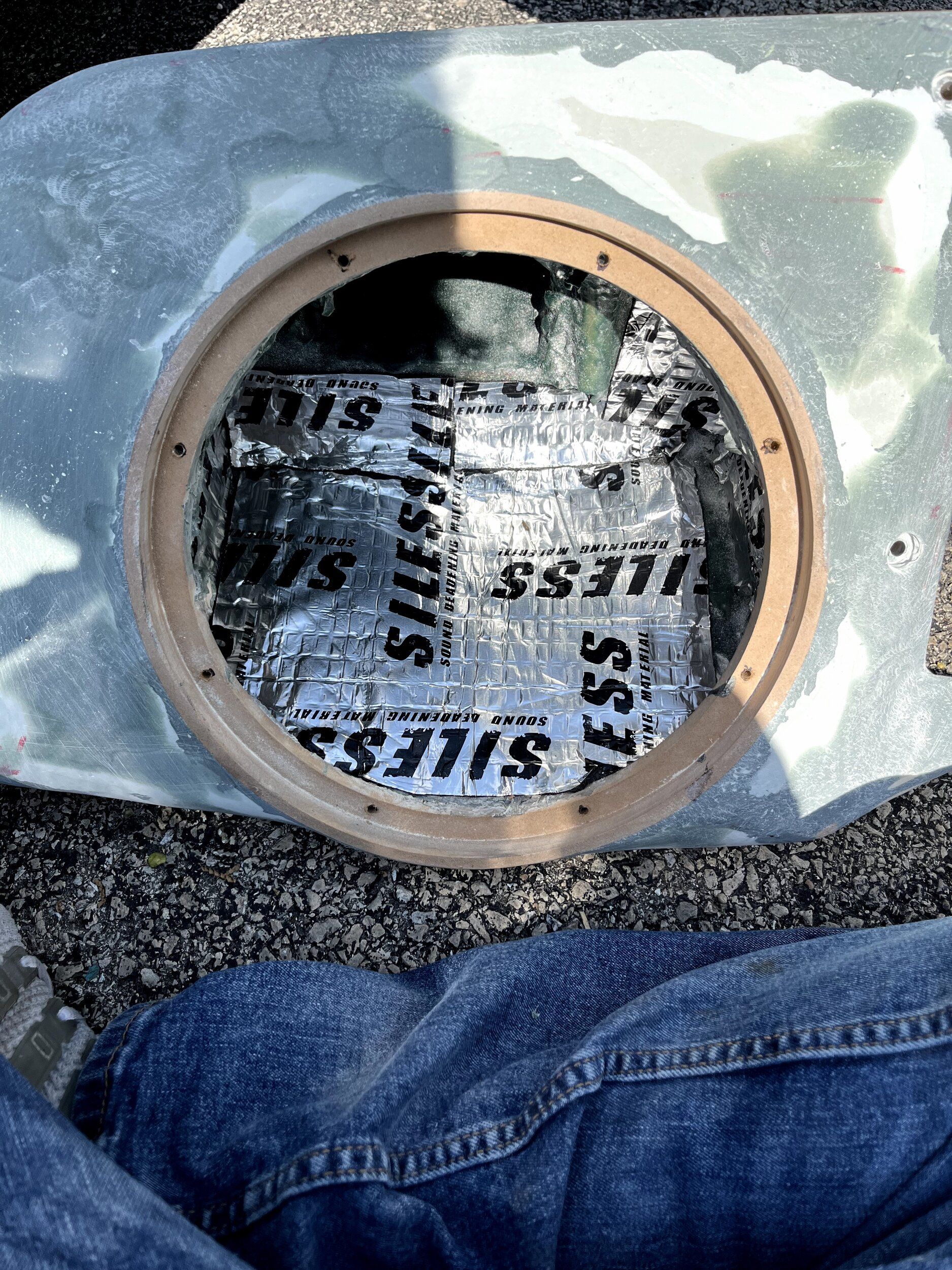

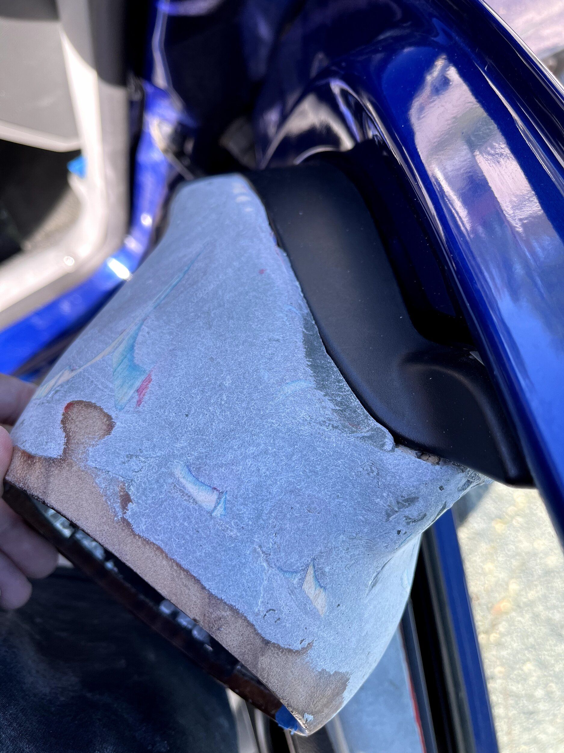

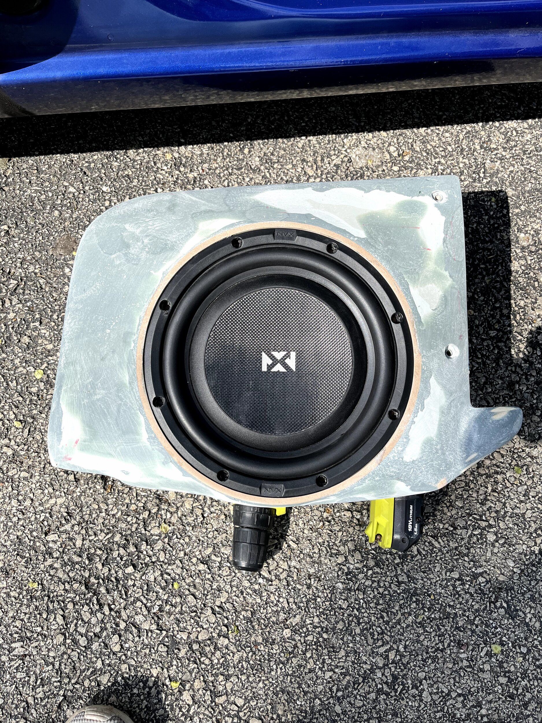

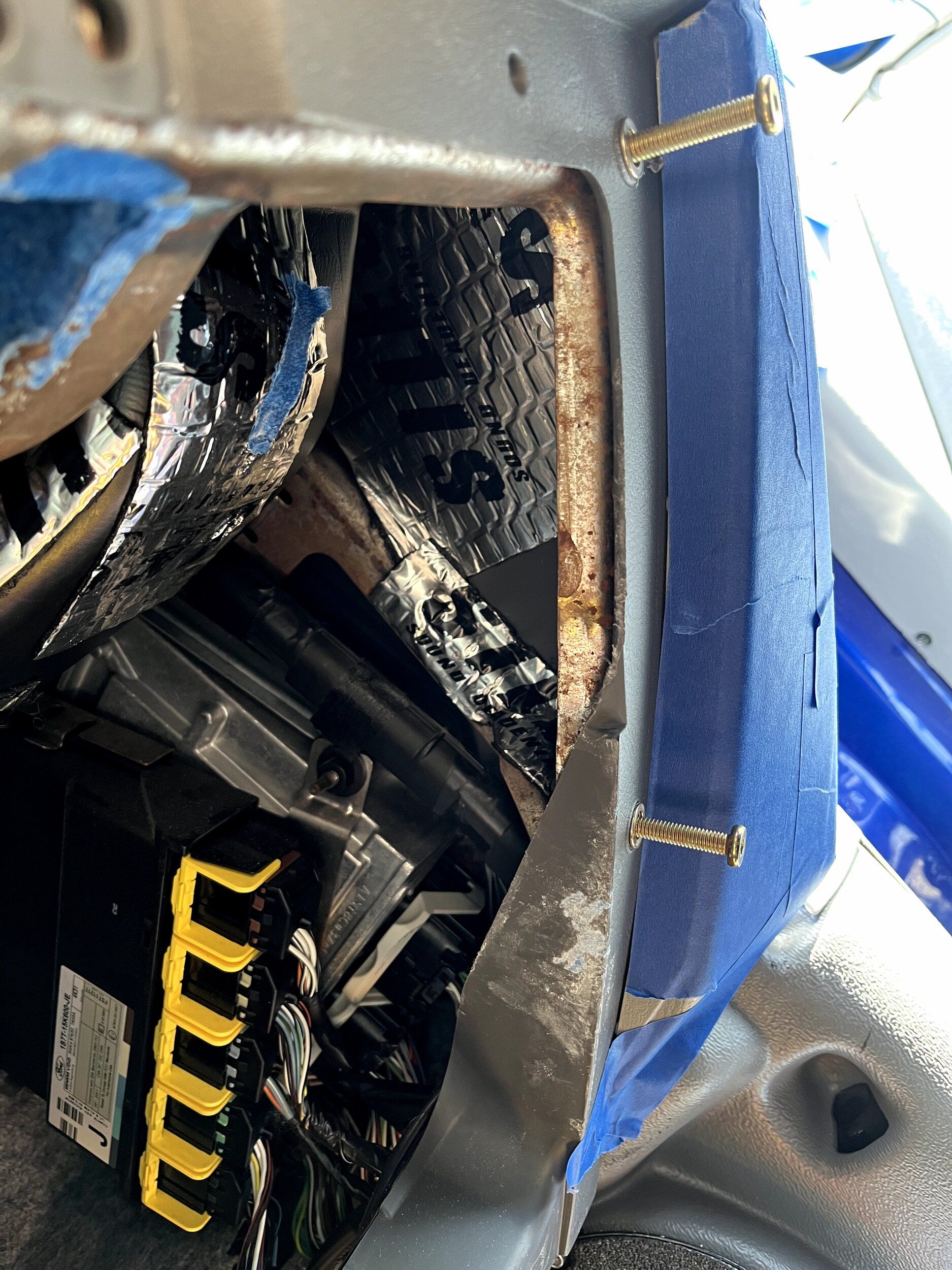

So, as you can see the glove box subwoofer is complete. It has taken, like.. so long to get done. I am more than happy with the results. Here are a few shots of the "sausage being made." Up front. I hate wrapping panels. **** gives me profound anxiety. lol
I added a layer of deadener for "just cuz" and drilled the holes for the hardware. Looking back I definitely want to put some hurricane nuts in there with some epoxy. I'd rather have a machine screw rather than a coarse thread. Especially with mdf. It's just so prissy. I'm online looking for some machine hardware as we speak. ...
Hahaha. you can see the wiring for the front sub I haven't tucked in yet. I'm awesome.

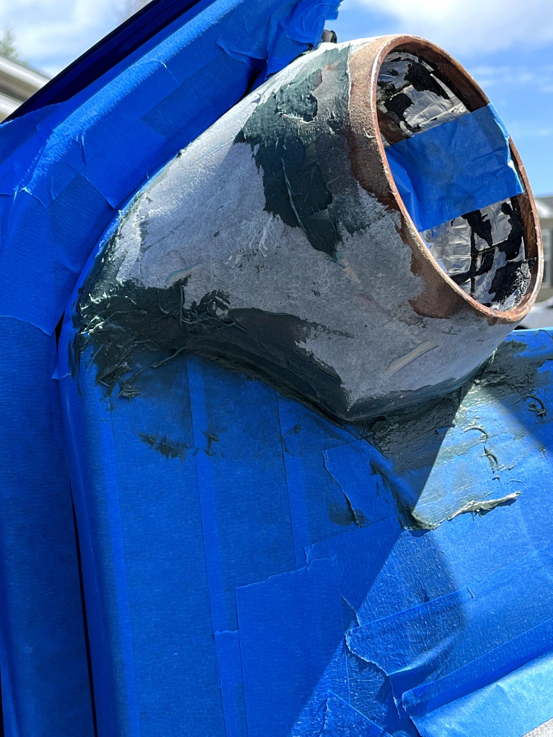

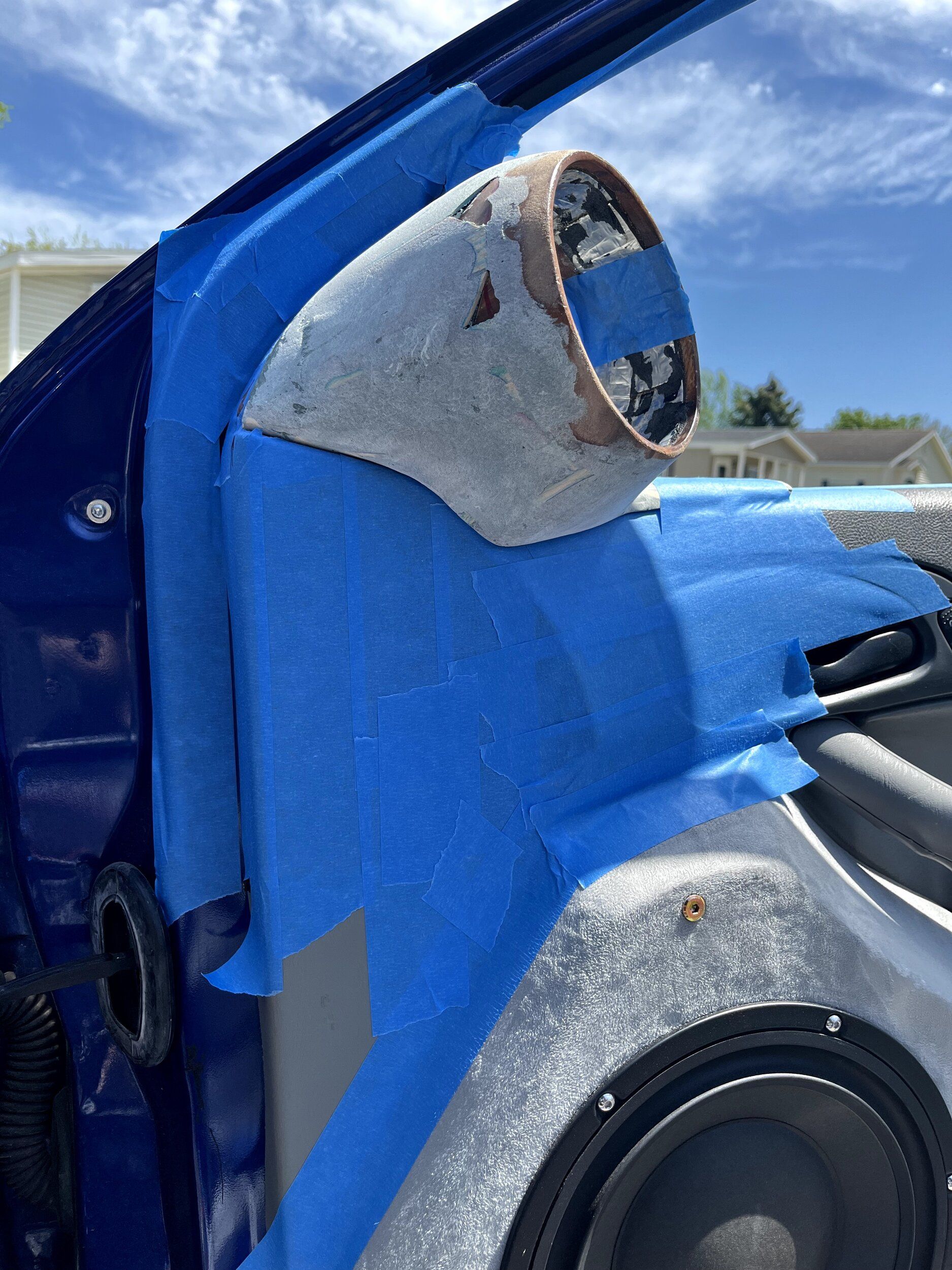

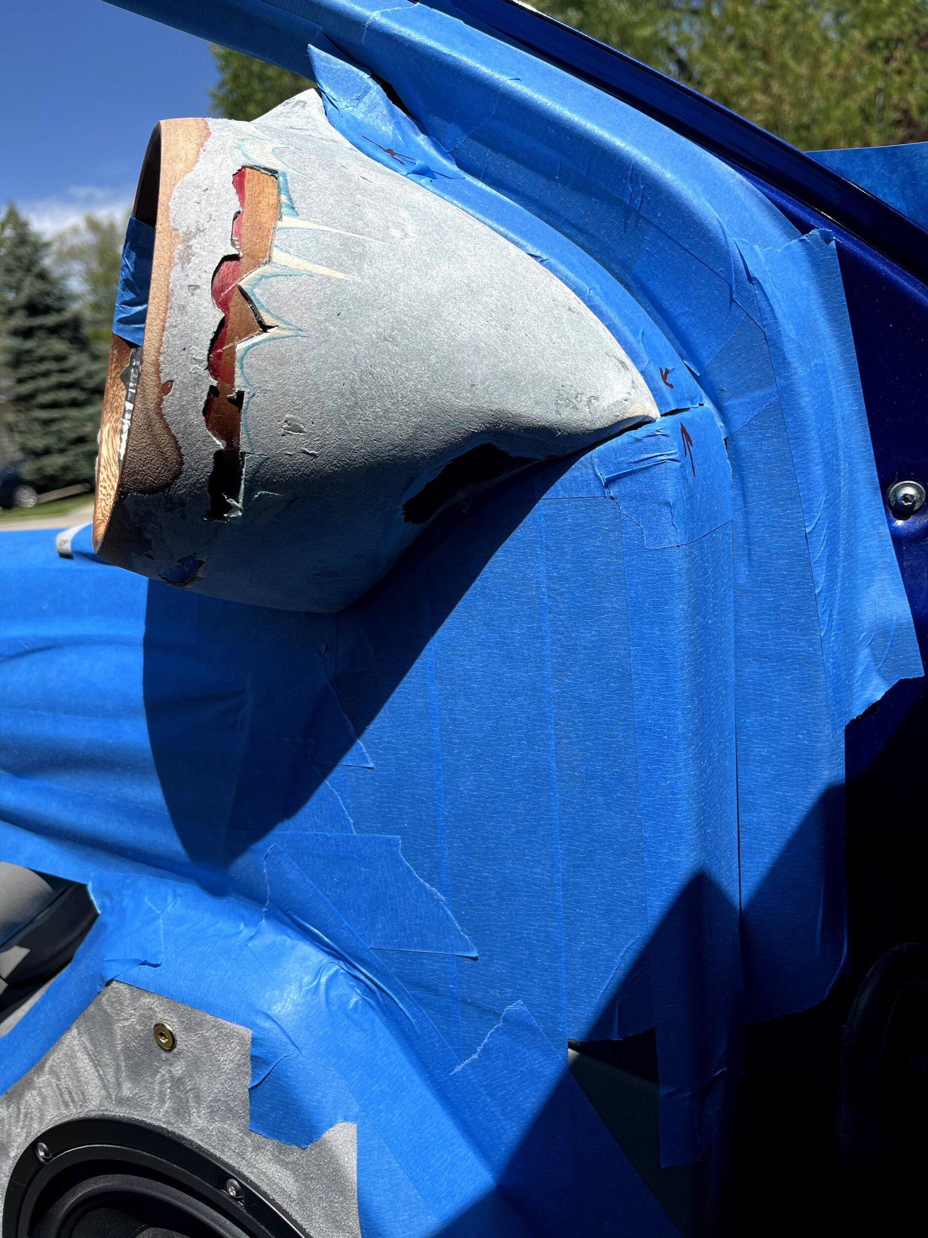

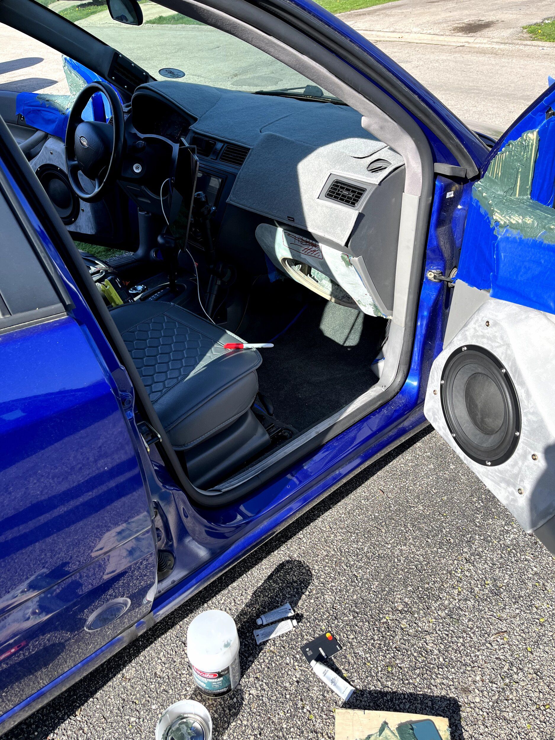

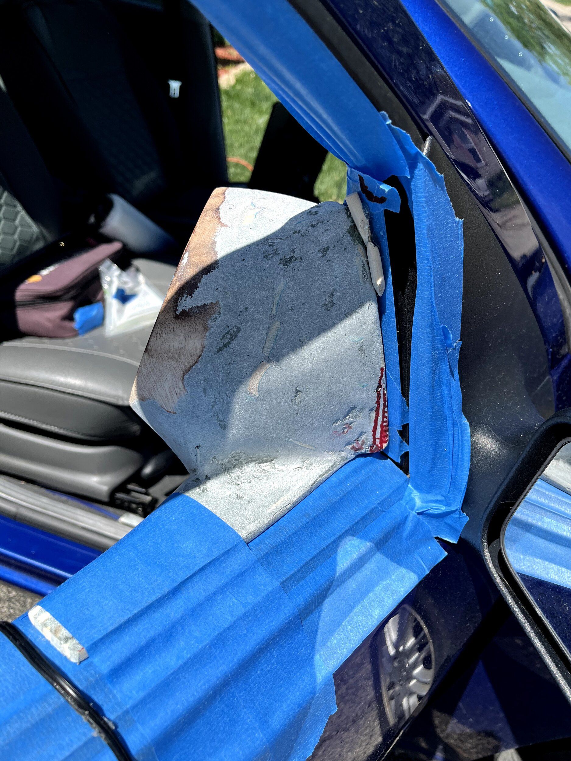

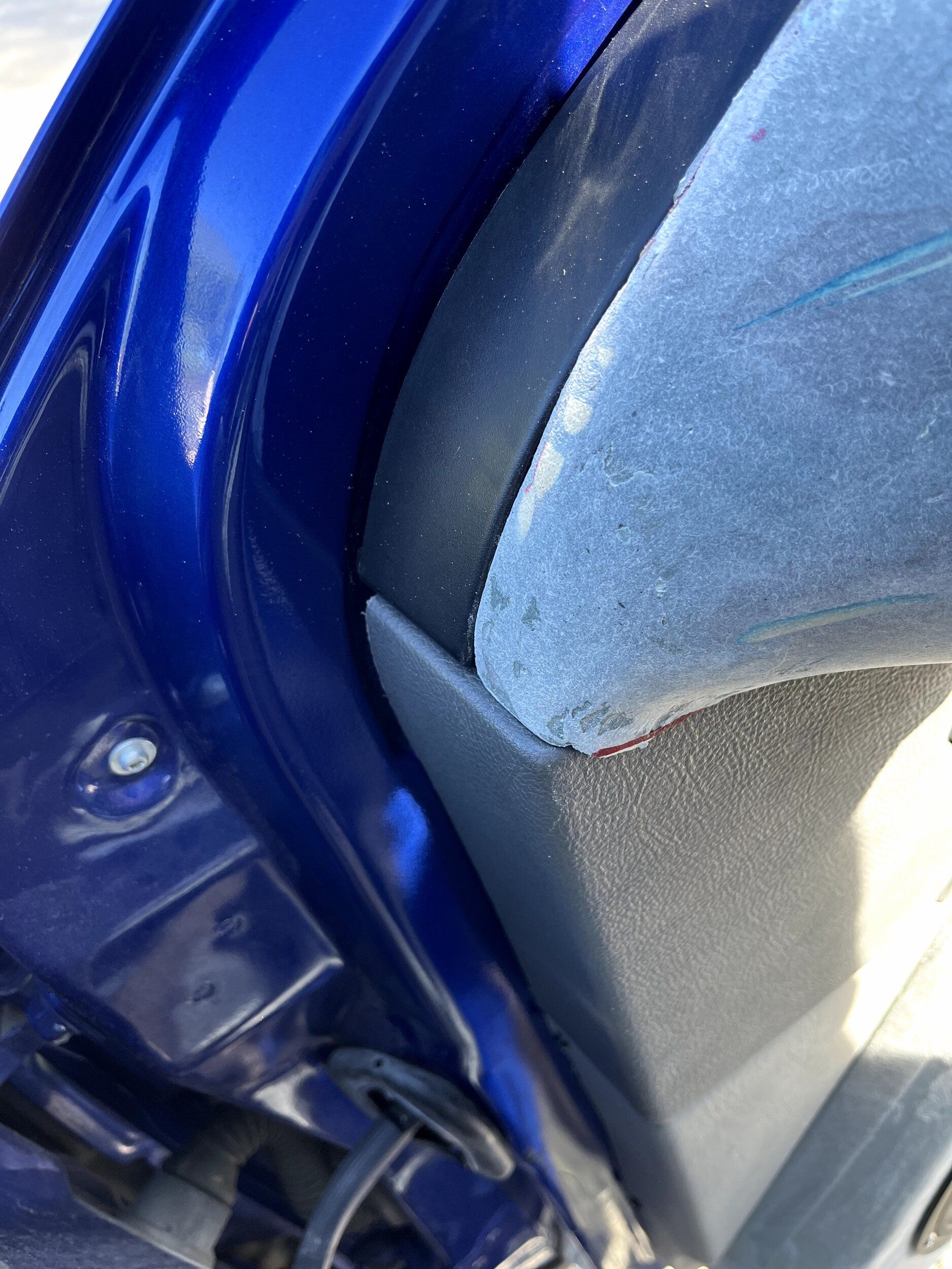

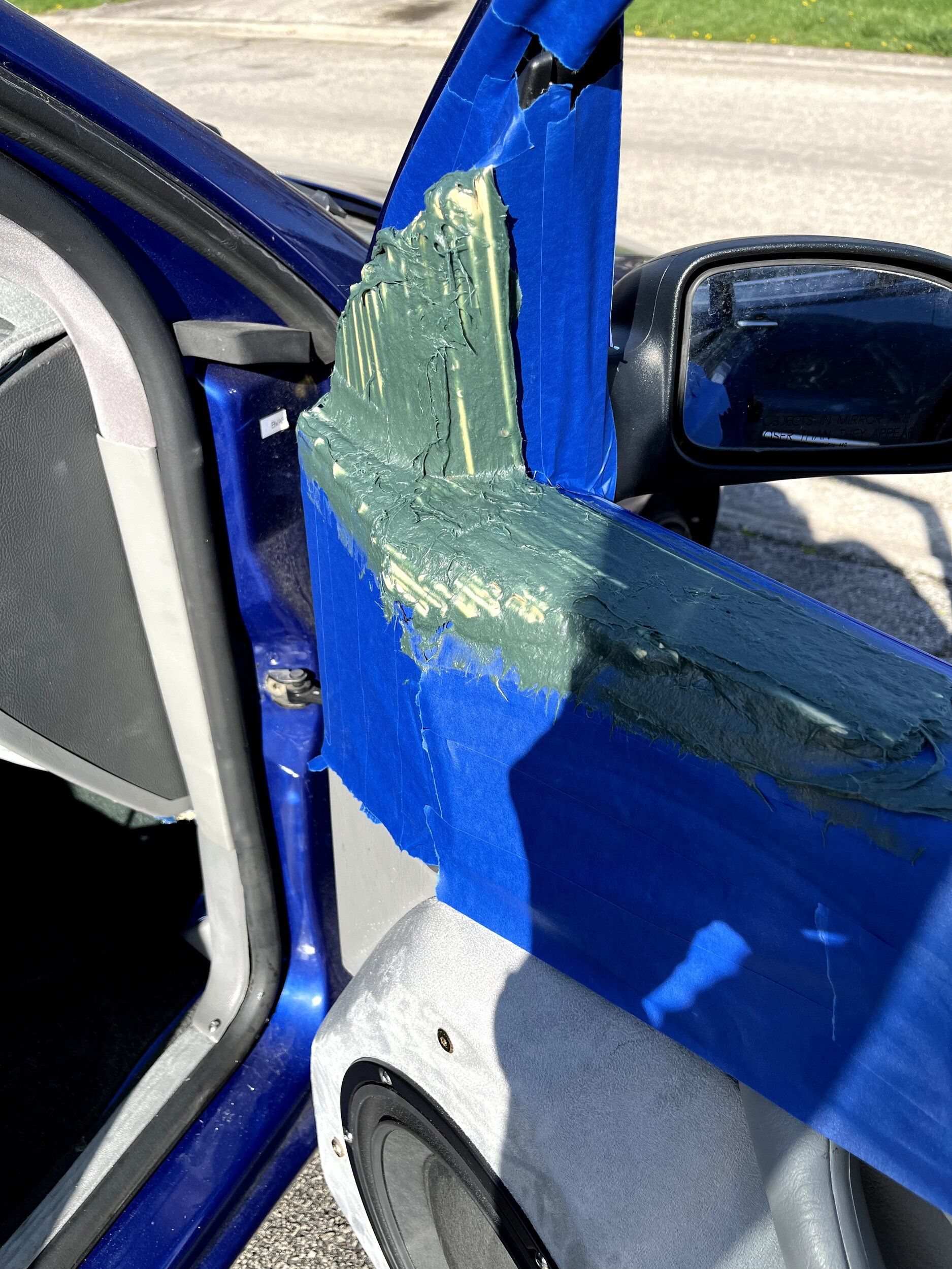

And an update on the fullrange on top of the doors. . . I've added a couple layers of kitty hair to the panels. The shape is coming out pretty nice. They are not symmetrical yet as I need to add some height to the passenger side enclosure. IMG_0671.jpgIMG_0672.jpgIMG_0674.jpgIMG_0680.jpgIMG_0681.jpgIMG_0682.jpg
My expertly placed index finger shows the area I need to fiberglass up to. I'm not really sure how long I want that "tab" to be. In my mind it looks more like a swept back wing of a fighter jet. I may take a lot of material off there. I'm not sure. We may get called off for rain tomorrow so we'll see..It may be a few days before the next update.
View attachment 58361View attachment 58360View attachment 58362

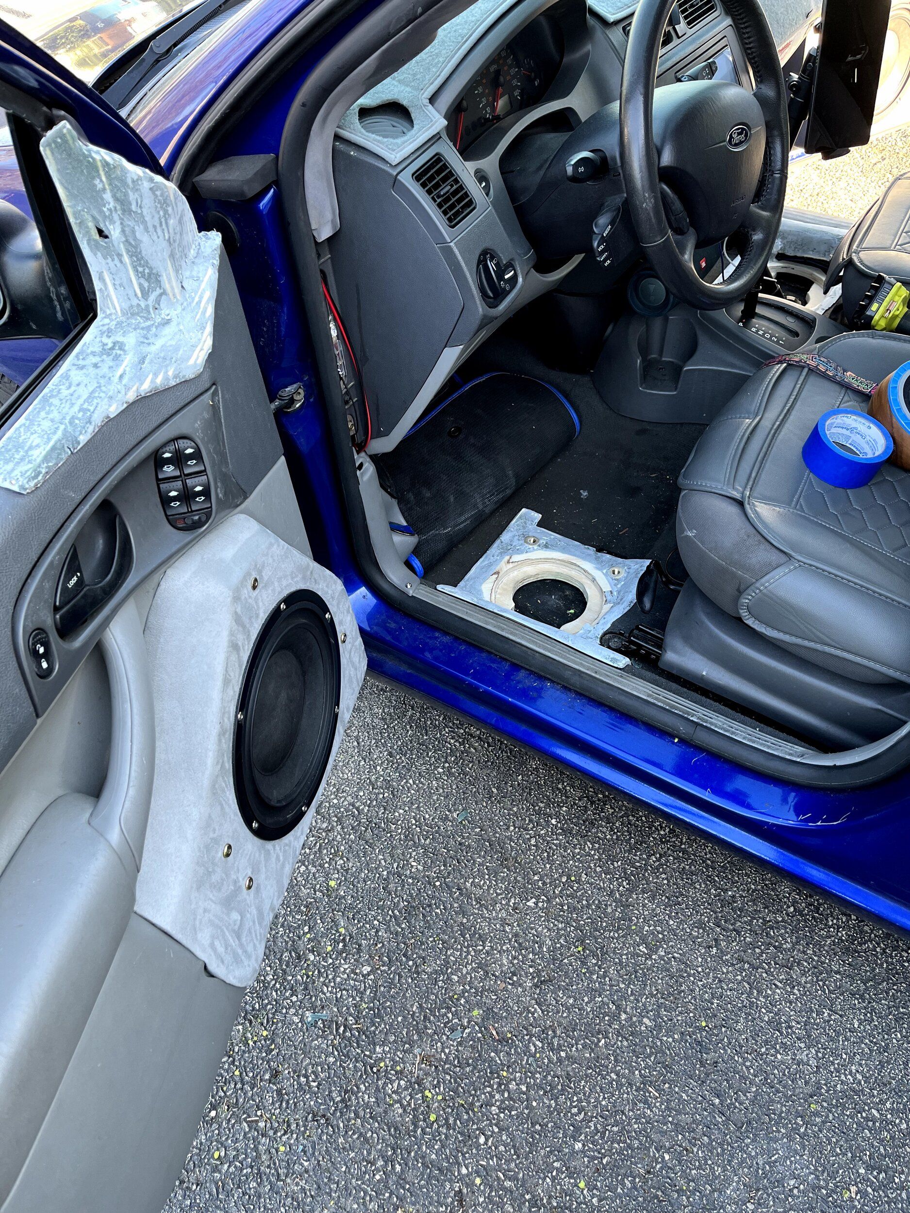

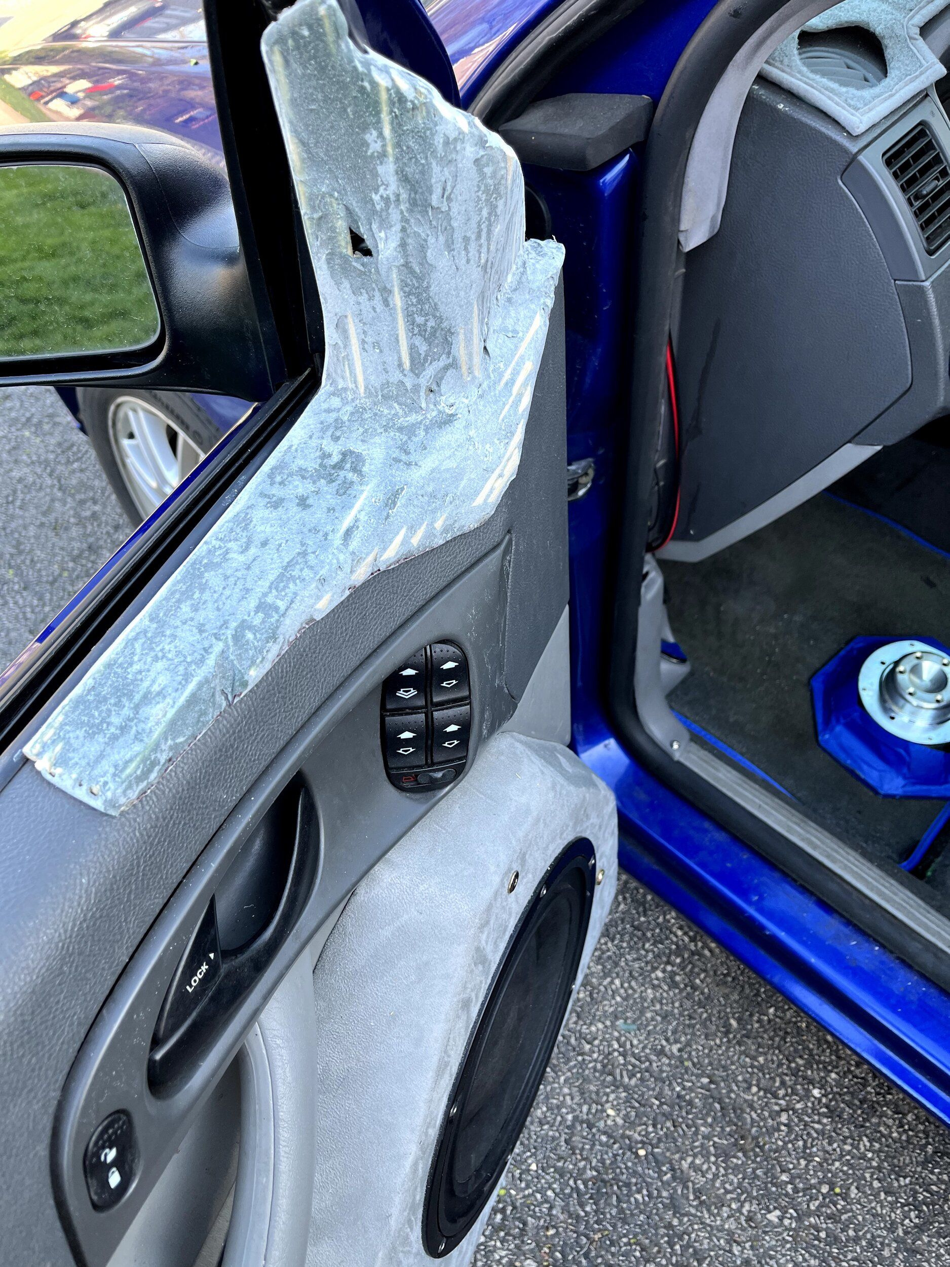

Ill add more photos as we go along but you can see I am tightening them up. Getting them to match. Another 10-ish hours they will be ready.
View attachment 58444View attachment 58445View attachment 58446View attachment 58447View attachment 58449View attachment 58448
Looks Badd azz man. You have some patience for sure. Something I need to have more of. Im deff. going to play around with some F.Glass to experience it some. Ive never done any all these years
