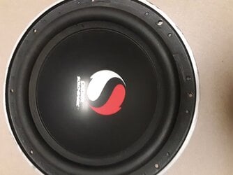

Remember when Kicker came out with the round Solobarics. I thought I was the sh!t when I had two of those 12's in my 1994 Honda Civic....lol
I got one 10 left out of six i was going to sell a couple years ago. I sold off all my square DVC2 ohm versions silver cones.

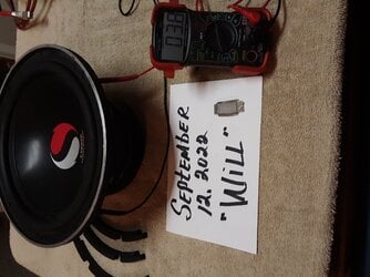

i'm assuming the loopback would just be bare wires coming out of a factory harness, then you would use the 9 wire from your amp outputs back into the loopback to the stock speakers. correct?
Nice. The challenge of finding where that damn gremlin is barricaded gets your mental gears rolling until the day you dig your hands in there.
I am gonna test each out put wire with a tweeter to make sure it is actually an output as the instructions say. Then I am gonna test the DC Voltage coming from them. I am using a tone generator to test the inputs to the speakers.
Did some further testing. Loopback harness does work. This headunit is a Smart3 headunit. Meaning, it has to see an ohm load on all four speakers in order for sound to come out. Thats why I am getting pulsing when the amp is hooked up. I looped all four speaker outputs and inputs back together on the harness and voila, sound. Disconnect one speaker and all four shut off. Luckily, I bought the 200.4 which has a 60ohm load resister built in.
