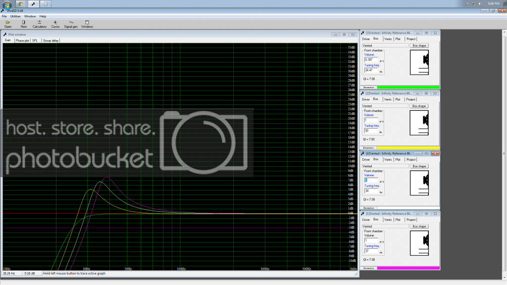

I went ahead and loaded that driver into WinISD Beta (because I like unusual alignments) and here's what it reported:
The green graph is WinISDs model, which is .387 cubes tuned to 26.47. But with a 3" vent, you're talking about ~66", lol.
The yellow white and fuchsia are 1 cube each tuned at 30, 34 & 37 respectively. As you can see, the 37Hz box looks like a burp box. The 34Hz box is almost as peaky and the 30Hz is too but, it's also -3dB at ~25Hz, which is the same -3dB point that WinISD came up with so basically, that's about as low a reach as you're gonna get with those drivers. Group delay for all of the one cube models is ~40ms but WinISD's model isn't a whole lot lower, at around 30.
Interesting, so that cube at 30hz is looking like a solid route to go. It is a tad peaky but definitely better than not being able to port it. Thanks for taking the time to run that through for me, now I have a direction to head in with this design. Bassboxpro was showing a similar group delay spike, hopefully that won't sound too sloppy. Thanks for your help sir. //content.invisioncic.com/y282845/emoticons/respekt.gif.b162d148236010609fe523122efe3729.gif
My pleasure. And look... you could get rid of that peak by making the box .387 cubes tuned to 26 Hz.
