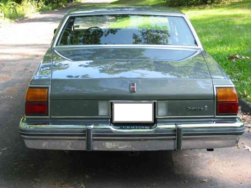

So I'm about to start buying materials for deadening my delta. My biggest concern is trunk rattle. I'm gonna do 200ml on the big panels and the entire trunk. What else can I do to dampen the trunk lid? I'll be running 2 sql-15's ib on 2k so I'm pretty sure there's gonna be some rattling when the go low 😂
