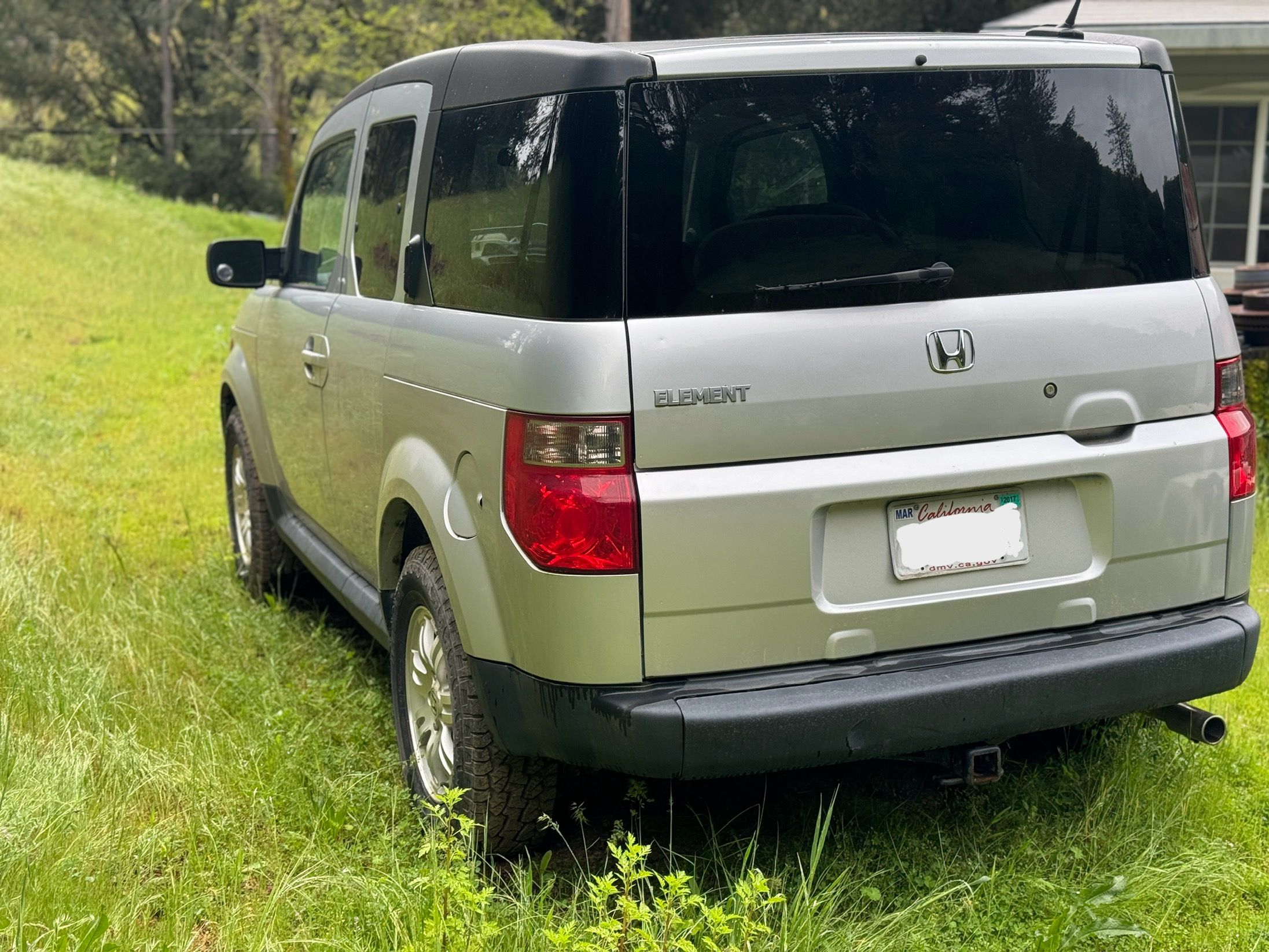

We are selling one of our new cars because our needs are changing; one of us will be driving much less. I have a 2006 Honda Element that’s been non op’d for quite some time. Looking to get it back on the road.

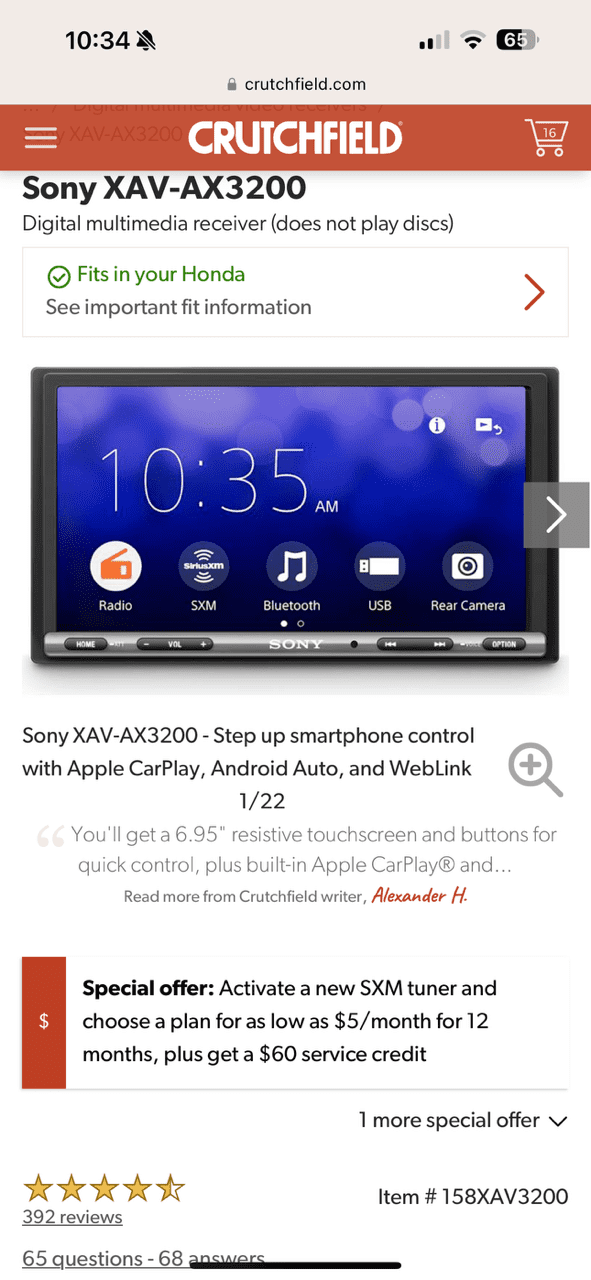

Head unit — Sony

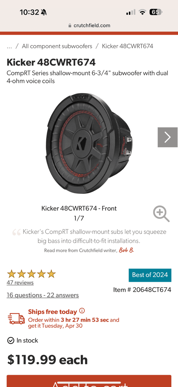

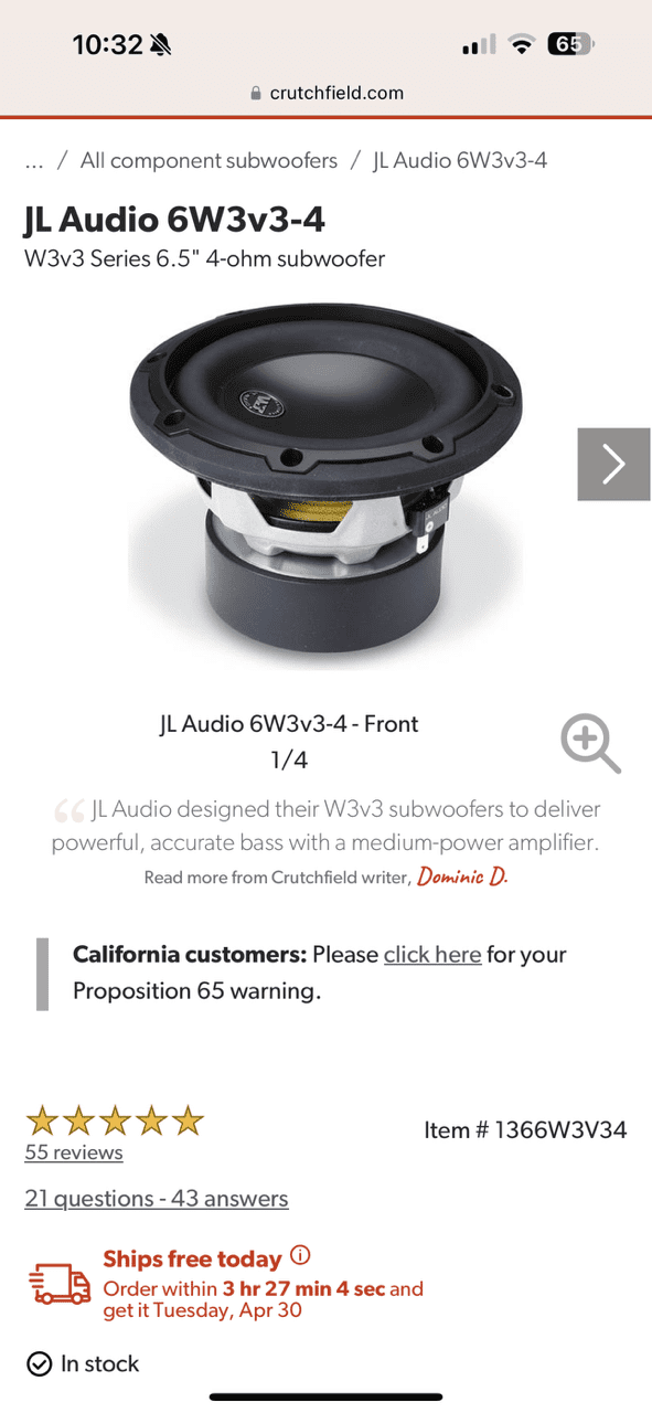

Sub — kicker or jl 6.75, heck maybe even Gately again

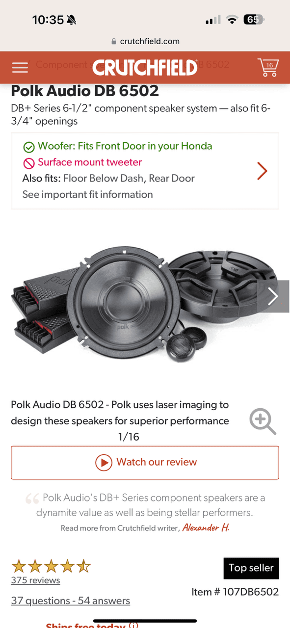

Components — looking at the Polk audios because the tweeter will fit without modifying A-pillar. Possible go with CDT if my Ram build turns out okay after tuning…

i would recommend the MM series up front and the DB Coax for the rear doors. the JL sub seems nice and will serve fine with some fill for the sub cavity. MNaybe look at a 5 ch? or a small 4 ch and a small 400+ sub amp? Get the Big 3 done for sure will help that vehicle. You will be better off buying the wiring for the big3 and doing yourself as the Alt sits low underneath,and be cheaper to do yourself. Id recommend the plastic baffles like Xscorpians for the front doors. Youll need a dremel or ? to doo some plastic cutting where the front door speakers sit to remove some space to fit the new speakers. I did a couple of these in the past and CRVs

I would look for the features needed on the HU/head Unit wanted/needed, but also look for 4v+ on the RCA output for a cleaner and better signal,and maybe Low pass high pass filtering

Looks like Stinger has a Downfire or can even be place sub rear port rear bolted down for a decent price, and has decent reviews? something to take a look at for sub stage/ looks like 30Htz on up
Just some suggestions Im throwing out there for the$ that should serve well for the money spent. An American Bass XO 10 would do really nice in that vehicle in a GP Audio Glue and screw enclosure ported @34Htz, or look at an Aero-Port Concepts Enclosure off of Ebay

My wife won’t likely want a separate sub enclosure in the rear. That’s why I was looking to sneak something in the existing front factory sub location.

I’ve always liked it. That’s why I’ve held onto it all these years. It’s a 5 speed manual AWD. The cargo space makes it super versatile. It’s getting all new suspension components and we will for sure address the electrical system. The battery is kind of small. Need to figure that situation out.
It’s been off the road since 2017, so we’re excited to get it going again.
