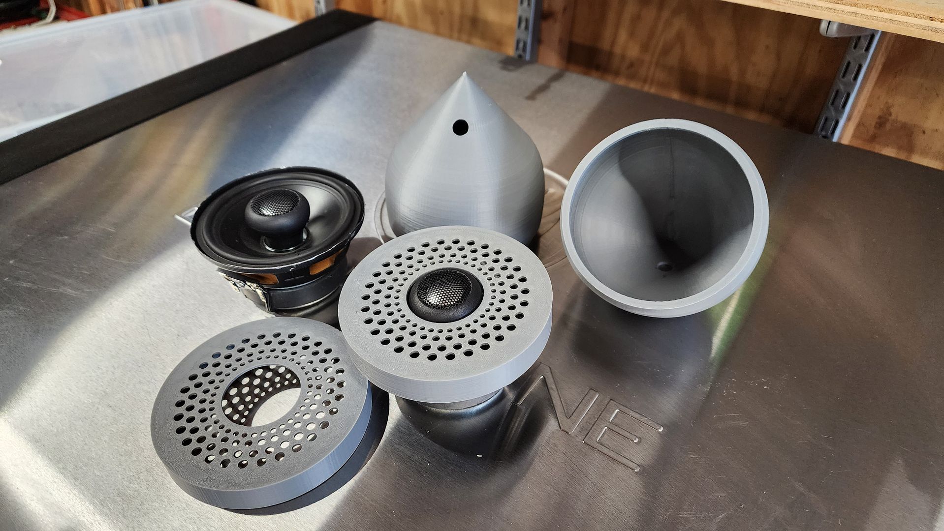

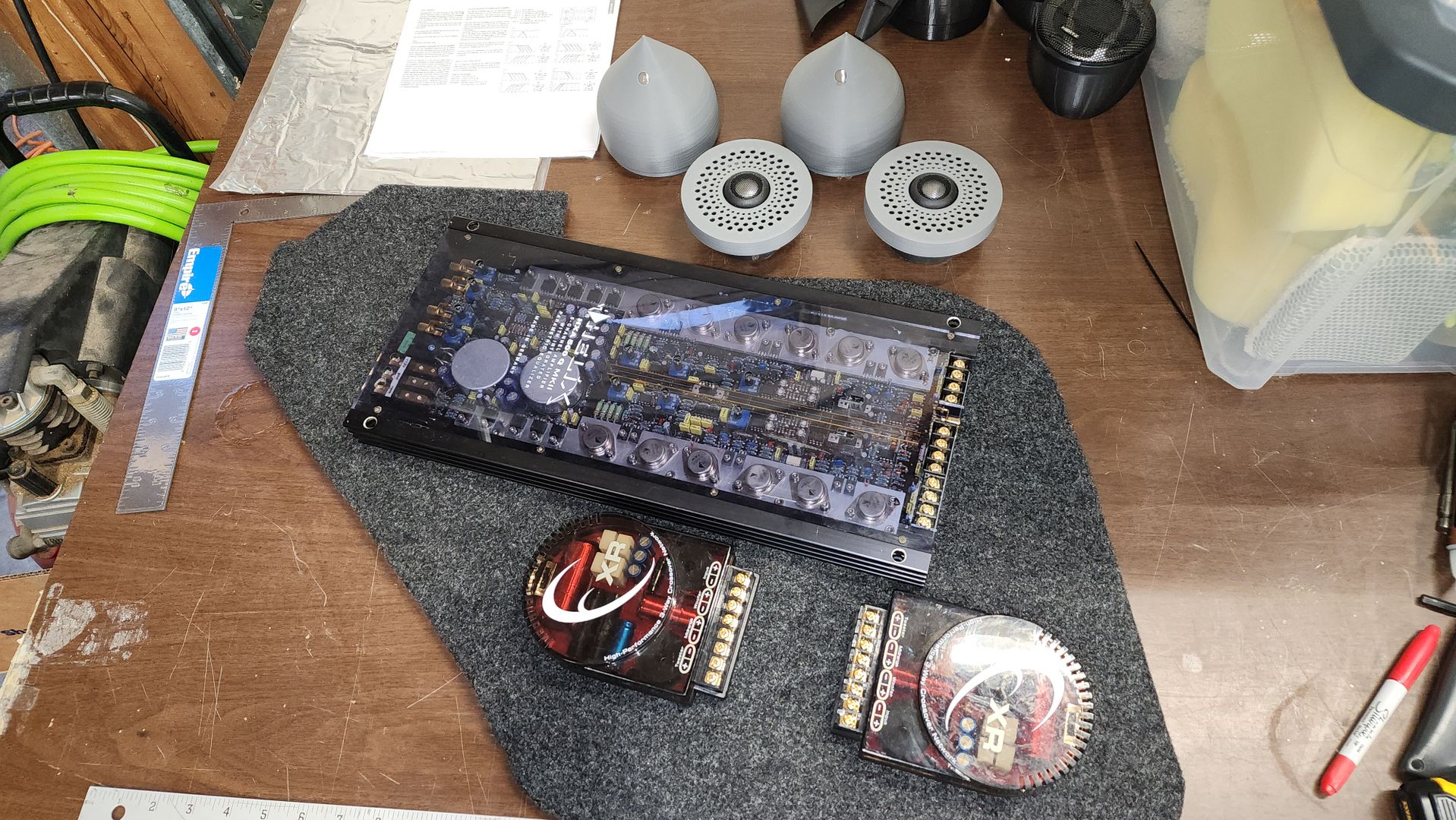

Prior to doing the Hertz HL70 mids, I experimented with some LaVoce mids (same basket, different cones). This pod also featured 3D printed grills that screw on. These mids were ok, but they had a noticeable amount of coloration when compared to the Hertz.
Been a few years. This car is still going strong. However, it has a new driver! My 16 yr old daughter is now using this as her daily at 220,000 miles. Still runs, rides, and sounds great. I swapped the speakers for some stuff I had laying around (Type R woofers, LaVoce mids, Hertz HT25 tweets) but the rest is the same. In spring, I'll start a new build on my new ride:

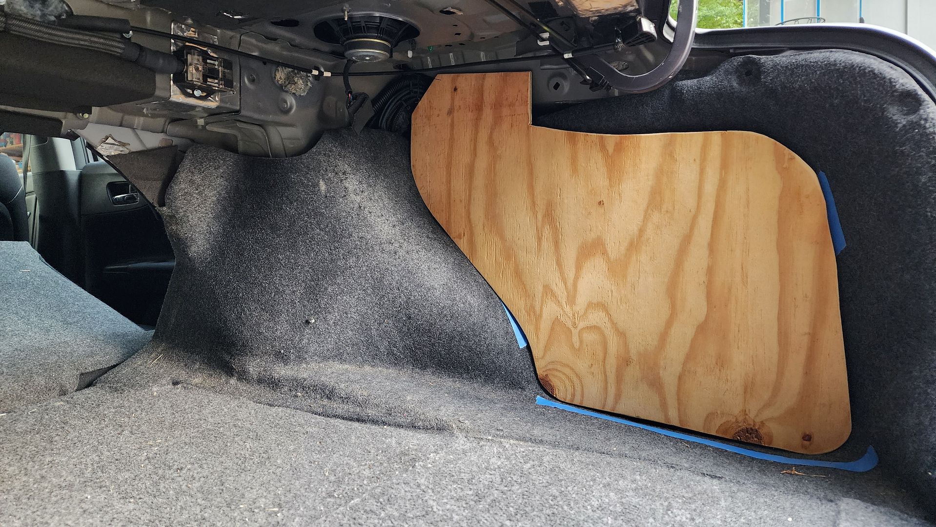

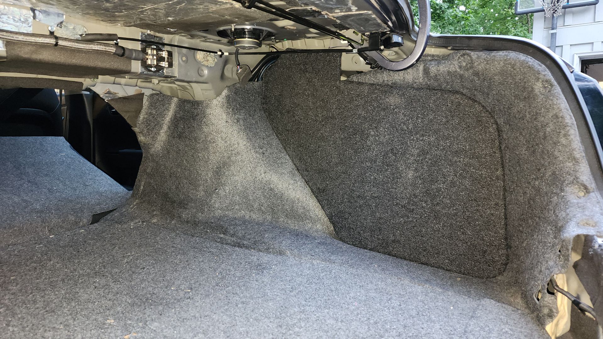

So, where are we at in August of 2023? I gutted all equipment. The wiring remains, but is being re-worked.

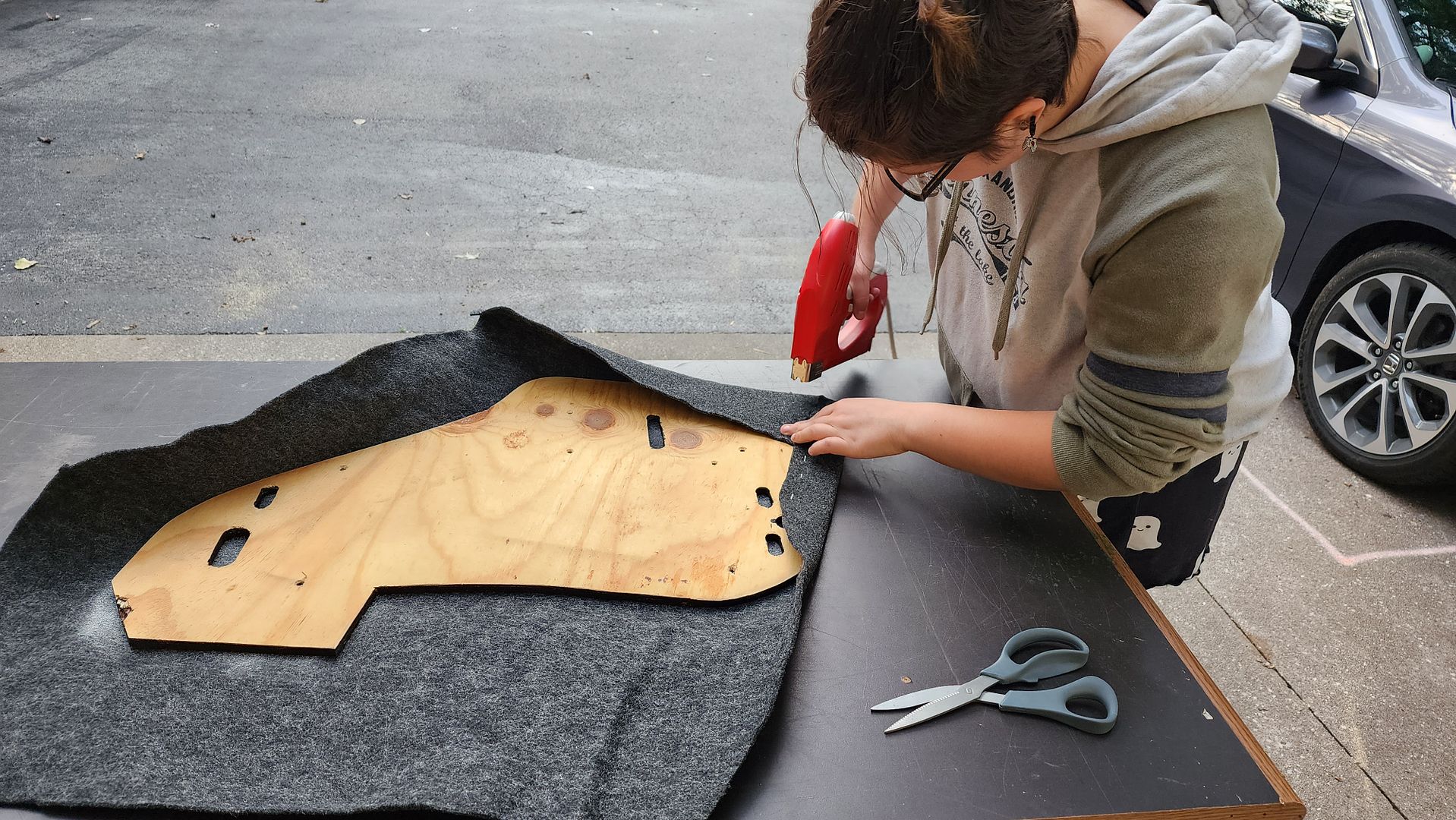

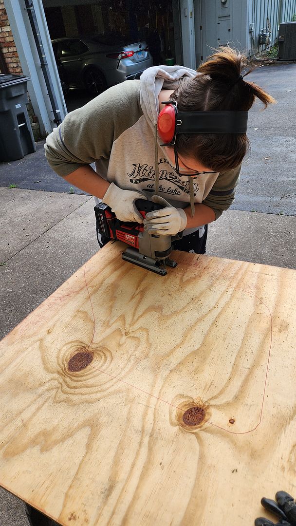

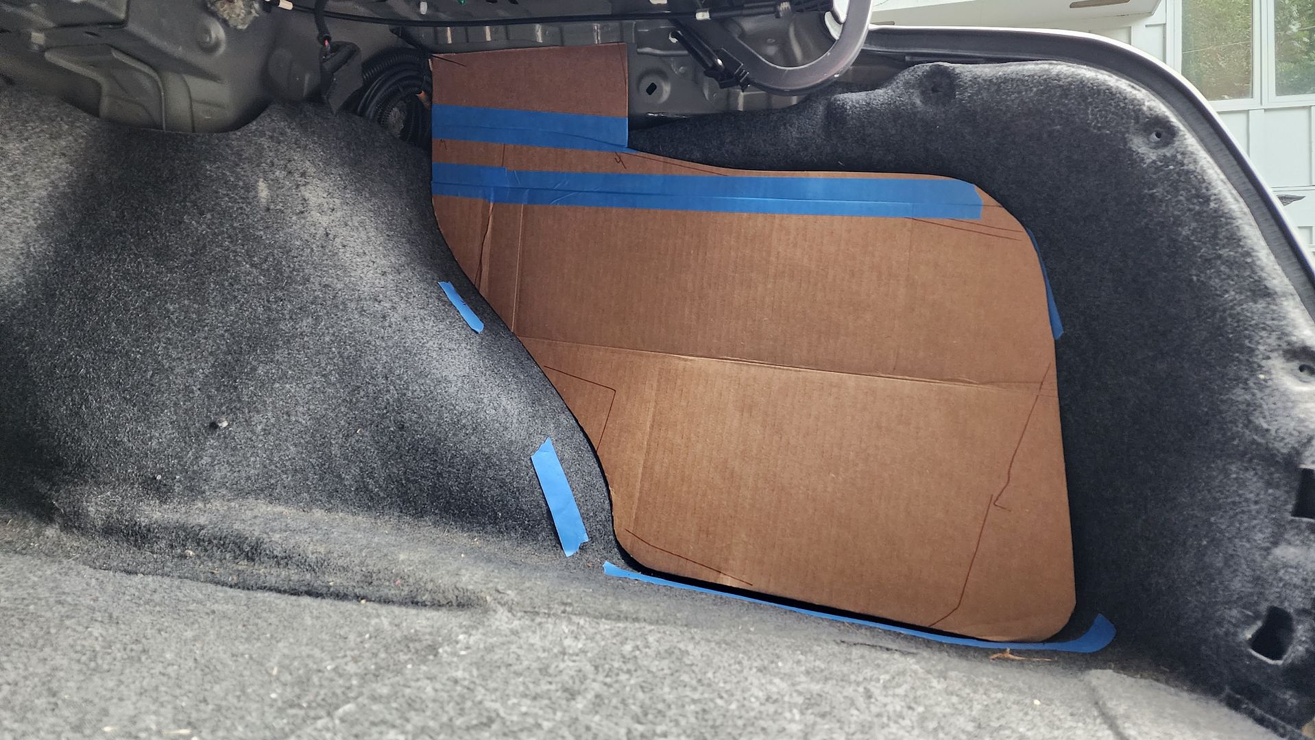

Once all of the hardware was removed, I showed my daughter how we made panels back in the day.

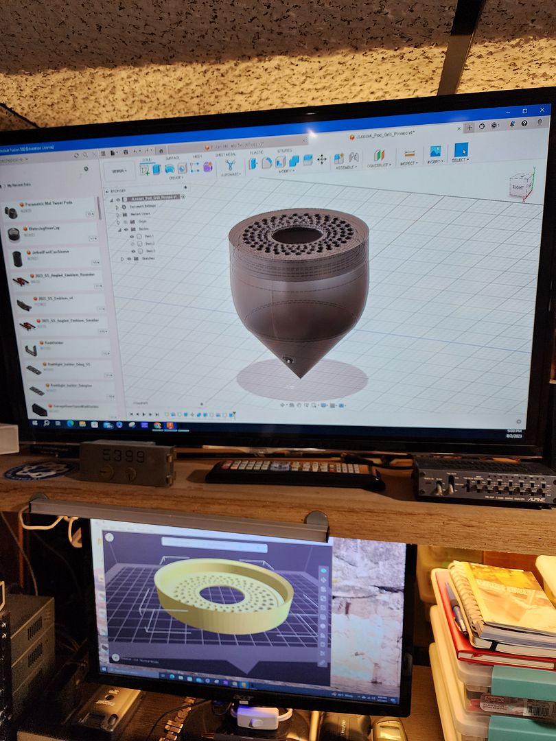

I also showed her how to design a speaker pod and we’ll give these a shot.
