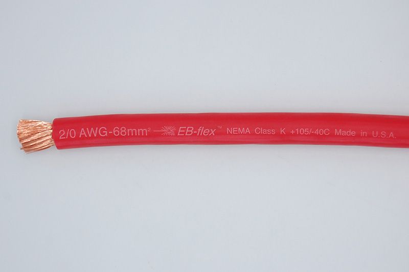

I would advise 2/0 gauge +/- front to back, parallel grounded.
Best bang for the buck 2/0 OFC wire
Black is $4.30 ft (min 25ft)
Red is $4.62 a ft 9min 25 ft)

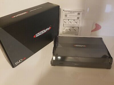

I like (and use) full bridge for subs. They are not all created equal though. Still, I ran the Hooligan 3k 9DS18 all Korean half bridge) for a while in the previous hatchback, dynamic and powerful, loads of headroom , not quite as efficient but very dynamic. I have a Soundigital 2400.1 that I'm going to use on the Mazda build starting in May. I think Soundigital make one of the better fulbridge amps on the market but they can be a bit on the expensive side for the feature set one gets.
I don't need a lot of features on any of the amps I use, full DSP so the rest just comes along for the ride. My front stage amplifiers have zero x-overs or anything else besides gains, straight signal from the DSP to the amps and out to the speakers.
