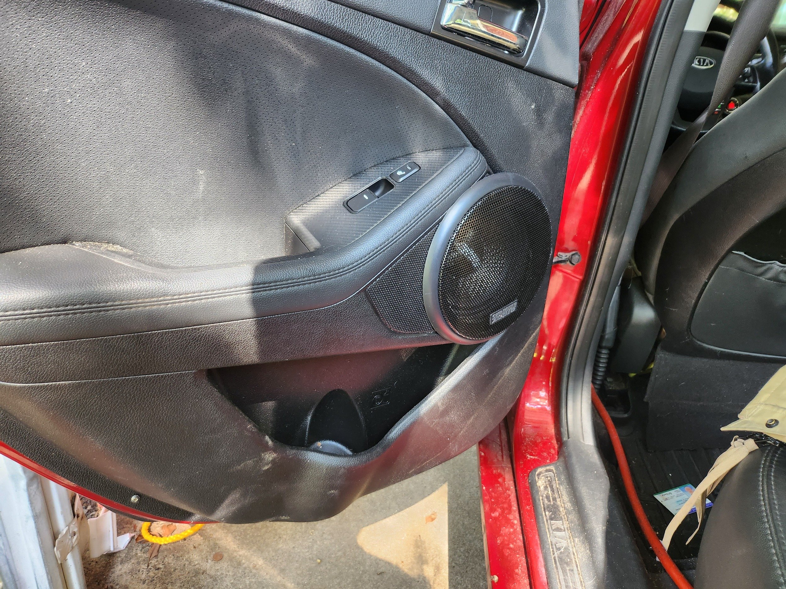

Hey bro,I have another question for, can the dash speakers get signal from factory door speakers still on factory amp, since dash speakers have separate signal, dash speakers have 4 wires

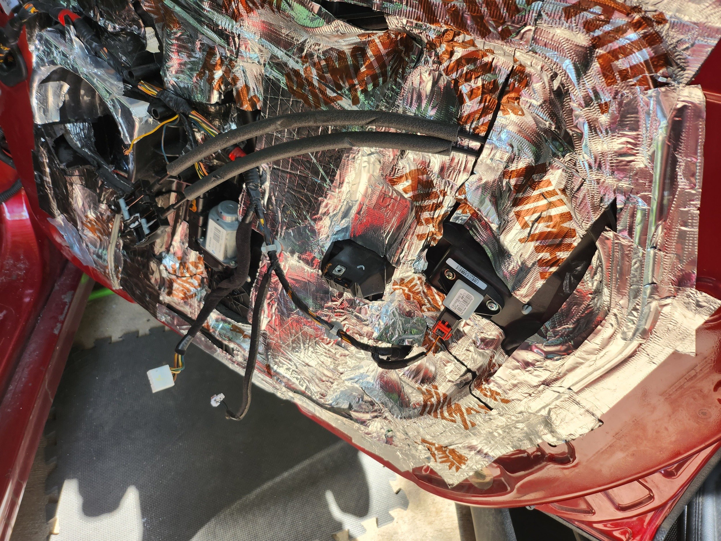

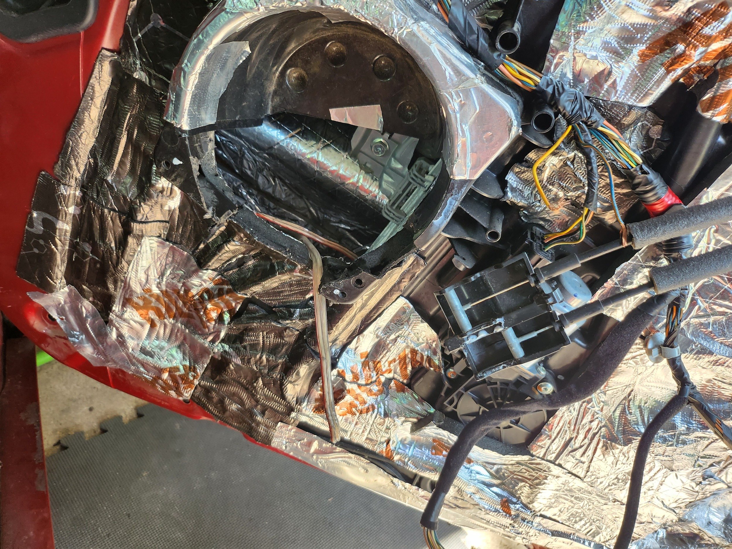

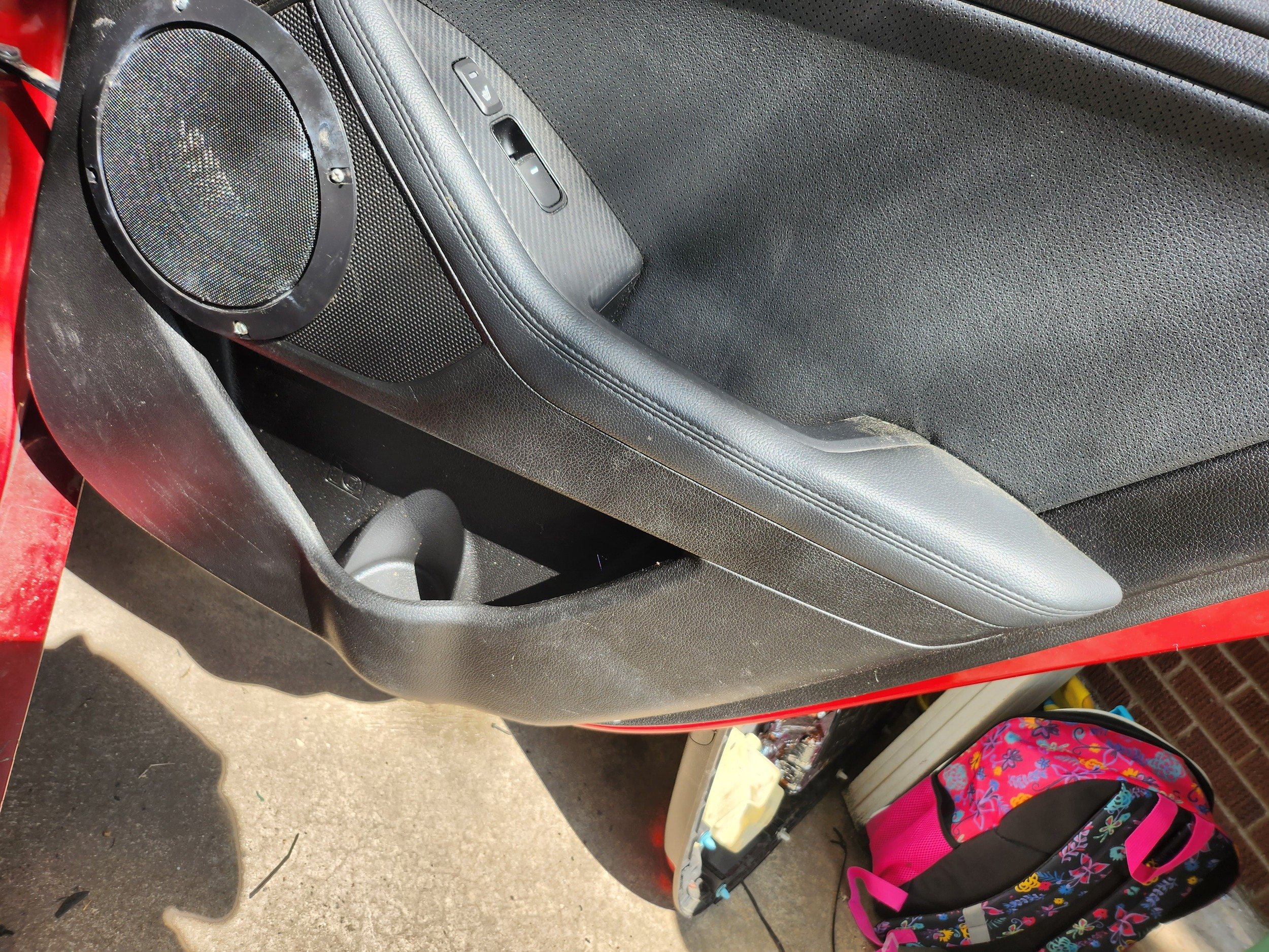

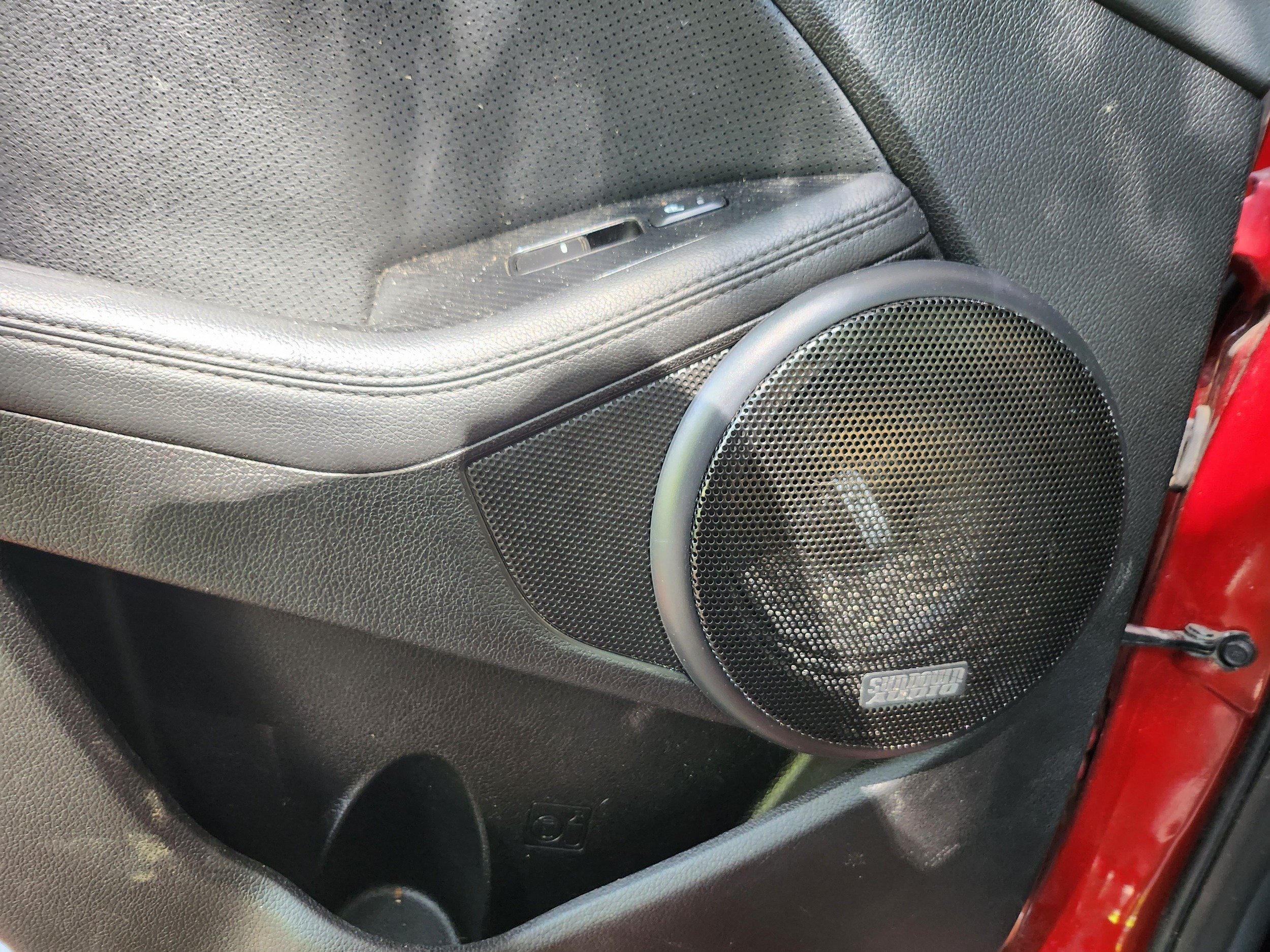

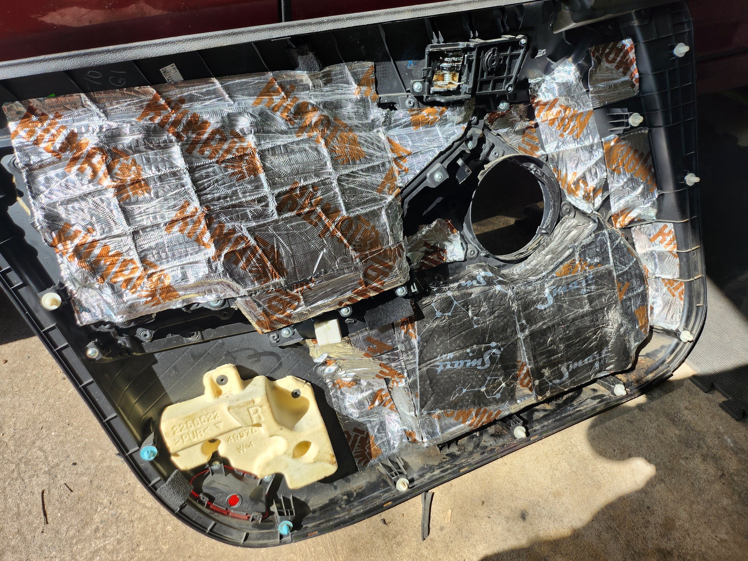

This is my build going on.
