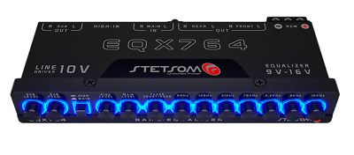

Ive opted. out for a Perimetric -EQ/Pre-amp EQ. Cost so much less than majority of DSP units, unless you get a expensive unit like an A.Control or? But for less than $100 bucks, the Clarion 755 unit. Ive been looking at the Stetsom EQX764 to try out. I run my old Kicker KQ9s in all my systems if I dont use my Clarion or others. You get 9-16v of boost cleaner signal from the majority of the units. Best of all.. Tuning ON THE FLY. Knobs are best to me while driving. Youll master it in a week! So much easier to use and tune any song IMHO. Worth every penny from my experiencing. Most do not like the looks of an EQ, but I sure enjoy the results and the accessibility it provides and a whole lot less frustration incorporated.
I have one of these but finicky if amps grounds are not done correctly/solid. But when grounds are solid and securely done properly it works very well for as cheap as it is. Maybe try this unit out to see if a Preamp EQ will meet your needs for as cheap as it is to try out? Later maybe buy a better unit?

Hell.. That CT Sounds EQ will work.
A short set of RCAs (6"-1Ft) come off REAR RCAs on back of HU to MAIN INPUT on EQ power and ground can be added to the HU and Remote, then off EQ to amps and still can split RCAs as needed for CHs., Hell ya

Ya man. Its so much easier to tune on the fly with an EQ for me rather than spending so much time going in and out of the HU or on a phone or laptop ect. Takes too much time and I get frustrated. Easy enough to reach down and turn things up ir down and fine tune. It also adds a little more clarity and is a bit louder with one added
