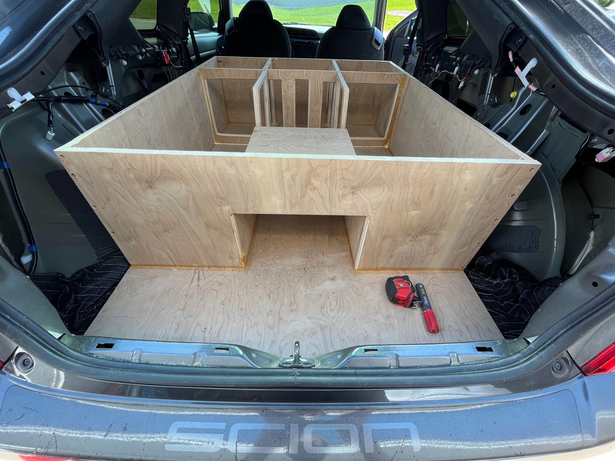

Box being built. Been like 5 years since I built a box..... 14.32 cubes gross. 11.74 cubes net. 8.86" of port per cube tuned to 28hz. Was told to go small on port area with these cheap subs.

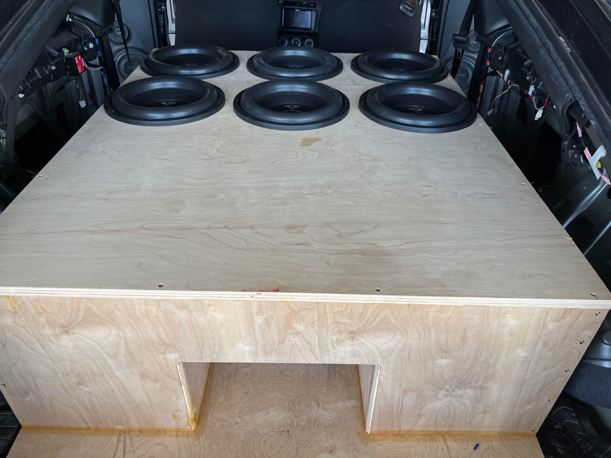

Busted my ass in this 90* weather and got it playing. Gain is all the way down on the amp and it's pretty impressive so far.
Single baffle but I have alot of window bracing inside.
