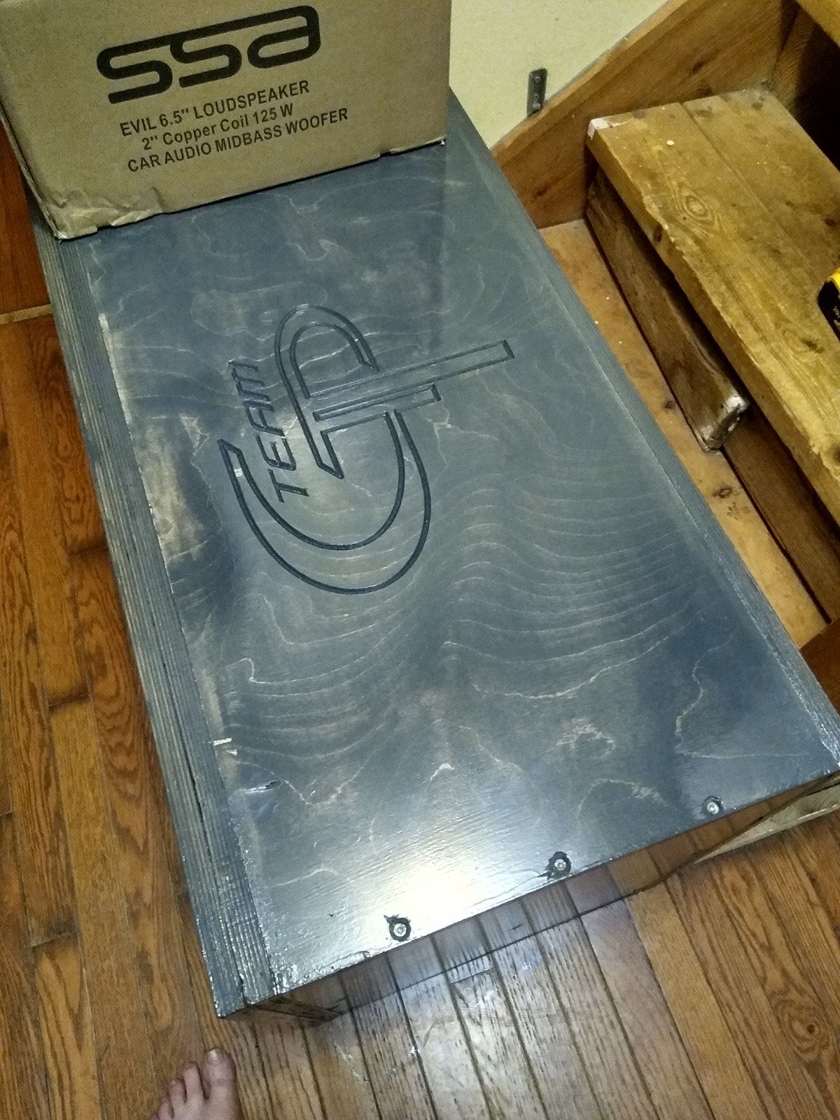

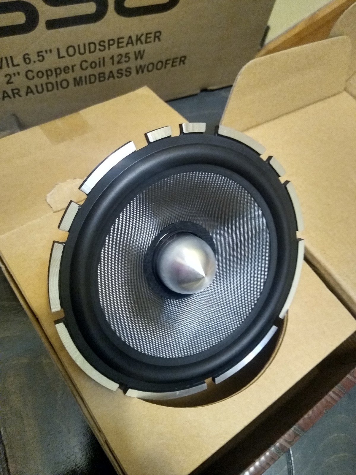

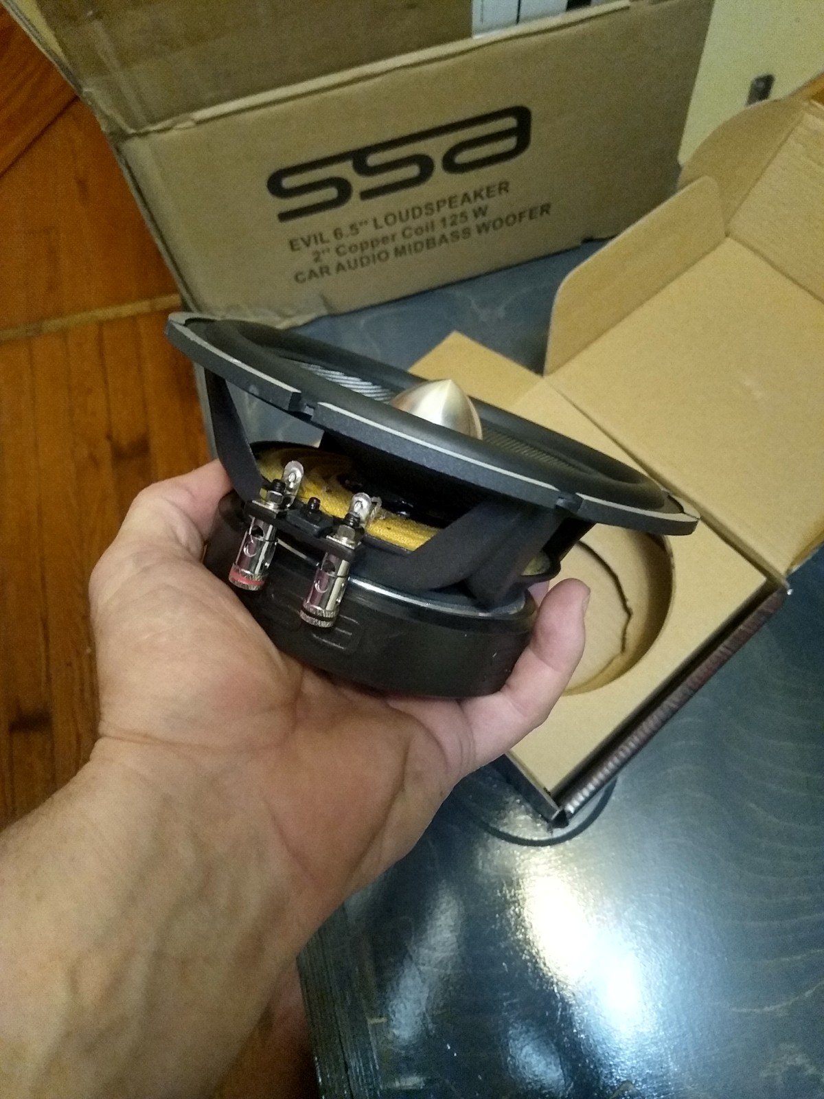

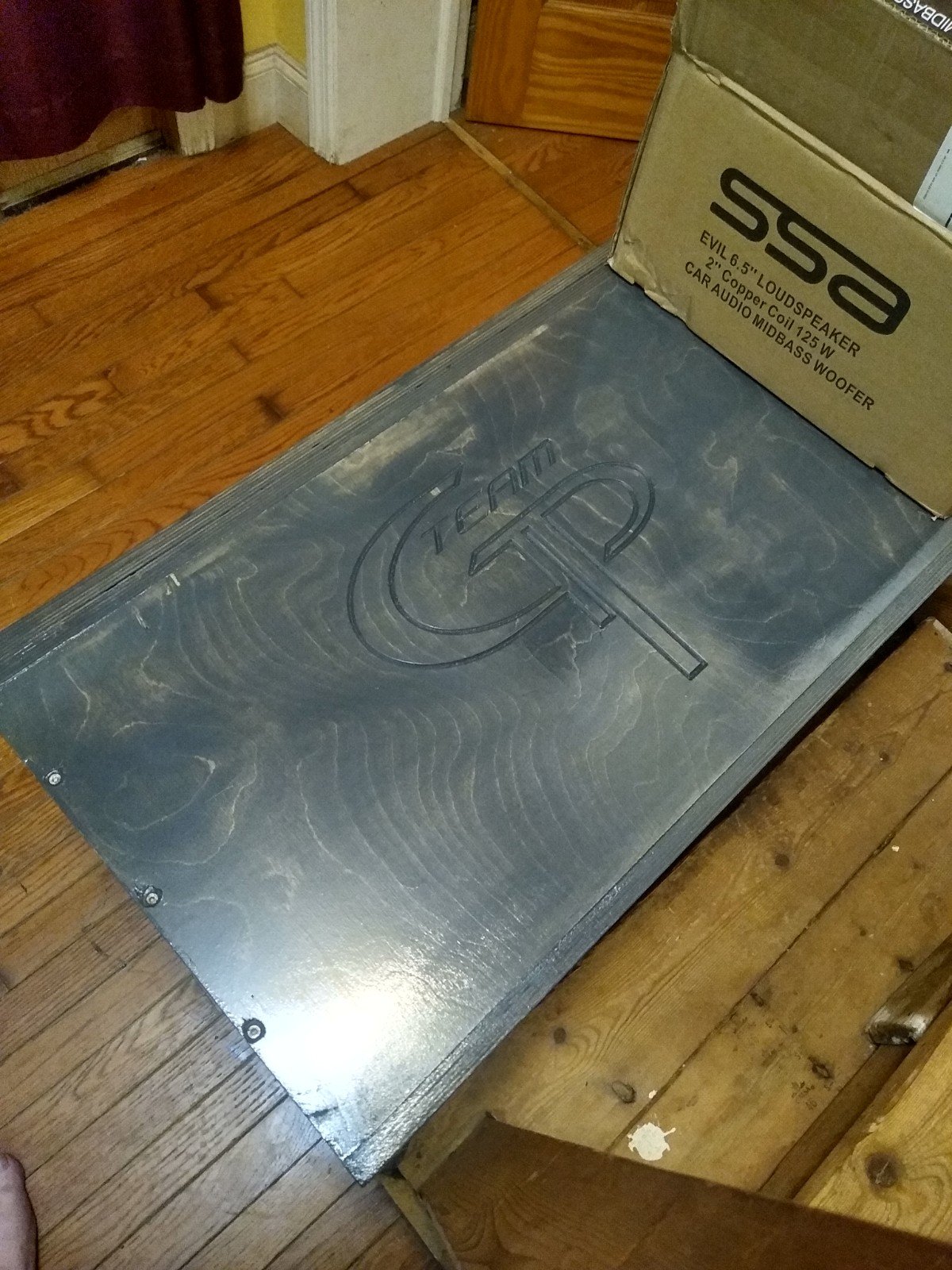

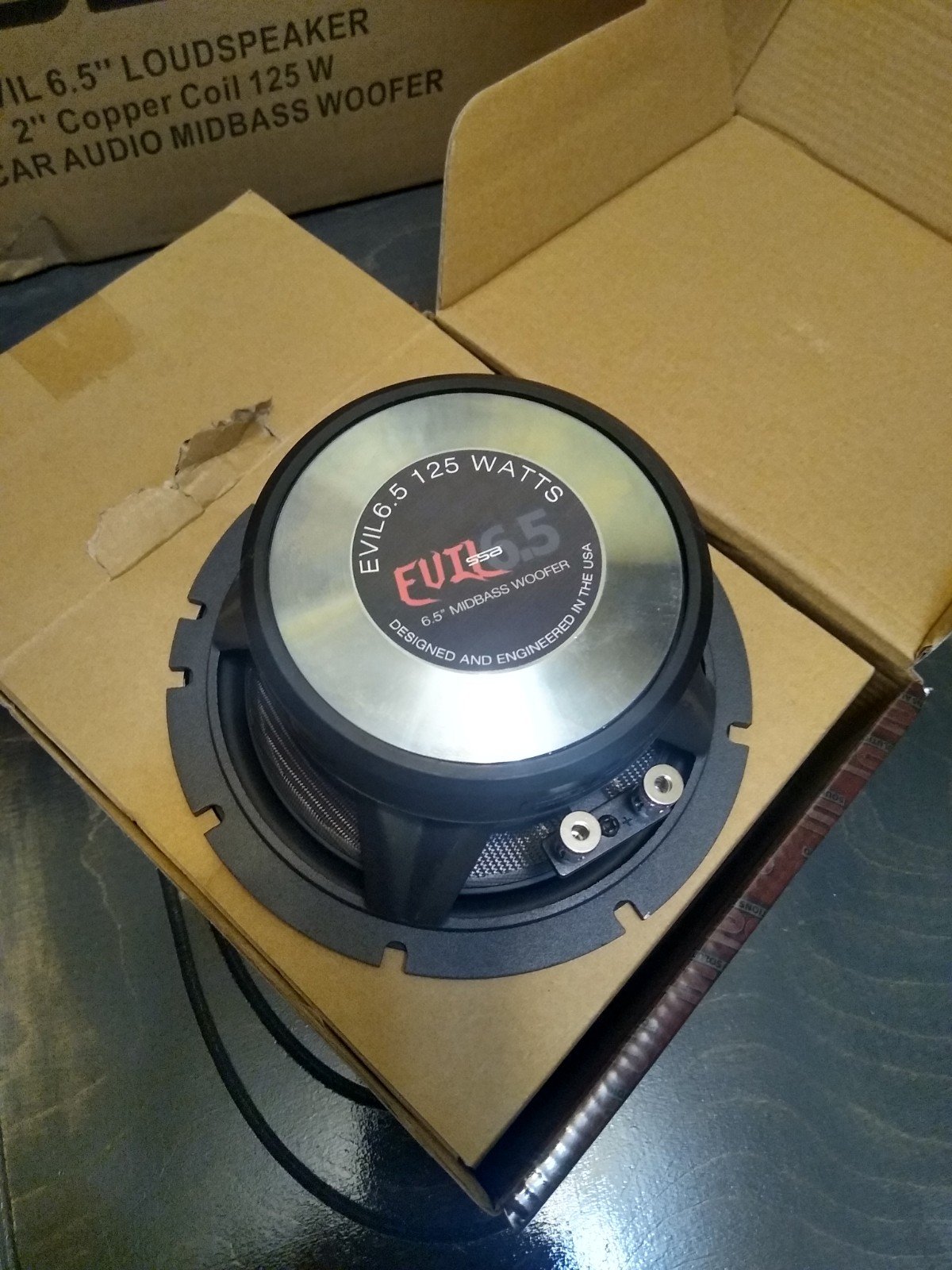

Box came out pretty sick, this is with 3 coats of poly over a one coat grey carbon base stain. I am going to wait 4 to 5 days for it to harden then sand it down and hit it with 3 more coats. The stain covered really well, i did scuff it with 400 before I cleared it to give it a weathered finish which I'm fond of. It almost looks like marble lol. The SSA mids came in today as well. Pics do not do these little bastards justice. The build quality is fantastic and they are heavy af for 6.5's, the tweeters are even heavy, feels like a good set. Will try to get them in this weekend.

That enclosure color looks pretty badd azz. Be perfect color for inside one my trucks. sweet looking mids. Ill have check those out.Depth would not matter much to me using door pods. Im a succker for C.Fiber! 👀 👀
