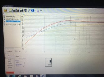

Probably going to be hard to read all of that graph but it looks like two of the Soundqubed HDS3.215 in a 6 cubes ported box tuned to 27hz plays nicely, it’s the red line that it’s clicked on. It’s on the small side for airspace and they definitely gained a lot with 10 cubes but compared to sealed in 6 cubes they seemed to actually outperform. The four 10’s tuned to 27 as well was the orange line that just barely beat out the 15’s between 24-28hz
3 of the SI 15’s in 6 cubes sealed showed very similar results to the two ported HDS3.2’s
I could just be doing this all wrong though 😂
Nah, I think you nailed it. Comes down to application and what you can do or want. I think that 3 15's is ridiculous but hey, would I? It'd be fun for sure. I personally like my Focal 33v2 13's in their larger-ish 3.44 cubic foot sealed and stuffed box, my kind of sound.
