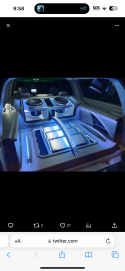

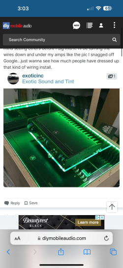

Hey guys, thanks for taking your time to read my post. I need a little help. I have a 2009 Chevrolet Suburban 1500 LT. I have a system inside of it already, a 12 inch Alpine S, Club A5055 amp, High end Pioneer Headunit, and Infinity Kappa high end speakers. I want to take this build to the next level. I want to put 3 Alpine Type R’s 12’s into my trunk, fiberglass,Glass,LEDs, and small screens. Are there shops/websites that do this type of custom work? I am a mechanical engineering student and am doing graphical design too so I have a pretty good idea of what I want this to look like and I have friends that have wired car audio since years. I was wonderin, if I have to build it myself or if you guys recommend building it myself. Is it hard to build a box or is there a special way? Here are some pics online (I don’t know the original posters I apologize) that I want it to look similar too. I was also wondering if I could build into the floor of my truck, like put my amps on mounts down there, seal it with glass and put leds all around. Are there any websites that sell everything I need such as leds mini tvs or Medium Density Fiberboard. And if you guys have any tips/suggestions on what it should look like. I had an old account on this website, but lost access to it. I was also wondering what would be the best amps for power and their looks and the info on what the best amps,subs, speakers or brands you guys recommend

Those are some EXPENSIVE (expert) custom installs. It's a matter of skill, experience, and MONEY! Truly integrated installs like that often cost more than the vehicles themselves. @CarAudioFabrication, @WillistonAudioLabs, @Audioholics, @cheapaudioman, and @crutchfield as well as virtually every manufacturer out there are on YouTube with some really great info-vid's. That said, you could spend half your life watching and it won't get you a month's worth of shop training. Your question on equipment is WAY too general and you'll get a thousand people's opinions on that question alone. If you have the means, go to a couple of big car audio shows or one big one for a week straight, go listen and get an idea of what your taste in sound actually is. People tend to think they are going to like this and that but often don't really have a good understanding of what that actually is. Before dropping a shizload of $$, need to find out specifically what the sound profile you like, looks (sounds) like, before setting a goal for a substantial build. That JL setup alone could be $10-$20000 dollars when you consider all the talent and highly skilled people and man hours let alone the equipment cost. You have to understand what your "sound" objective is before you can make a "sound" decision, regardless of who what why, or where that information comes from.

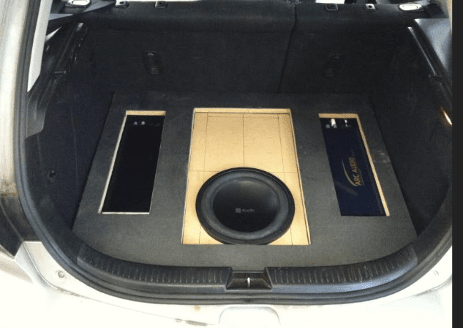

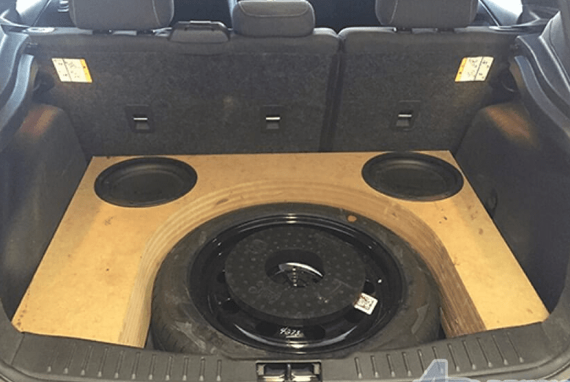

Just do your build over the existing floor using wood and whatever. I always do it with hatchback builds, like this Ford Focus, Remove the flooring, the carpet, etc. then fabricate a new facade for the interior rear (like you could for a trunk), including the space that once housed the spare, or not, like this. I use powerful cement glue, like liquid nails (silicone glue works well too) to secure the wood.
