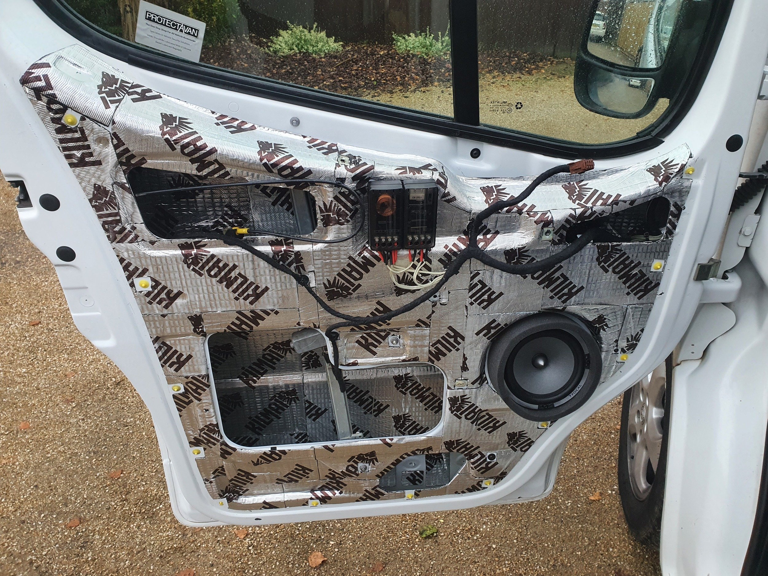

I started off cleaning and sound deadening the doors (very time consuming!)

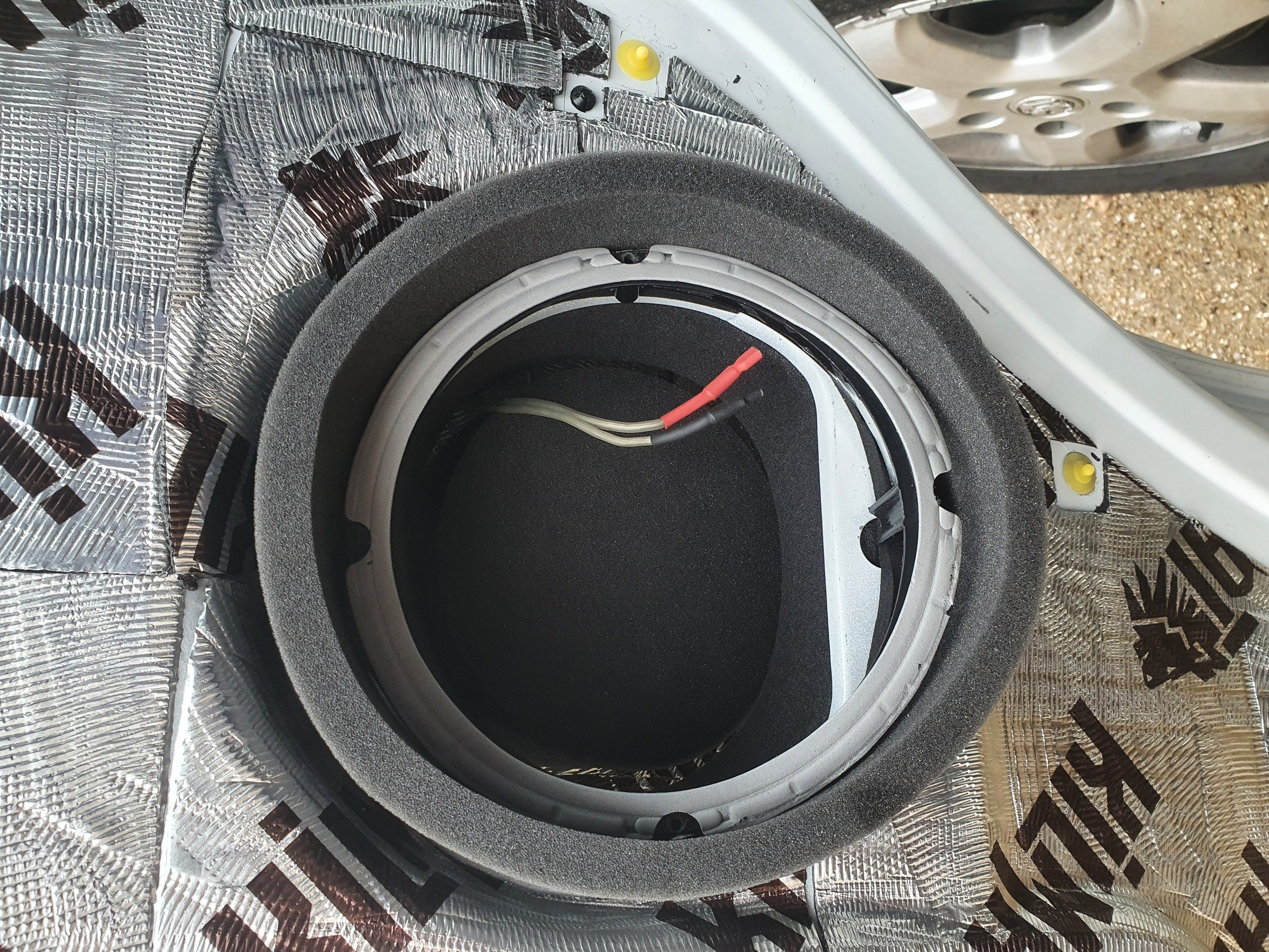

The speaker adaptors i bought were pretty flimsy So i covered both sides with sound deadening. I used the speaker gaskets that came with the speakers and I also used foam tape to seal the adaptors to the door. Doing all this has made them a hell of a lot more solid.
Next job was to run all the wiring into the doors. I learned this really nice trick on youtube to get the cables nice and neat through this plug by drilling out the unused pins.

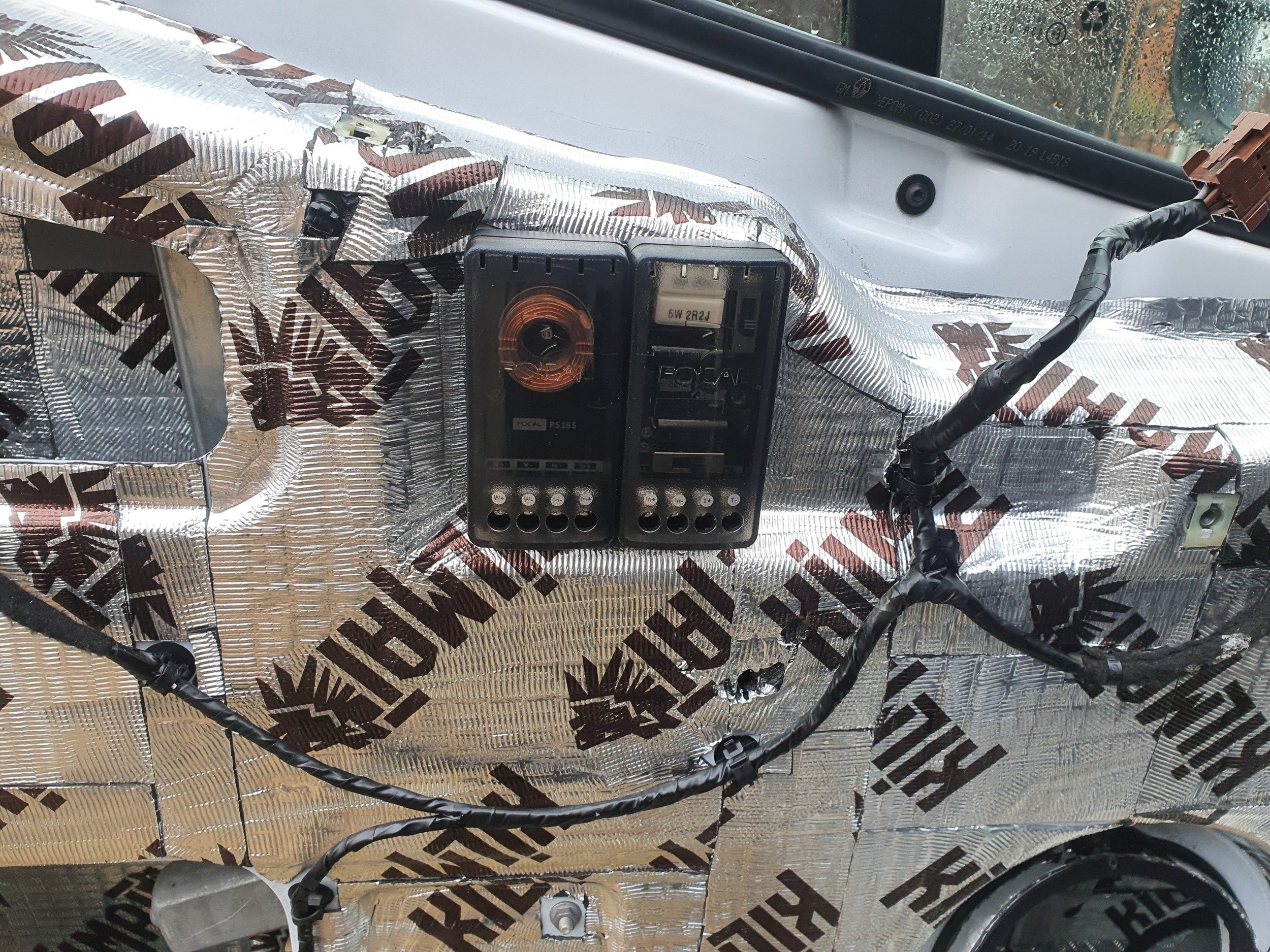

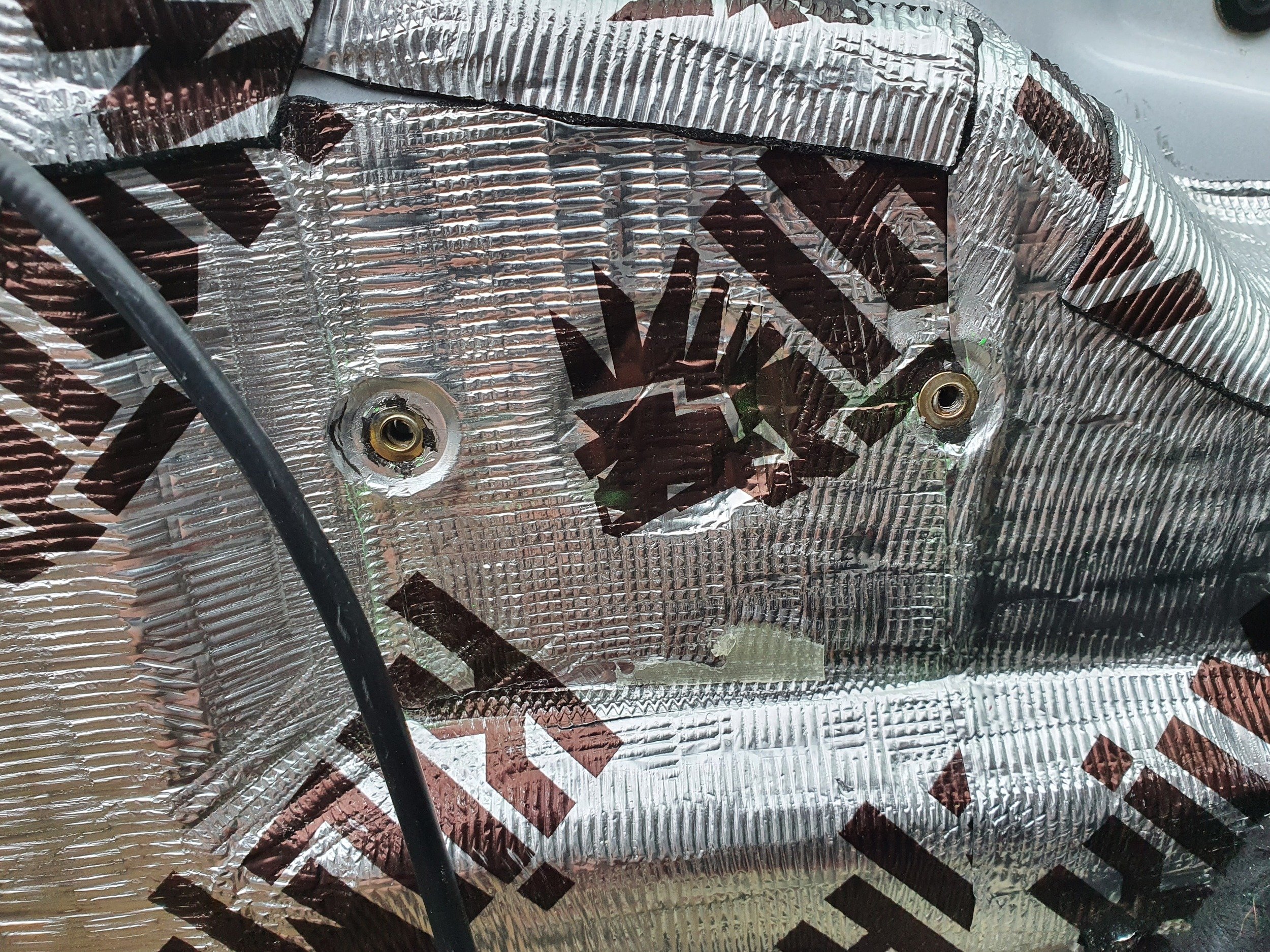

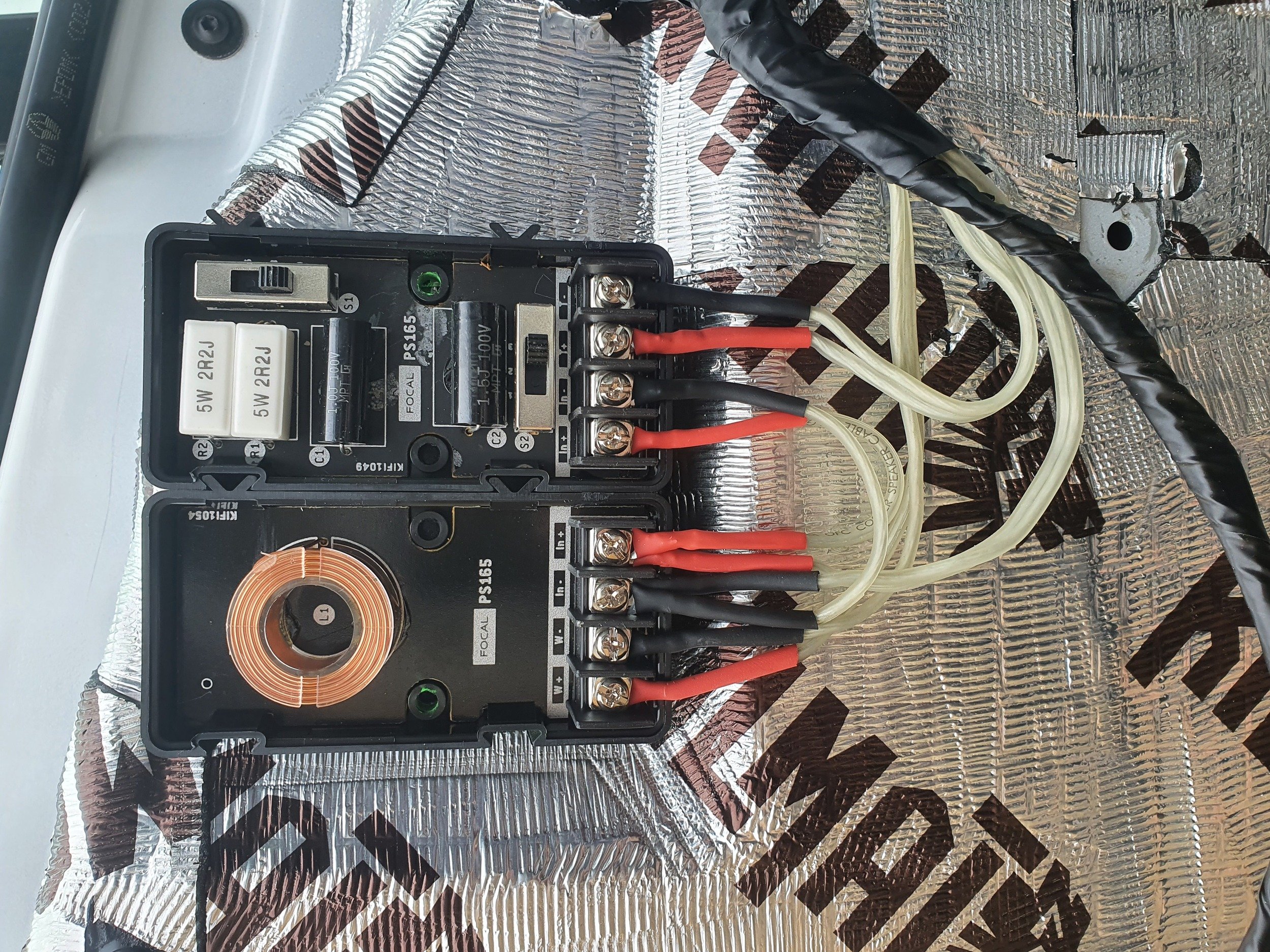

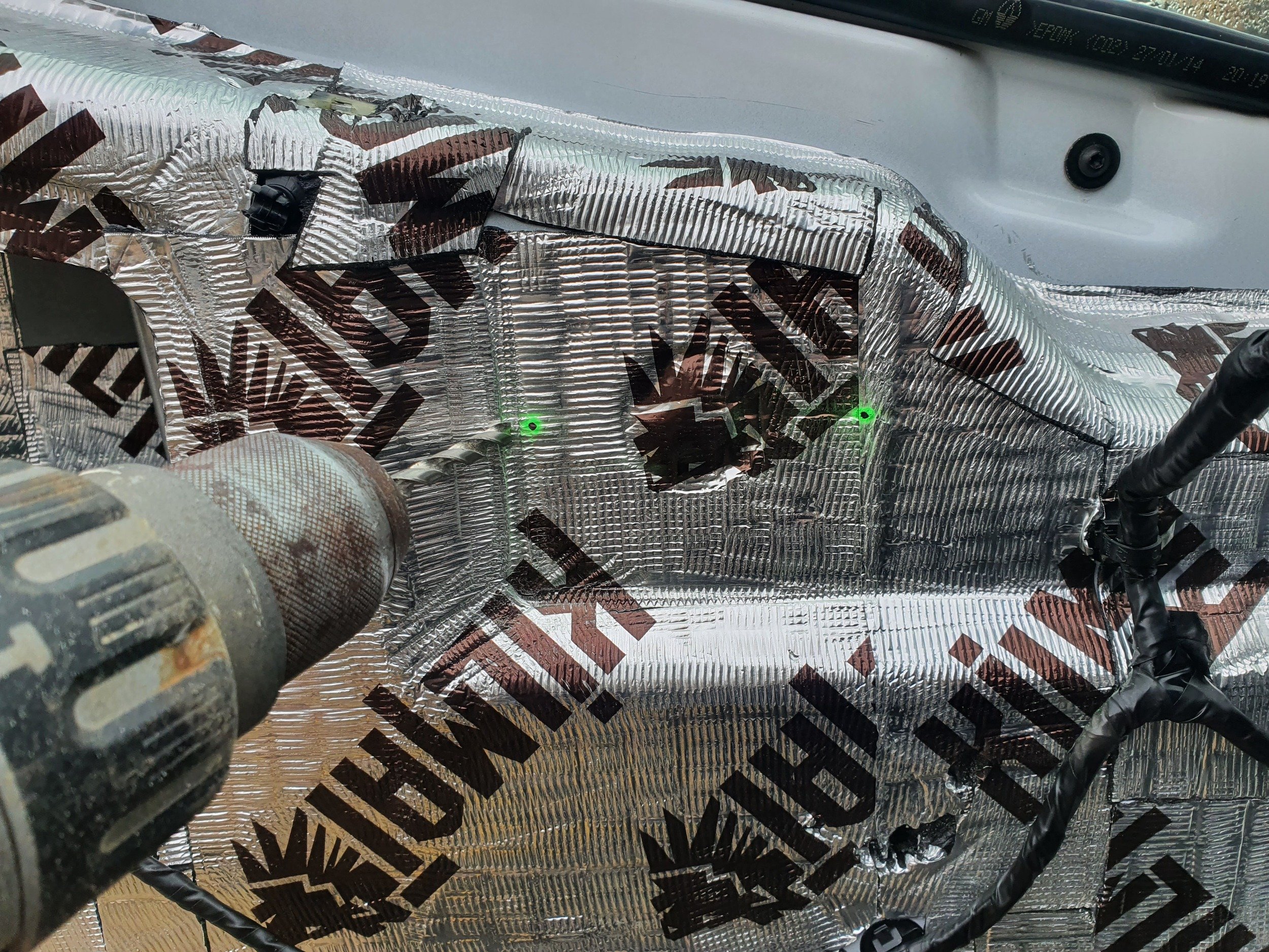

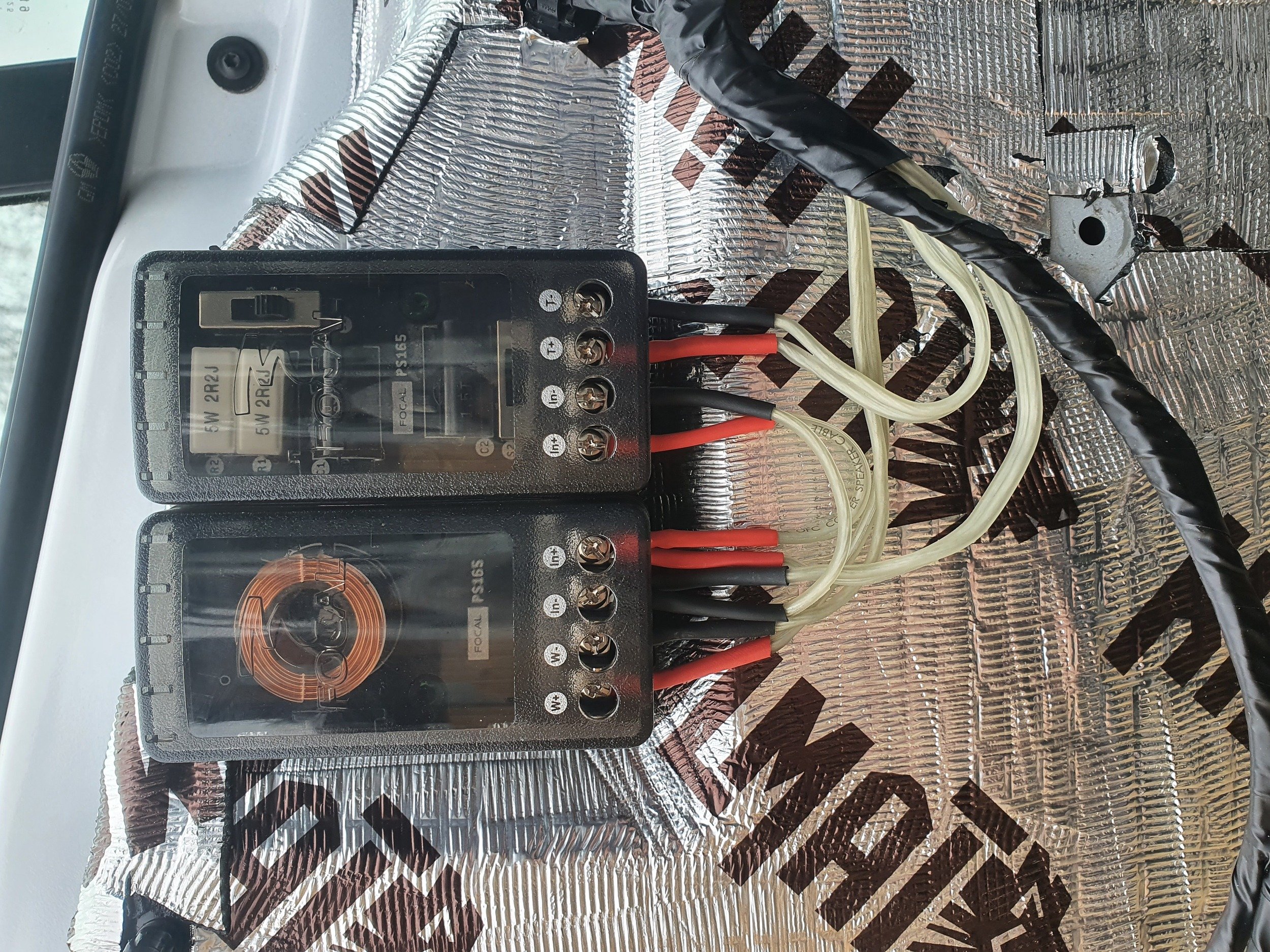

Next I wired up the crossovers. I found this really nice indent in the door panel which was a perfect size to fit them. I bought a rivnut gun so I can properly mount them the door with bolts. I also added some foam speaker rings and wrapped all the wiring up neatly with tesa tape.
