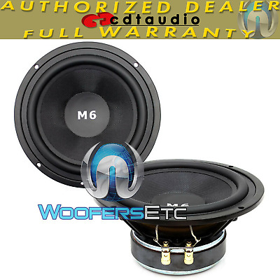

CDT, Si, Stevens, all good options. I have a air of the CDT ES1200is tweeters coming with are very nice too. $114. The CDT 6.5" woofers I have pair very well too.
The same driver can be had from their ebay affiliate for $239 a pair.
