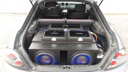

Yeah the sub enclosure aka sub box is the most important thing. Your box volume is too small and its tuned too high with too thin of wood. A new box would make a huge difference. Look how large my box for two 12s is. You'll need something like this. A box is not too hard to build if you have a table saw. I could even design a box for you for free if you'd like. You could also pay someone to build it if you have the money. You will not regret getting a new box I promise
