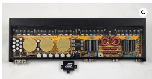

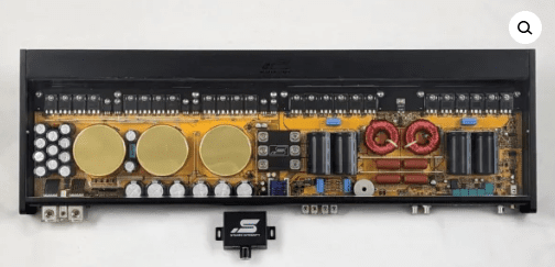

Here is what I run, currently. HQ full Korean, from this guy on ebay with a 3 year warranty.
Very powerful, built like a tank!

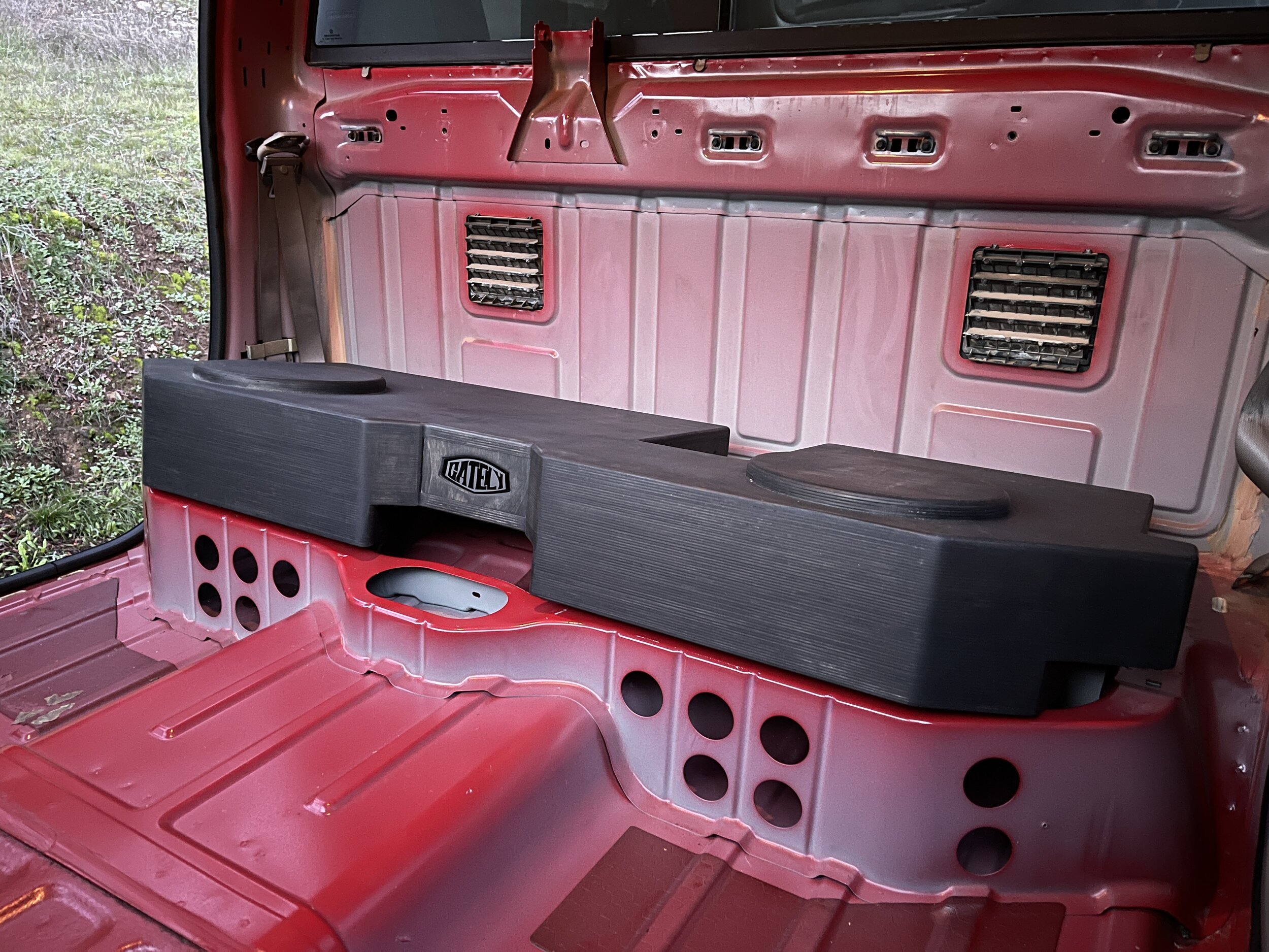

Thanks for your replies. Would the box (or its tuning) play any role in 1vs4 ohm selection? It’s a Gately audio ported enclosure down firing under the rear seat. Supposed to be good SQ for a ported box, but ported nevertheless. I’d prefer SQ over SPL, despite this box choice.
I was having a difficult time finding a quality enclosure that fit my truck without losing functionality. My buddy told me these are legit. Though, it may not be a perfect fit for the SQ goal…

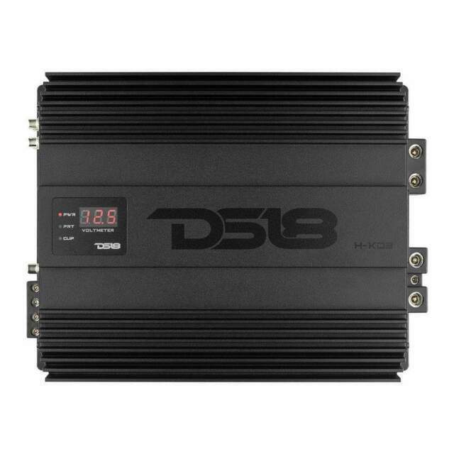

That should work great. Impedance and power are not a function of the box (yes, impedance rise is impacted by the box, not thinking that is the OP's question) though sound pressure containment can be, not an issue here for the most part and not a huge consideration. I doubt seriously that you will ever push the subs you have anywhere near that level. My H-KO3 can deliver 1500 watts to my two Focal 33v2s which are wired to a 4 ohm load, which are rated at 400 ea. I've got the gains turned way down to get that output around 1000. I can never even get close to that use before it gets uncomfortably loud! Here is vid of a guy demonstrating output to volume - amp draw, it kind of sums it up.
The box doesn't care about ohm load.
As far as sq and a ported box its not that simple. A ported box can sound like trash or sound awesome. It's more of a function of getting the right airspace and tuning frequency for the driver and your goals.
People say sealed is for sq say that because a sealed response curve is usually fairly flat but if you look at that same curve everything below 45hz drops off rapidly. Those same people rely on cabin gain to boost that bottom end which doesn't always happen
A ported box can be built to be just as flat but it's typically a larger box with a much lower tuning frequency
