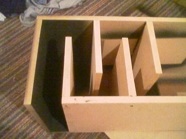

req Feb 15, 2005 Re: Labrynth Structure hey man, if you dont mind me asking, what tuning is that, and what size box, and for what size woofer? nice looking port right there.

L L Lorinser430 Feb 20, 2005 Re: Labrynth Structure req said: hey man, if you dont mind me asking, what tuning is that, and what size box, and for what size woofer? nice looking port right there. Click to expand... It's tuned to 33Hz, 2.25 Ft. (Not including port, sub) for a 15" Orion H2.. ...Built with information from your website, btw! :thumbupw:

L L Lorinser430 Feb 20, 2005 Re: Labrynth Structure Lorinser430 said: It's tuned to 33Hz, 2.25 Ft. (Not including port, sub) for a 15" Orion H2.. Best I can remember on the port, it's 16" x 3" x 47" ...Built with information from your website, btw! :thumbupw: Click to expand...

L L Lorinser430 Apr 5, 2005 Re: Labrynth Structure Perfect sound from 33hz all the way to 150 or so... Sound quality is good for a 15.
