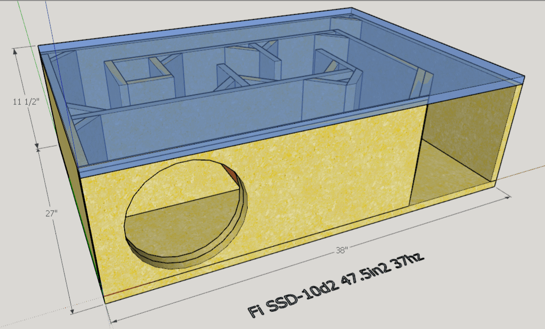

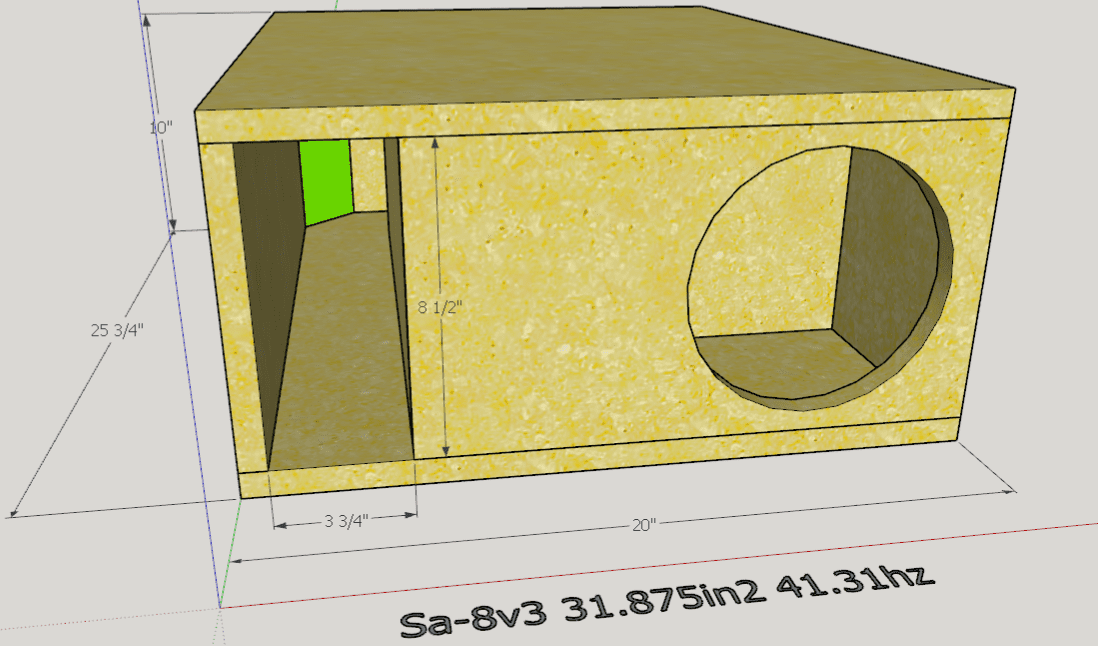

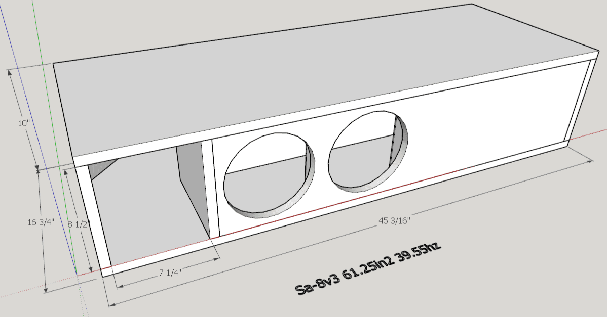

Just did my 1st Tline design... wow... look at the size difference for a set of 8's... that's a touch on the BIG side...
Not too hard either... find Sd, 1/4 length of wave at Fs and size it. Then draw it up, woulda been easier if I had a set value for dimensions to start with but it wasn't too bad.
I used the Sd off Winisd at about 31in2 per... I'm hoping that's correct, as using the Sundown site measurement diagram (no Sd in specs just looking quickly) and including the surround I came up with 82.29in2. I drew that up (the 82in2) and it was REALLY big... lol.
Any tips, or comments appreciated...
Thank you in advance.

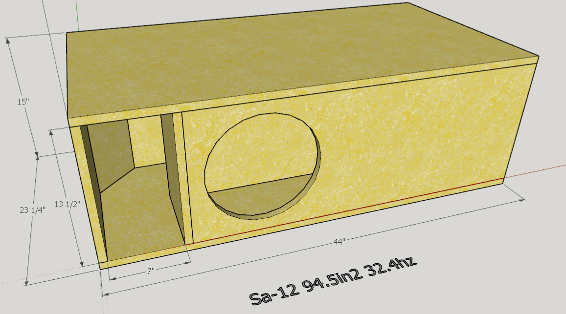

I'm just trying to learn the basics of designing a Tline... and it seems pretty basic to me. Took 1 hr on the 1st attempt to design it and draw it up. I might just pick up a Sa-12 (Qts is a lil' high for SQ but I like the coils on the SA's) to play with and I happen to have a RF 500S sitting here atm, I believe that much power should do pretty good as the efficiency of these Tlines are supposed to be something. Maybe hit the thing with BD 1000 power but IDK. Most people say a ton of power isn't necessary. So I'm on the fence about to get a dual 2 or 4 ohm if I wanna play around.

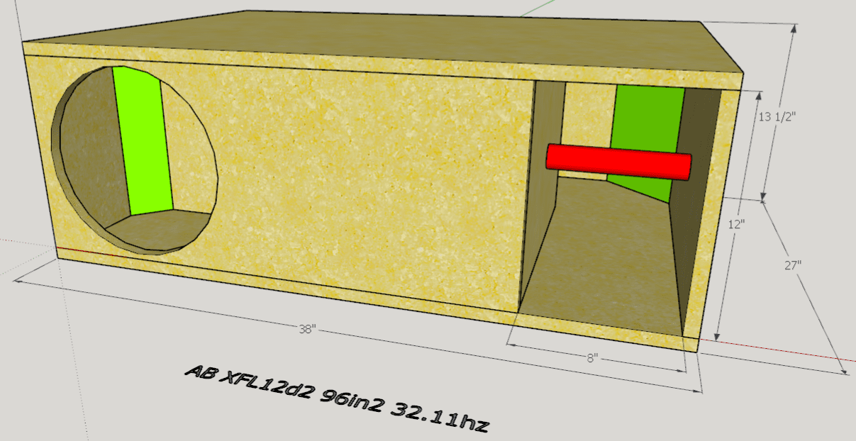

If you want ill try to do a design for ya... I'm lookimg to practice on another. I'll send it to ya' and you can critique it or improve it if you can.
Pm me if you'd like for me to try... I'm kinda short on time atm but I'll find time.

For HO 10's correct? Wow LOW Fs... 107in2 of Sd and 126in of port... yep, that'll be a big one

Anyone want a design?.. I have a few more... lol
