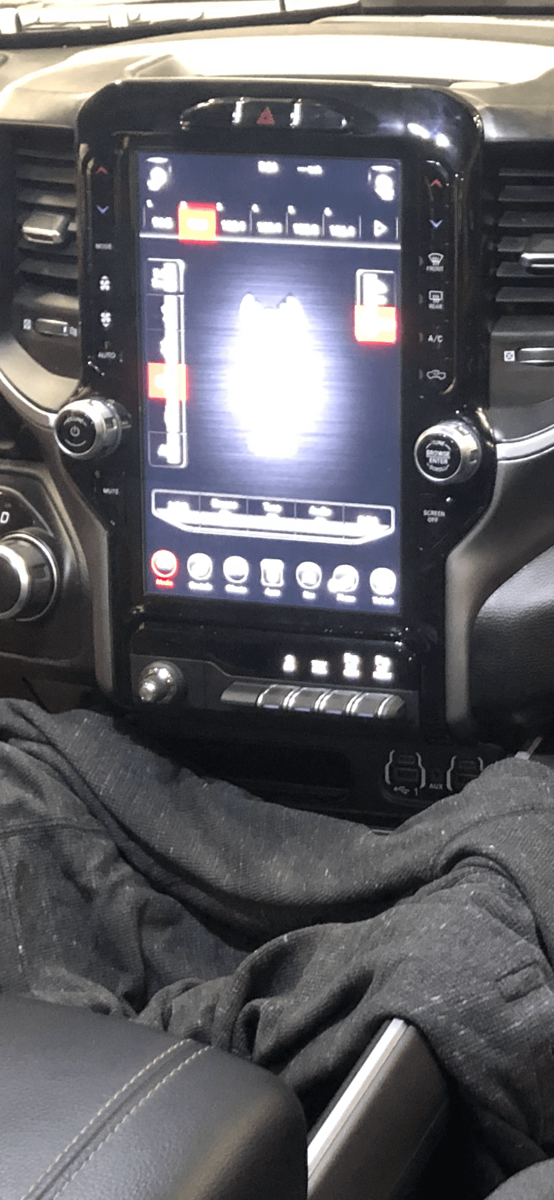

HU: Factory Uconnect 12”
Integration: PACAmp PRO AP4 CH-41 - Toslink to Amp/DSP

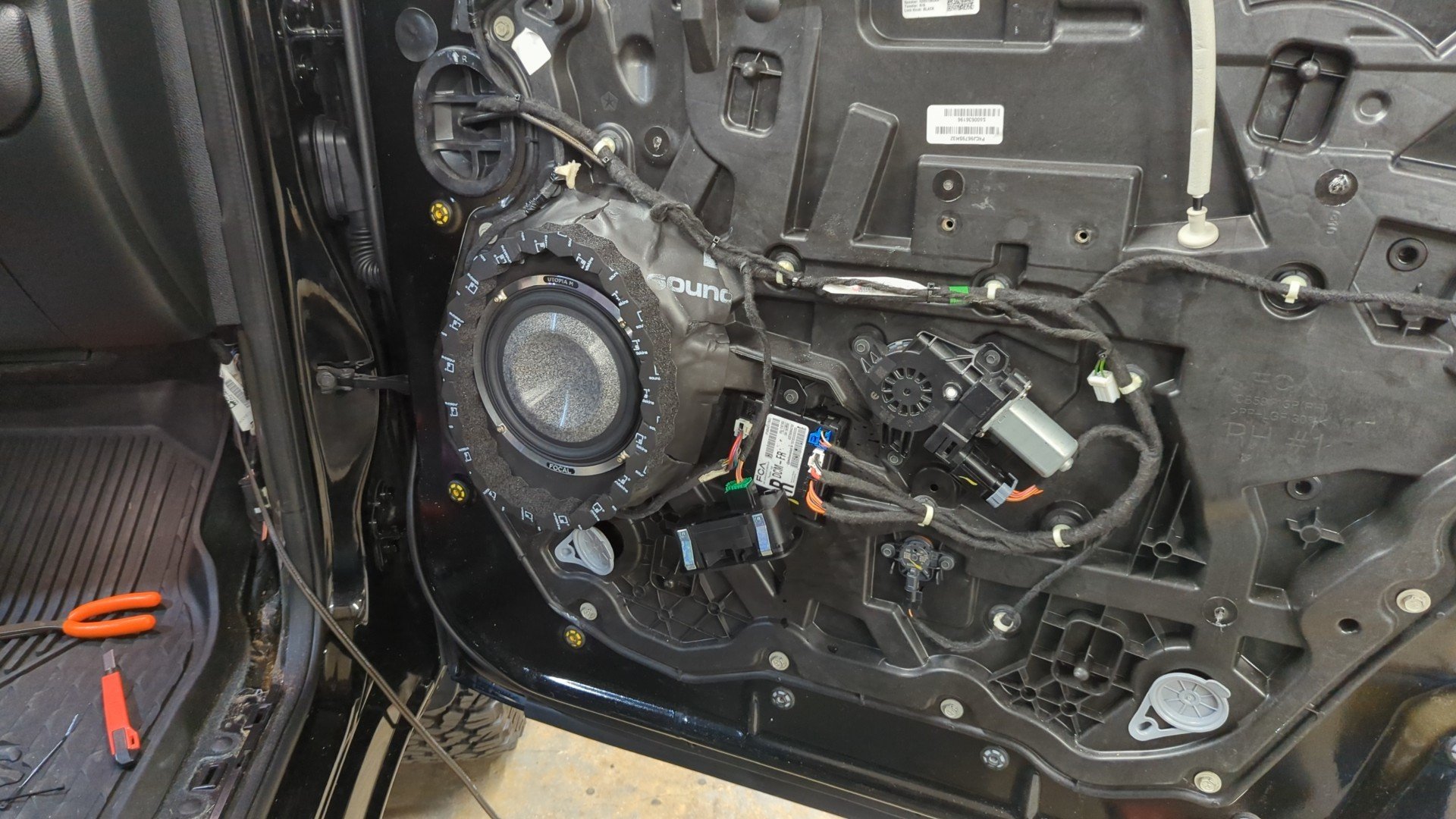

Front Stage: Focal Utopia M 3-way components (6WM, 3.5WM, TBM)

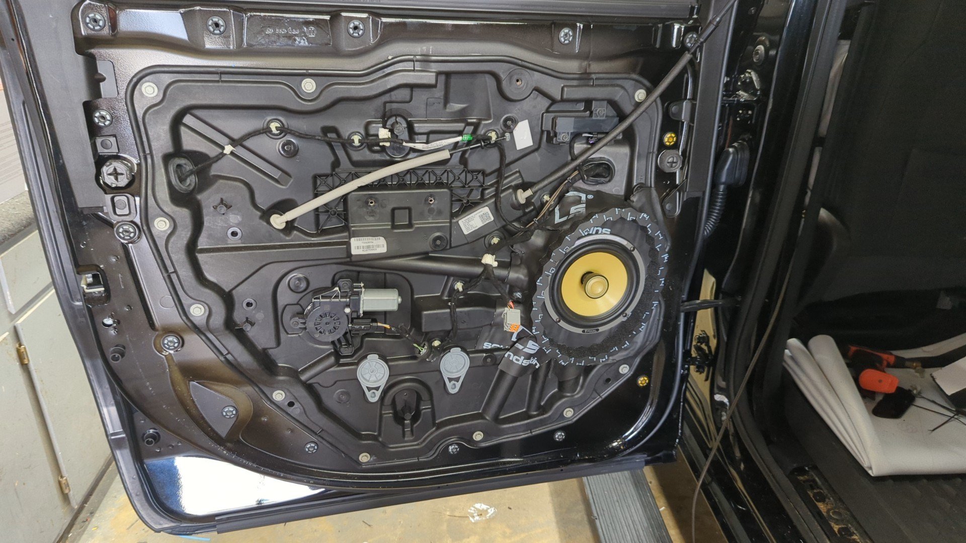

Rear Fill: Focal EC 165 K2 6.5” coaxials (not used on primary tune)

2) JL Audio VX400/4i (bridged to two channels - 200 watts x 2 at 4 ohms - driving Utopia 6WMs in the front doors)

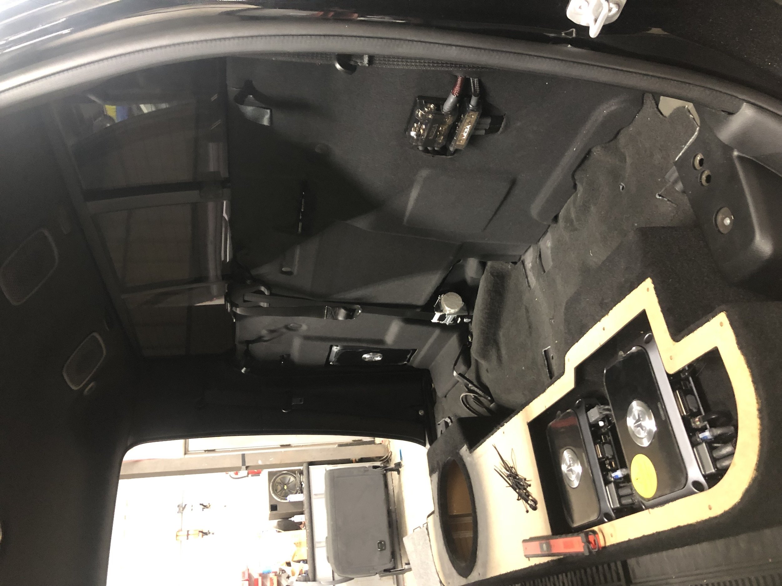

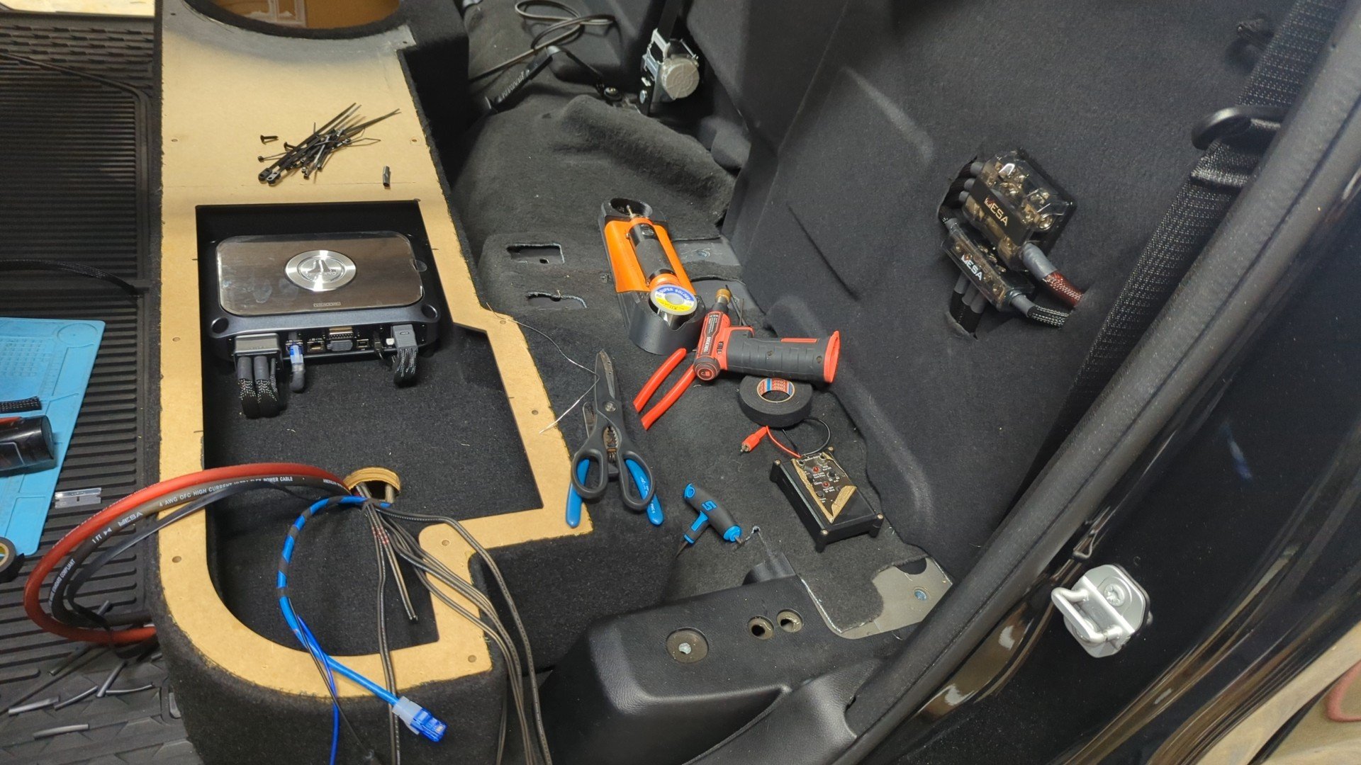

The truck is an eTorque, so the factory electrical system is rock solid. Factory battery was replaced with X2Power Premium AGM. 0 gauge power and ground ran from the battery to distribution block on rear wall. Also grounded to chassis. 4 gauge power and ground to all amps.
Subwoofer enclosure and amp rack built by NetAudio in Witchita Falls, TX.

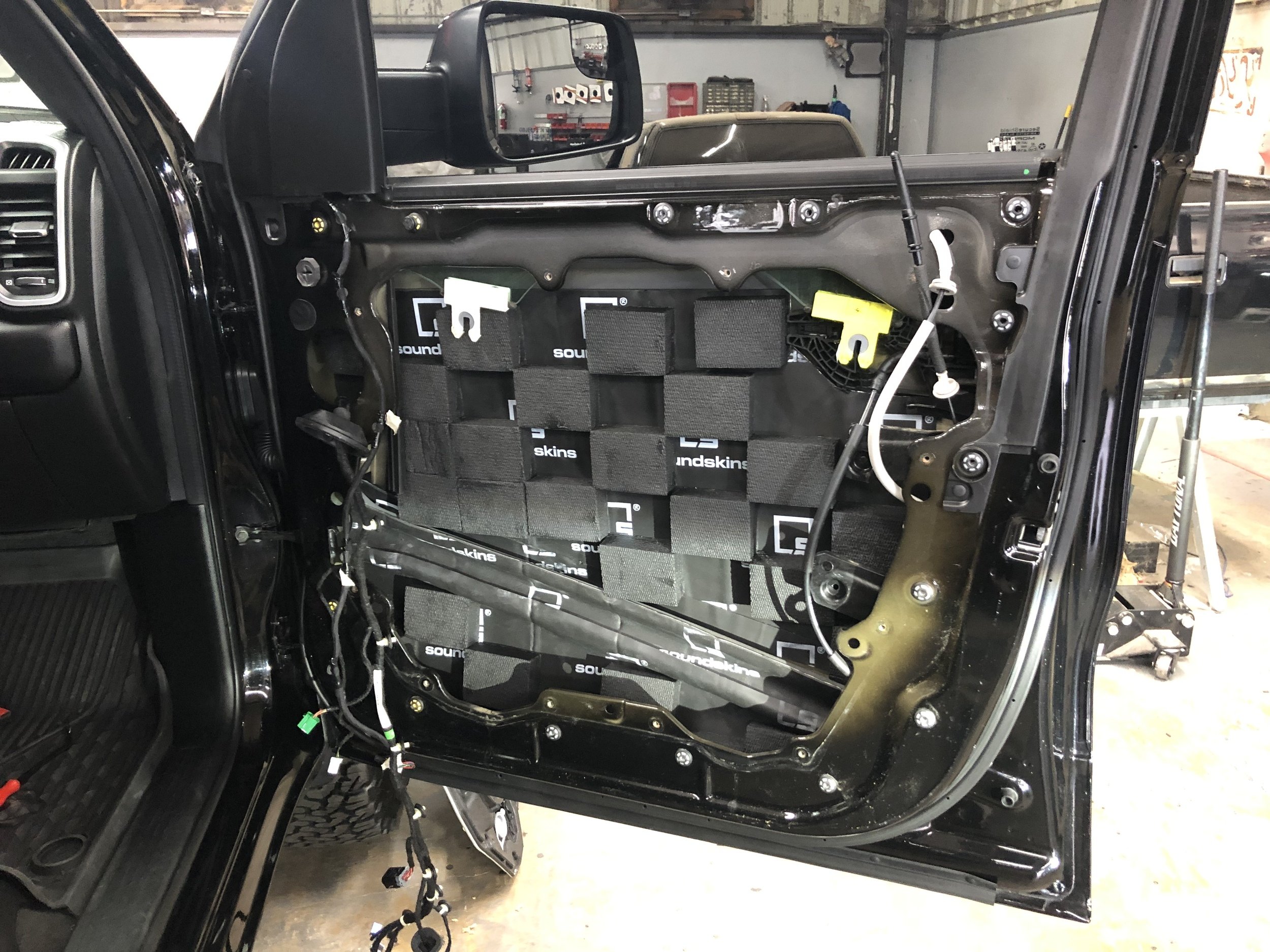

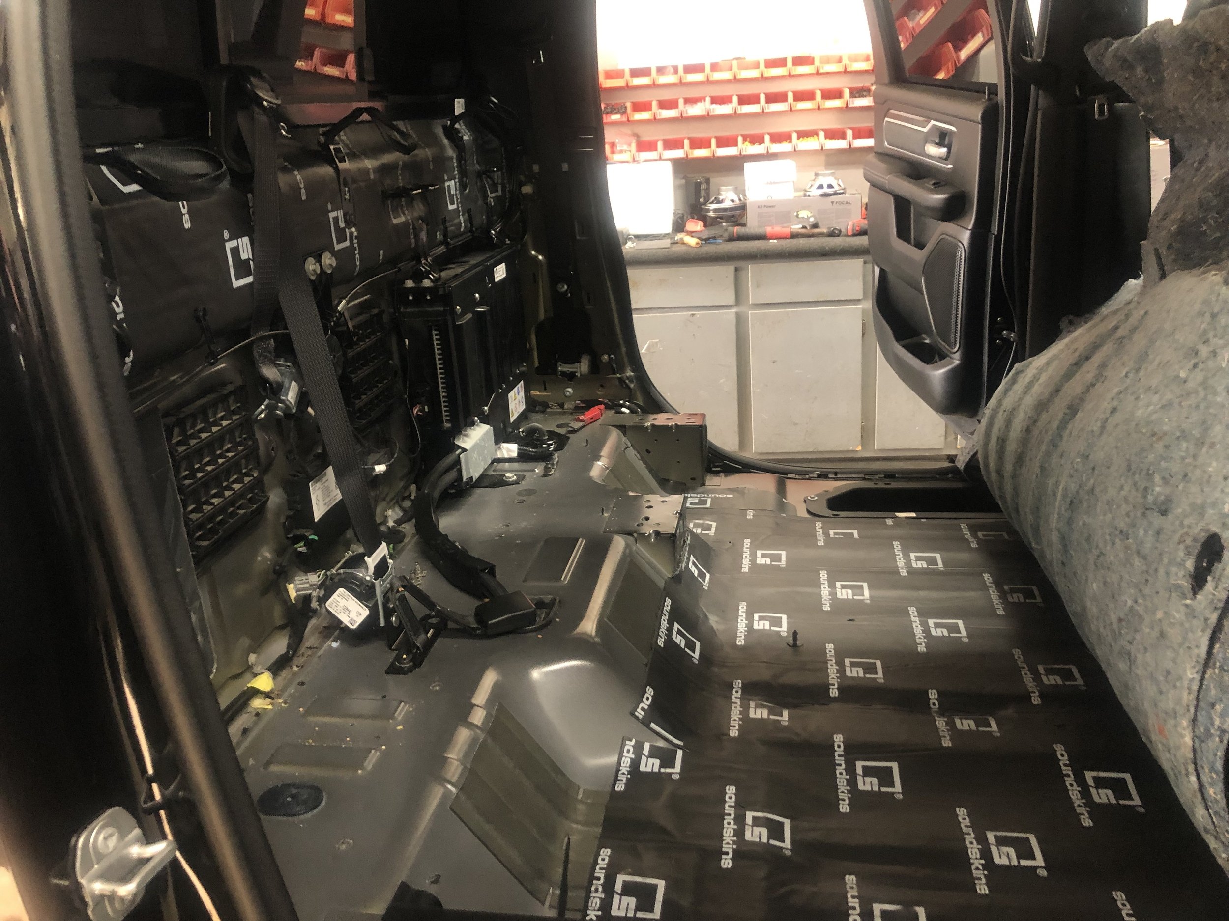

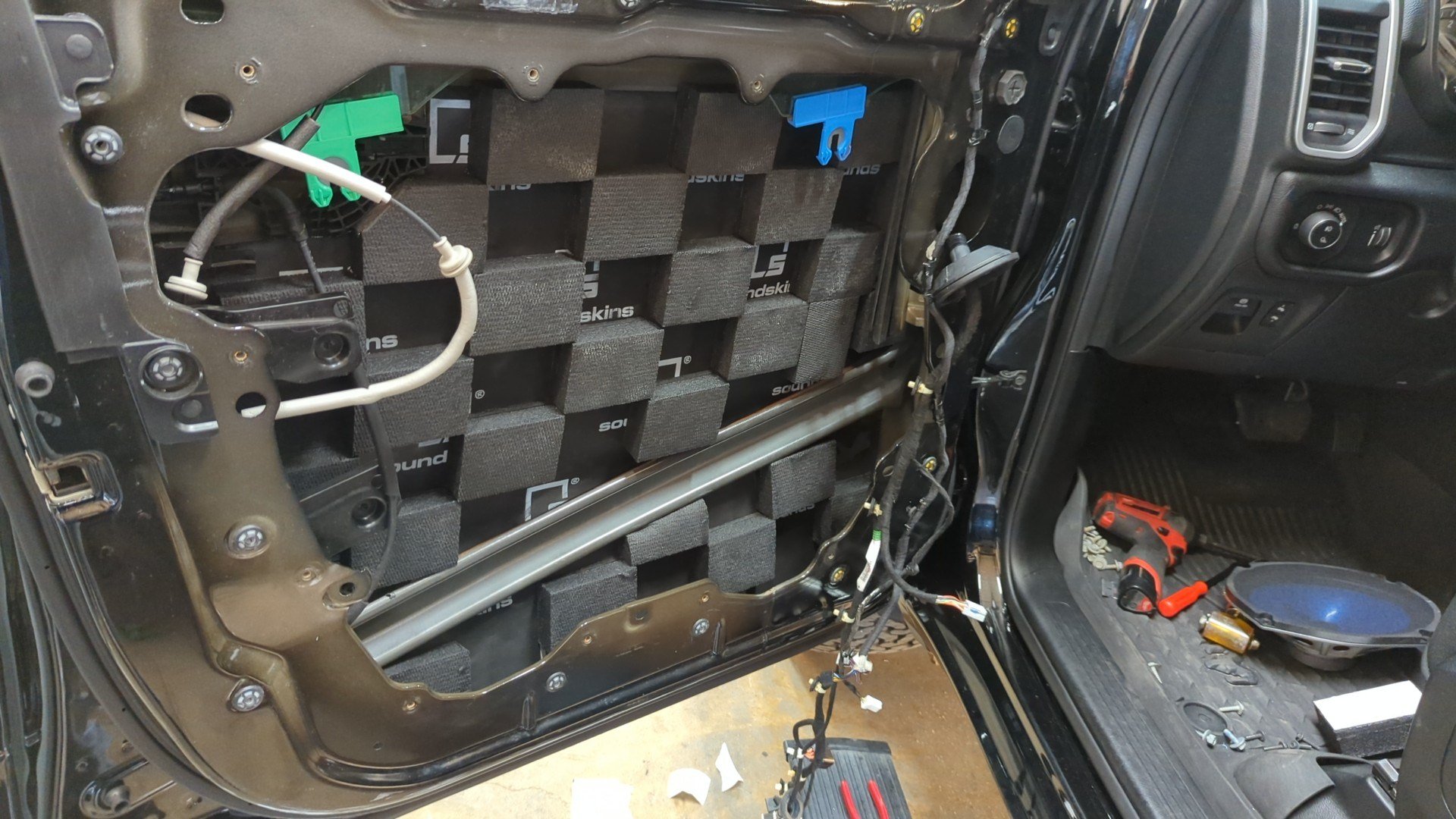

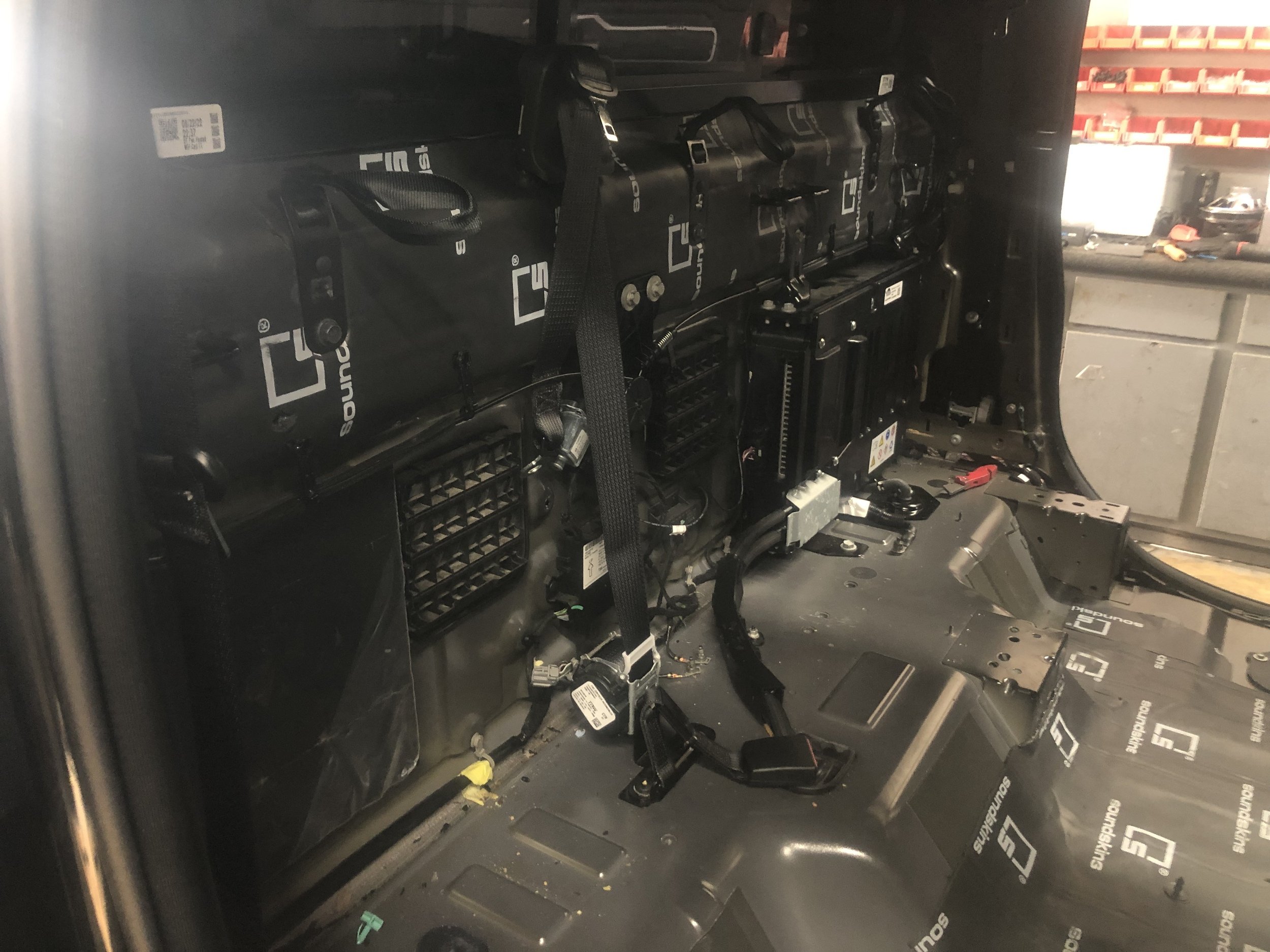

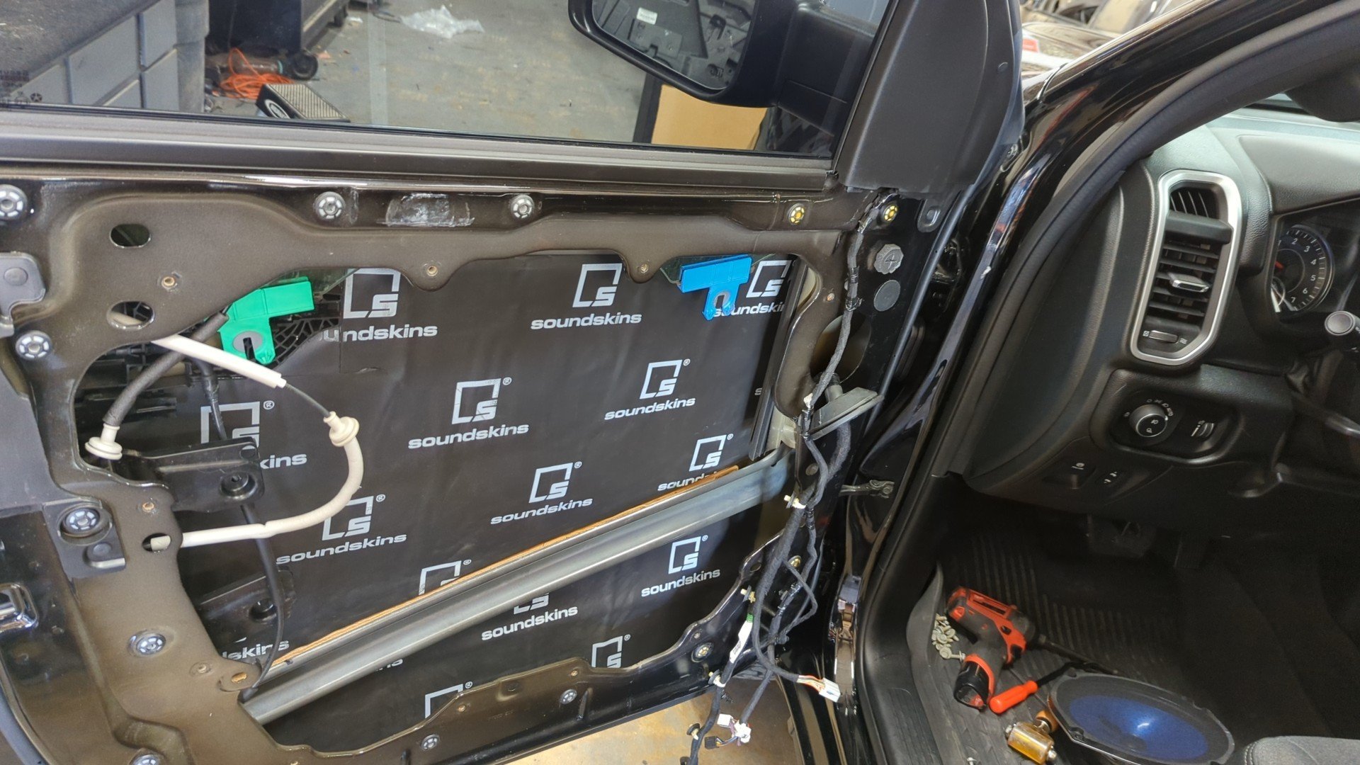

We used an entire “shop roll” of SoundSkins. I also used a box of Black Hole Tiles in the front doors, with a few left over for the rear doors. The tiles make pretty decent decouplers also. 😊
The truck is around 80% covered and dead quiet. I haven’t heard any rattles, noise, or anything reverberating. Every seam is lined with butyl rope. Decoupler was used on A,B, and C pillars and door panels. I’ve lined the roof with Fibermat and left over soundskins. It’s the first build that I haven’t had to chase down some obscure noise.
