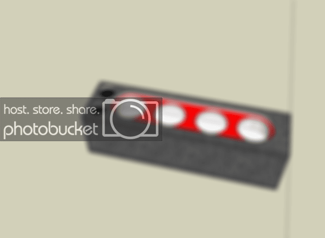

here is the design for the subs:
after all displacement its about 2.8ft^3 @ a nasty 26hz-35hz.... easily change tuning //content.invisioncic.com/y282845/emoticons/biggrin.gif.d71a5d36fcbab170f2364c9f2e3946cb.gif
I call it the BONER BOX! lol

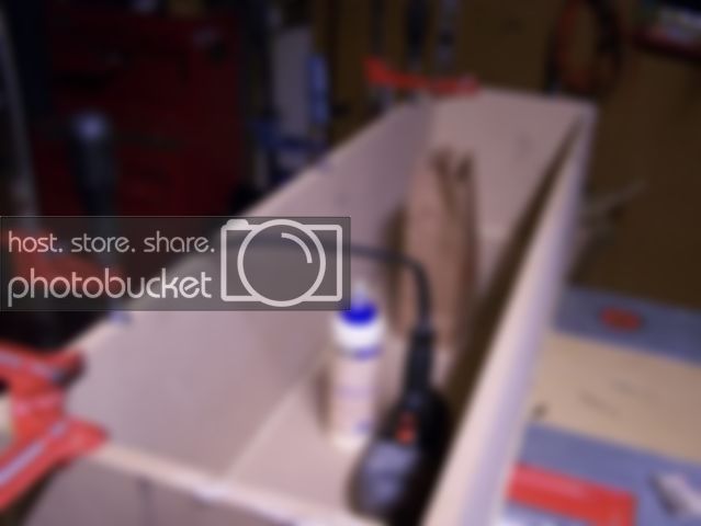

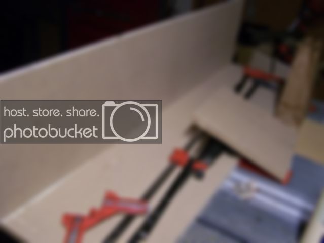

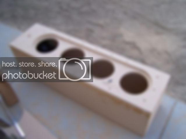

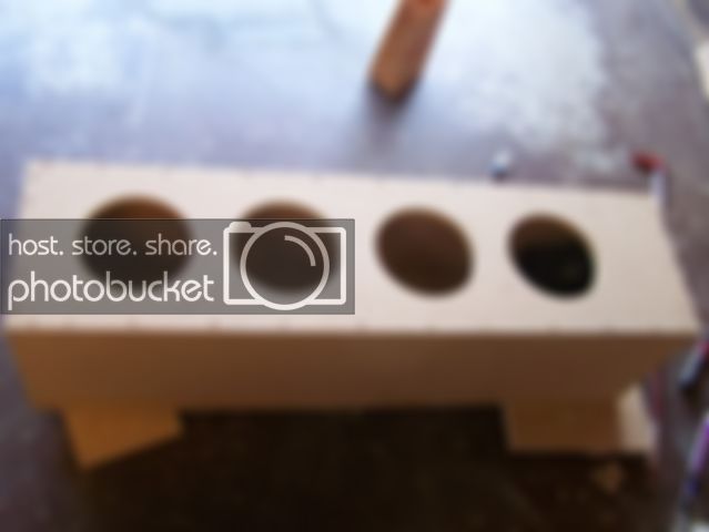

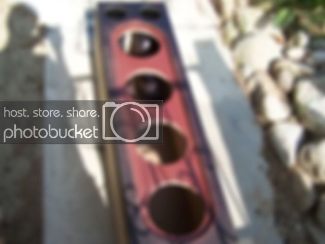

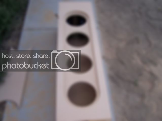

only have a few pics but all pieces are cut baffle cutout done except for top. Port is glue n right now as I type!

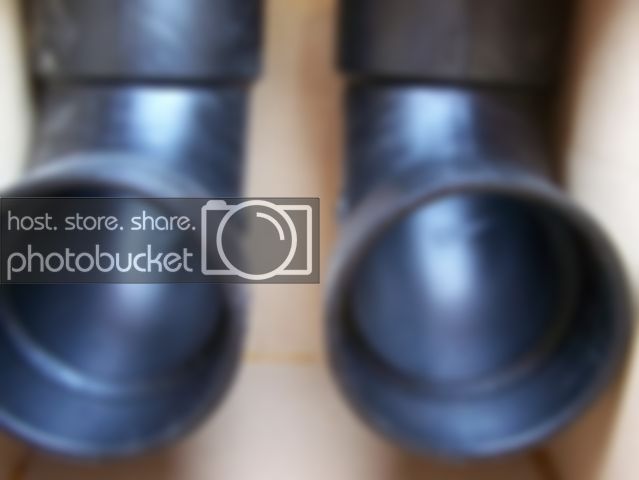

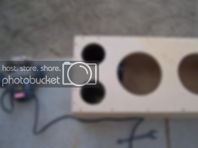

port cutouts
Fits like a glove!

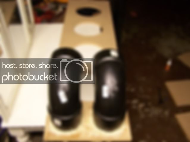

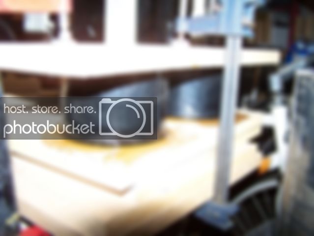

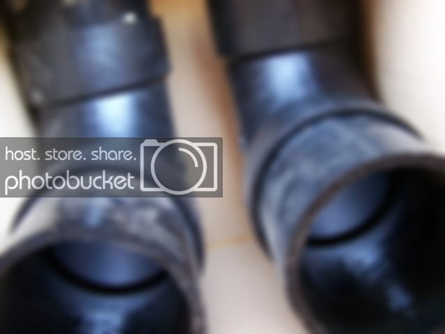

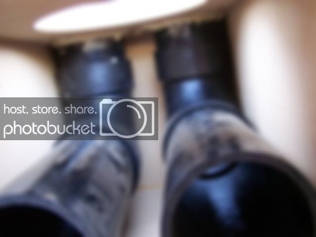

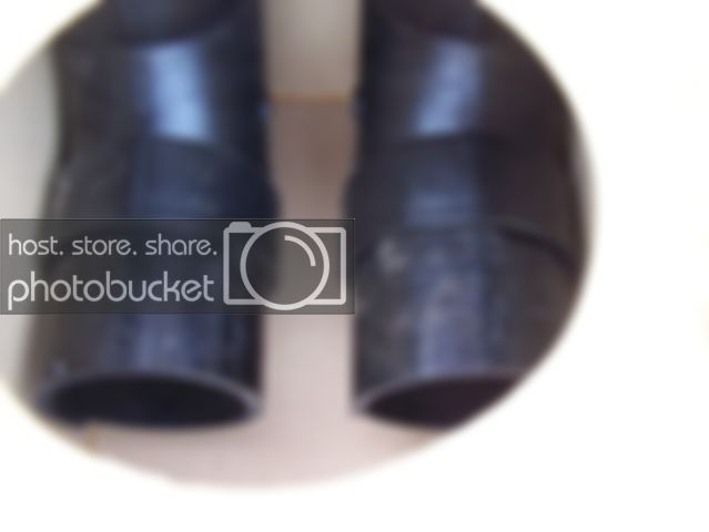

gluing the 4" risers/small pieces for port in order to connect the 90's and have the correct amount of depth
gorilla glue FTW!
This right here will have the box around 3ft^3 @ 35hz.... i can add pre-cut pieces to the elbows through the cutouts and drop the tunning all the way down to 26hz!

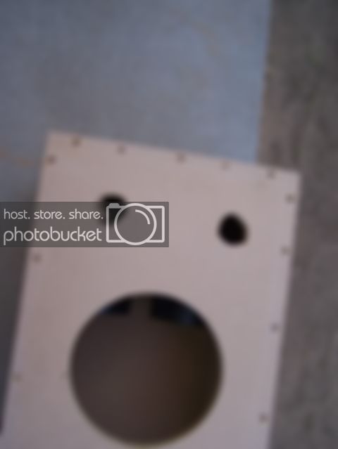

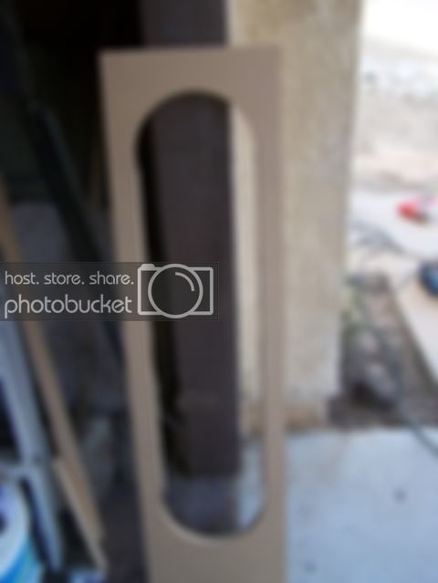

Front baffle still needs to be cutout and flush trimmed. will do tom.
back is on
skipped a shat load of steps lol

thx! i forgot gorilla glue expans to 3 times the amount! i have some sanding to do now on the edges with all that **** on the wood. wont seal up on that end //content.invisioncic.com/y282845/emoticons/mad.gif.c18f003ab0ef8a0d9c27ca78d77a6392.gif
yes, thats why it's junk
lol works for me thou //content.invisioncic.com/y282845/emoticons/biggrin.gif.d71a5d36fcbab170f2364c9f2e3946cb.gif only use it for glu n the ports in anyways dont know what idiot would use as glue for the box lol

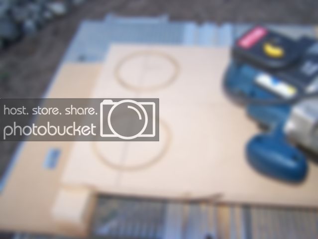

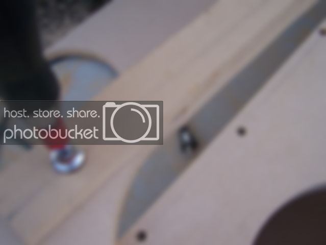

First step in flush trimming the port.... you have to make a large enough hole! haha
Flush trimmed... bottom port came out like crap! ****ing bearing fell off on the bit //content.invisioncic.com/y282845/emoticons/frown.gif.a3531fa0534503350665a1e957861287.gif thats why there is that lil area nicked out

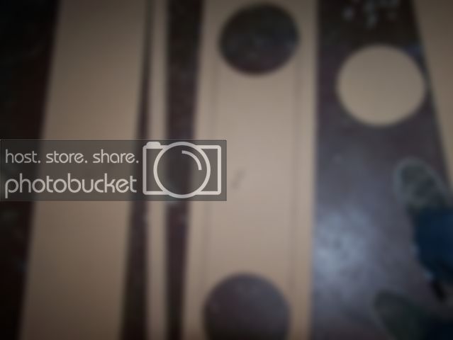

before flush trim after jigsaw cut out
getting ready for flush trim

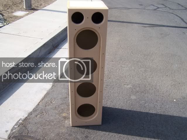

trimmed and lookn sexy!
secured on
roundover and ports roundover lookn great IMO
