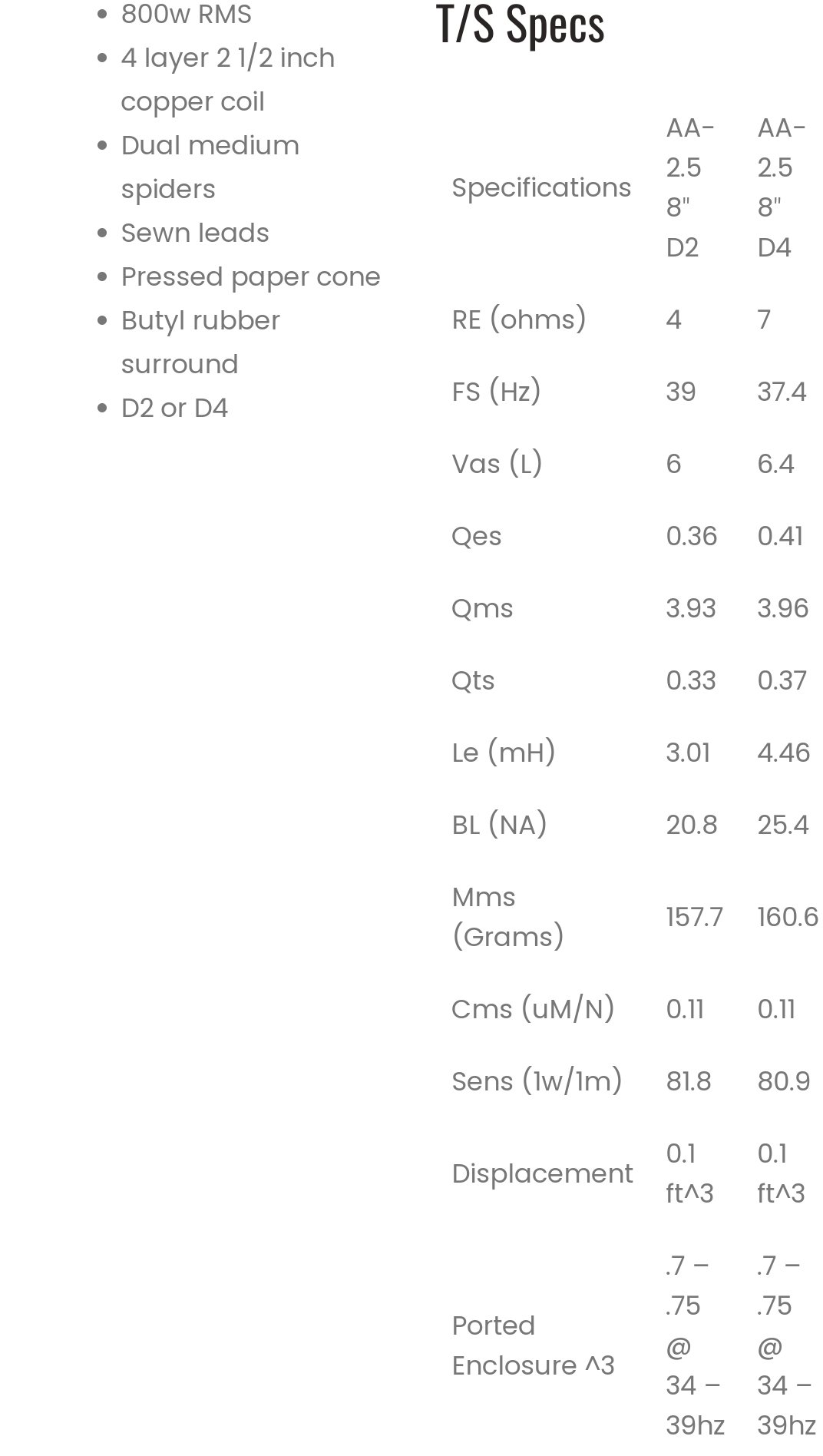

Does anybody have any experience with their subs? I'm thinking of picking up a set of these and running them on a 2K in a ported box tuned to 33 or 34. TIA
