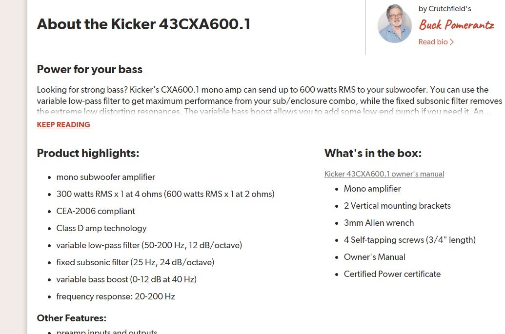

The kicker CXA amps are 1 ohm stable, though I don't see a 600.1. Just a 400.1, an 800.1 and a 660.5
This is what I see.
