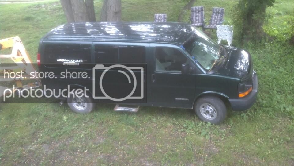

I haven't posted the thread yet. I'm buying my uncle's GMC Savana 3500 van and doing a monster 4th order. It's HUGE.
The build is still a long way off, but I'm budgeting right now

Ok, well the van has a ton of room in it, a bigger engine than my truck, and a heavier transmission with heavier duty suspension because it's a 3500.
It sucks to have a 10,000 pound daily driver, lol.
Problem is, it's got the 6.0 and almost no room in the engine bay for alternators.

The 6.0 has a readily available quad bracket if it's the same as the trucks.
Even with one alt, you come out much ahead using 12v vs HV.
Yeah it's the same motor, but it's a van.. The engine is partially between the front seats. The bay is cramped
