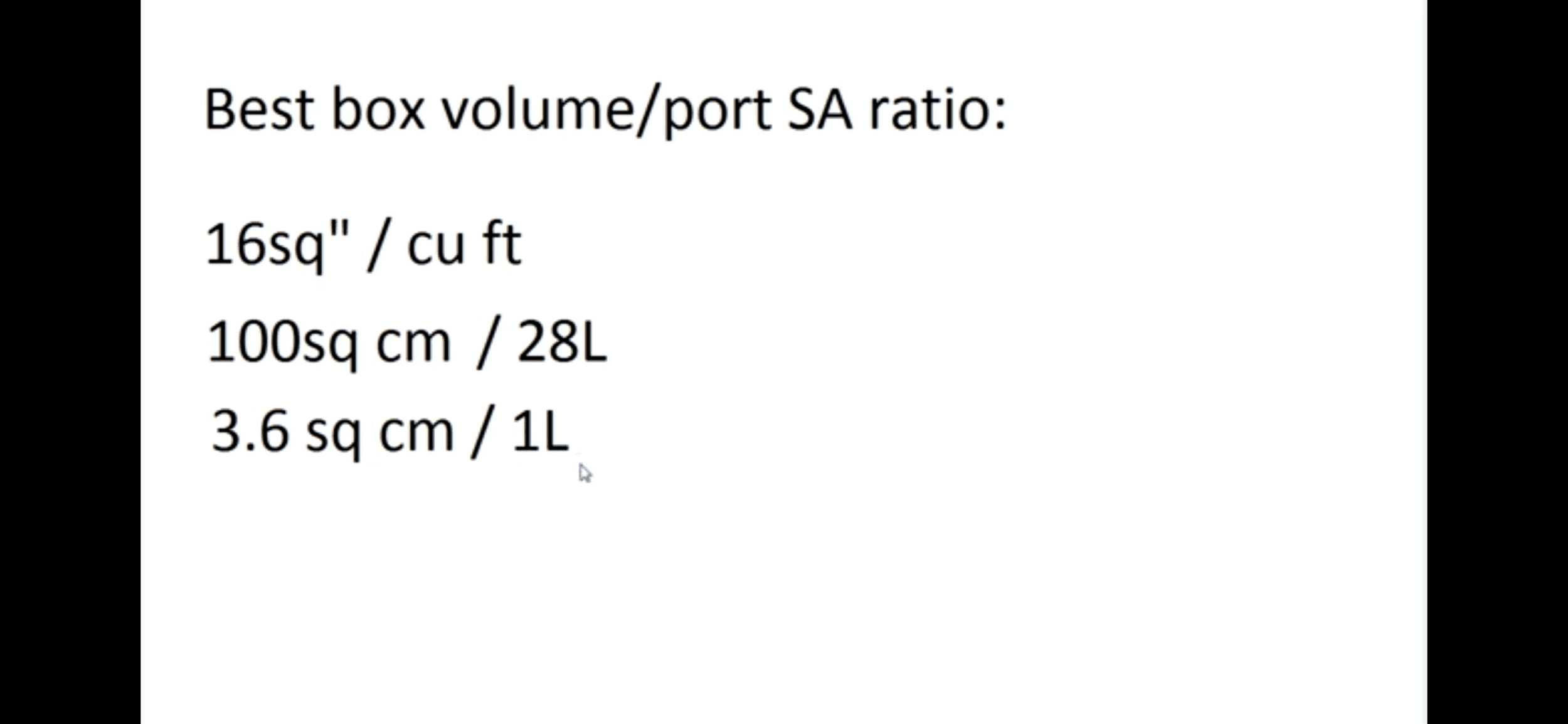

Their slot port is already bigger just by area alone. IMO, the 9.52 cu.in. sounds about right for an 8" 400 watts subwoofer. I found this somewhere a long time ago >
53 HZ is a very high tuning frequency for a music setup. 12.75 sq. Inches of port area would be fine for a slot port, but with a round port it will get too long to fit into the box without bending the port or letting it stick out of the box.. Round ports do not require the same amount of port area as a slot port. There is less surface area in the inside of a round port than a slot port for the air to interact with.
So with that in mind, 16 x box volume (.675 cuft)= 10.8. So the 2" x 3" port being 9.42 would be close.
