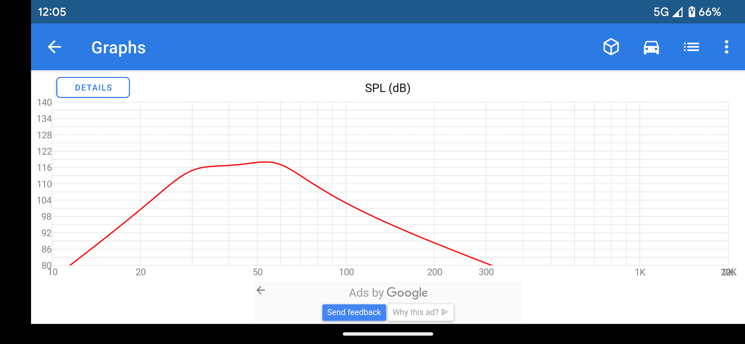

This is the 6th order I'm currently going to build.
1cube at 28hz and .75cube at 55hz two nvx vcw104v3 isobaric. Goal was the flattest response 30-65hz

My experience with free simulation software is that they dont do well with 6th order bandpass. I prefere tuning both ports while building the enclosure. Beside that, any imperfections is corrected with eq.
