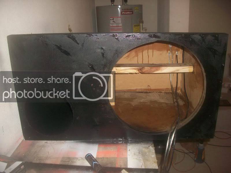

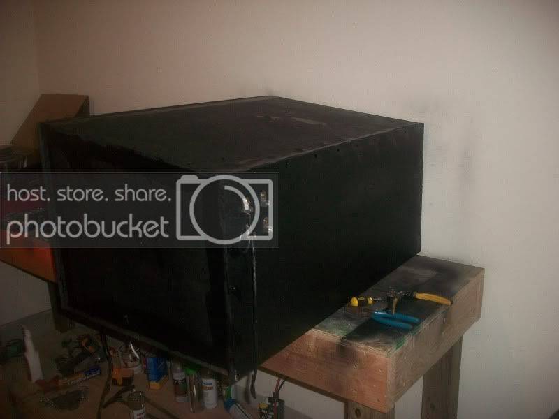

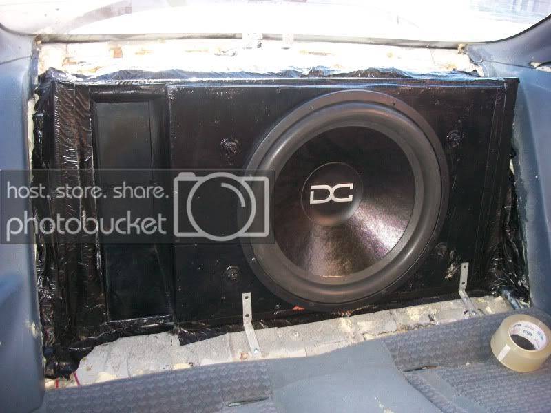

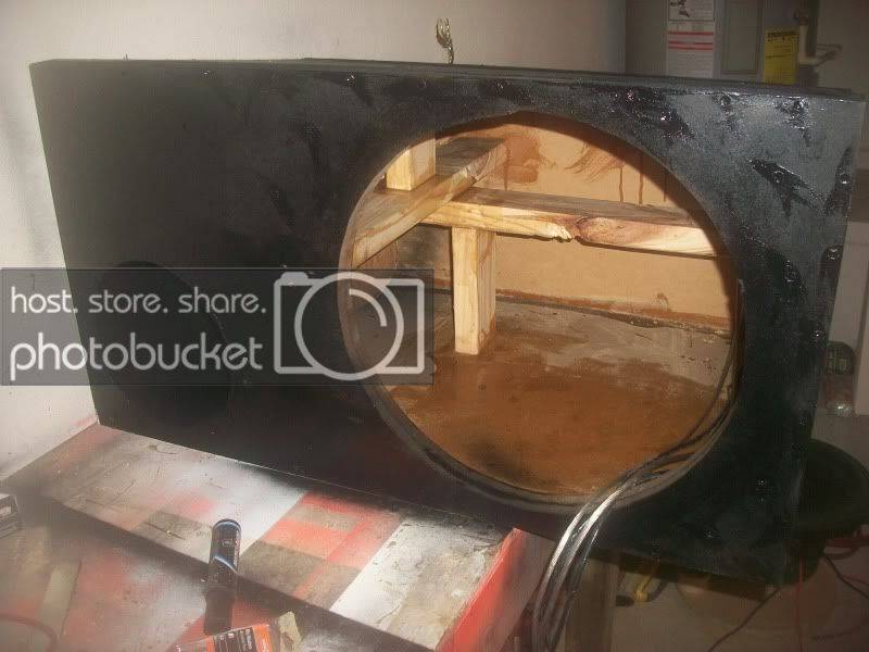

I WILL BE RECONING THE LEVEL 6 AND PUTTING IT IN A NEW BOX WHICH YOUR ABOUT TO SEE PICS OF //content.invisioncic.com/y282845/emoticons/biggrin.gif.d71a5d36fcbab170f2364c9f2e3946cb.gif
CURRENT BOX/SUB LEVEL 5 18 IN 5.5 CUBES TUNED TO 38

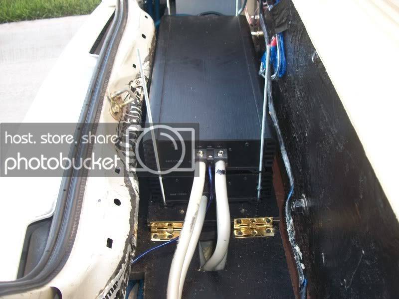

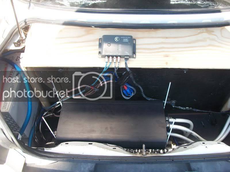

CURRENT AMPS

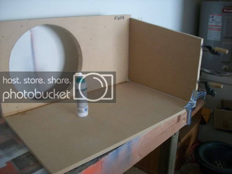

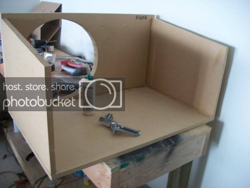

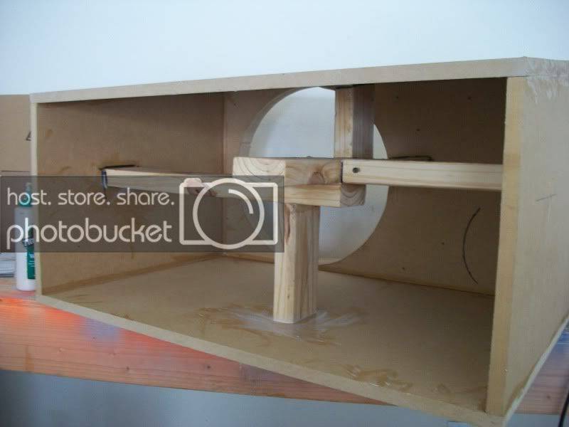

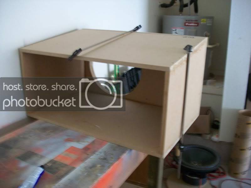

NEW BOX BUILD. IS 6.1 CUBES TUNED TO 33 WITH A 9 INCH SONOTUBE PORT

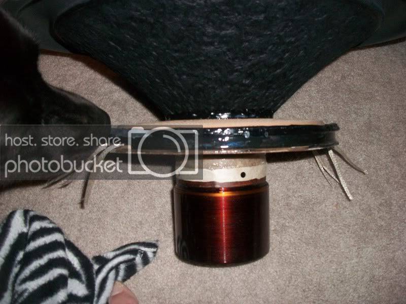

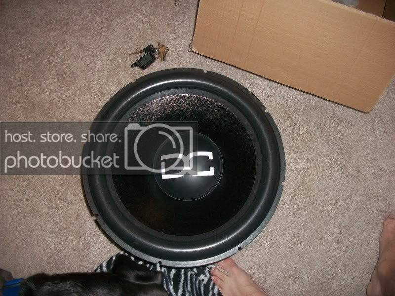

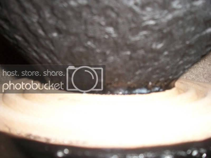

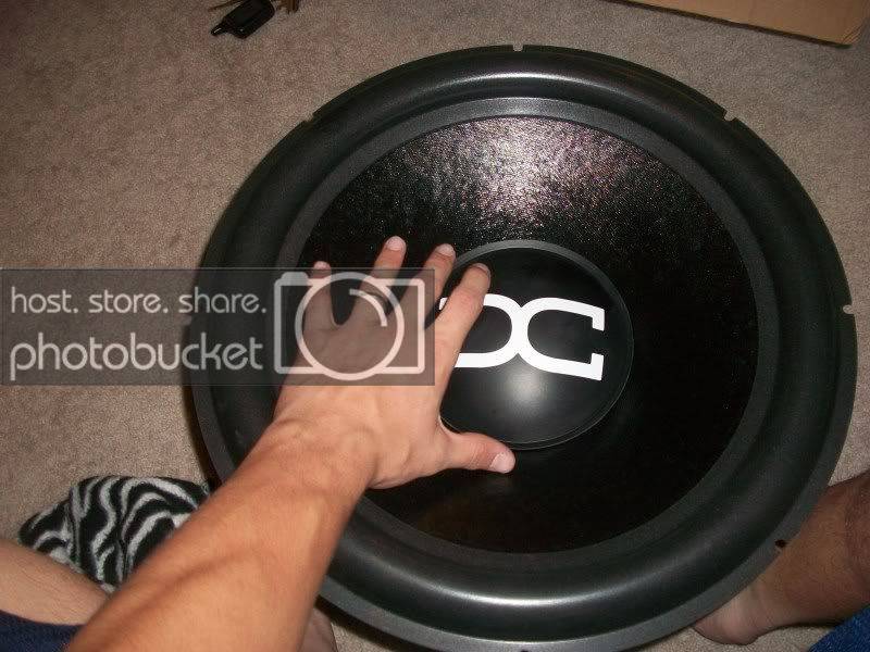

Got the Level 6 recone today!!!

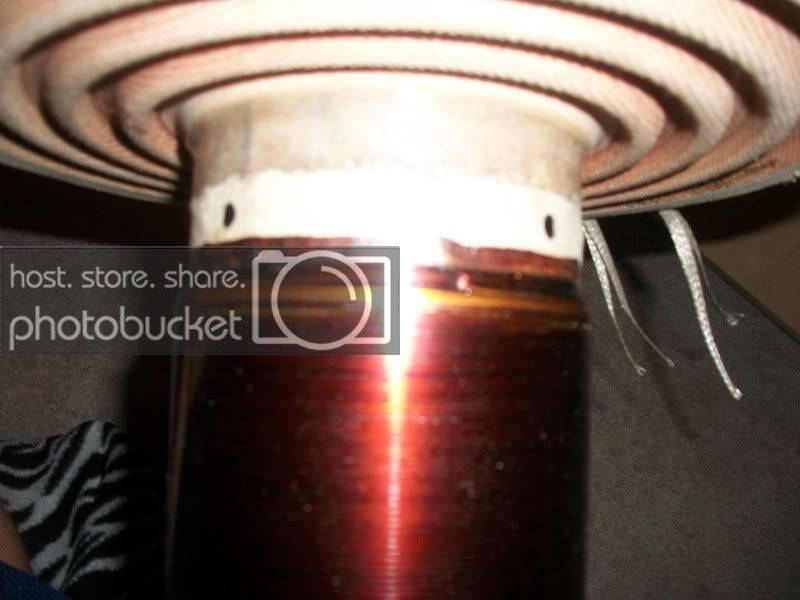

4 inch 8 layer coil.
extra glue spots on all the joint.
6 stiff 10" spiders
vented former
and a nice boob cone dustcap
and my 2 black labs just cuz they were nosey

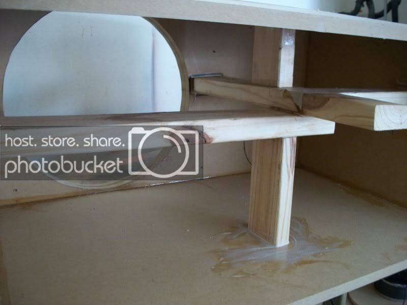

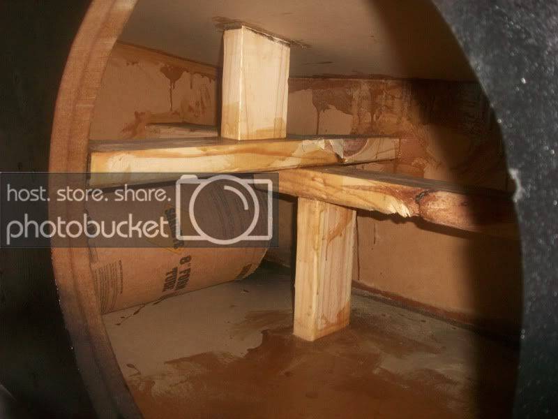

1) interesting bracing2) purdy dogs
yea thought id try the 2x4 braces for a change. gave me more airspace so that i could make the box wider without having to account for the allthread sticking out.
