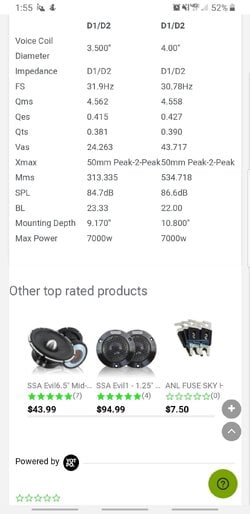

The sub I showed you the specs on was this one. View attachment 19009
I'm afraid that sub will laugh at 1,000 watts RMS and I'd really like to keep my power on the lower side, 1,500 total watts RMS or less, since electrical will start getting rather expensive for a 2019 WRX. Granted, I'm certain an alternator with two or three lithium ion 12v batteries would do the trick to beef up my electrical for music.
1. That ab requires double the power than that w7
My bad then. Maybe, look at the HD12d2 or HD15 for around $299.
