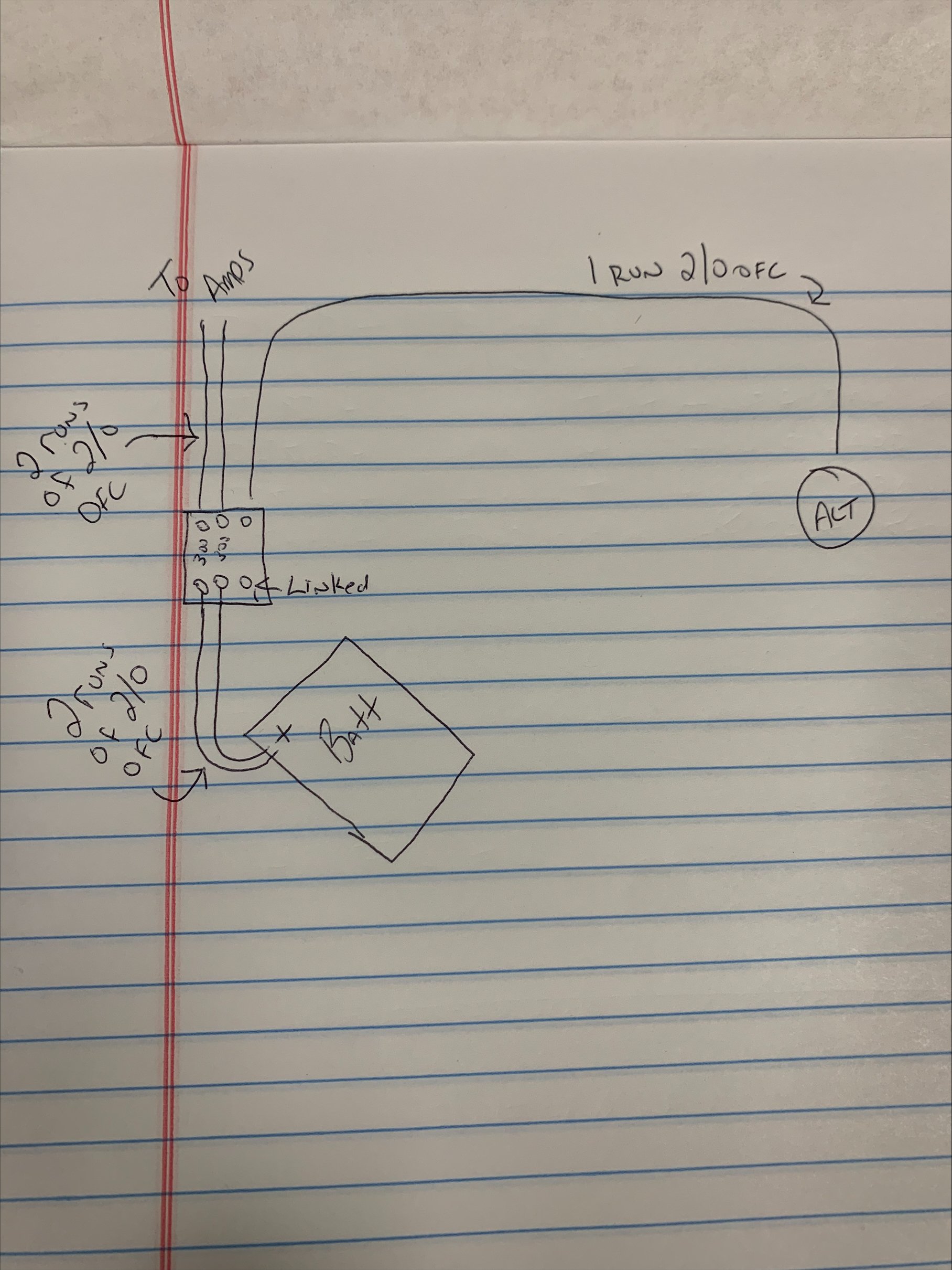

So for sure going to fuse this. I have my main fuse block going to the back with one slot open. Could i use this or will this need a seperate fuse block? I have attached a crude drawing lol. IS this a good idea or?

I wouldn't run from the alt to the fuse block, I would run it to the battery. There are going to be times where your stereo is off. Not sure where you plan on mounting it, but to the battery should be a much shorter and easier run.
Whether or not you want to also run it to the distribution block, I wouldn't. I can't give you a very knowledgeable answer as to why, other than what I THINK is unless that is a fuse block rated for all that you might cause problems, and you are causing resistance going through the block and then another wire before it gets to the battery. You might be creating a voltage issue. AGAIN JUST A GUESS, hopefully someone else knows.
I would look into that fuse block or contact the manufacturer if you need to, but that seems like a lot of amperage for one fuse block. Is that the knuconceptz block? Unless you have a solid metal piece of machined aluminum or copper, you aren't going to need two runs of 2/0 OFC from battery to fuse block. One run should far exceed the capabilities of the block.
Decide on your fuse size based on your wire's carry capacity...that way the fuse will pop before the wire fails...that said I didn't fuse between my alt and battery...

I am running a 3 way SMD fuse block in 2 locations. I have one next to the battery and one in the back on my amp board. Eventually i plan on adding some TITAN 8 batteries to the back.

On my truck (2021 Ford f150) the battery is on the passenger side and the alternator is on the driver side down low. This will end up being about a 10 foot run. That is what scares me about not having it fused. That long of a run attached straight to the battery or batteries in my case eventually.

The carry capacity changes based on the length...but honestly you should be fine without a fuse on your alt to battery...

While I do always promote using fuses, and still do for the main run(s), I also skip the short length alt to battery fuse on my own vehicles. I do use loom and make sure it isn’t rubbing on anything, and doesn't hurt to inspect it periodically.
Technically, the 2/0 from alt to battery, should be fused right by the battery with a 400A fuse and is a good idea to do so.
