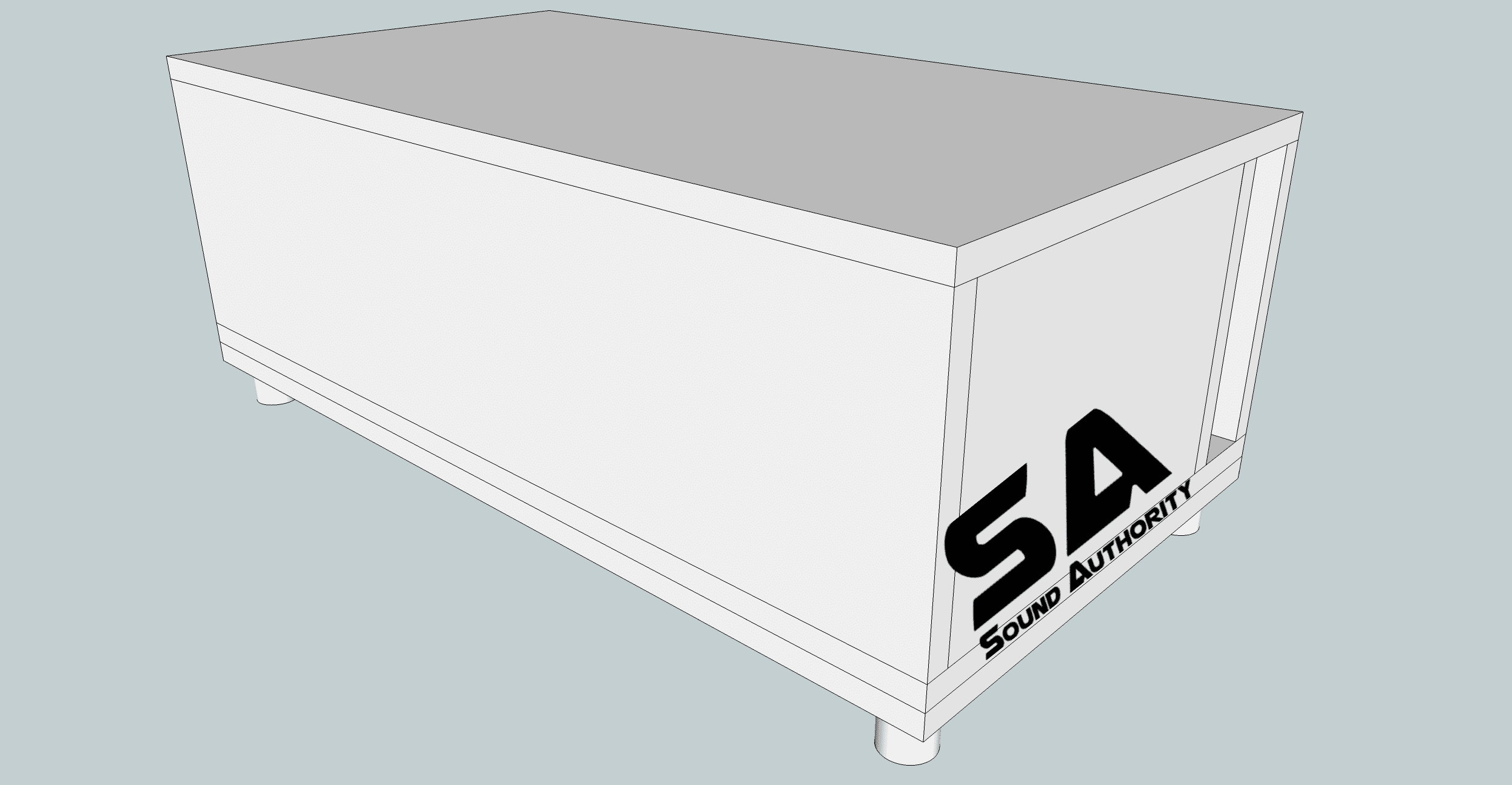

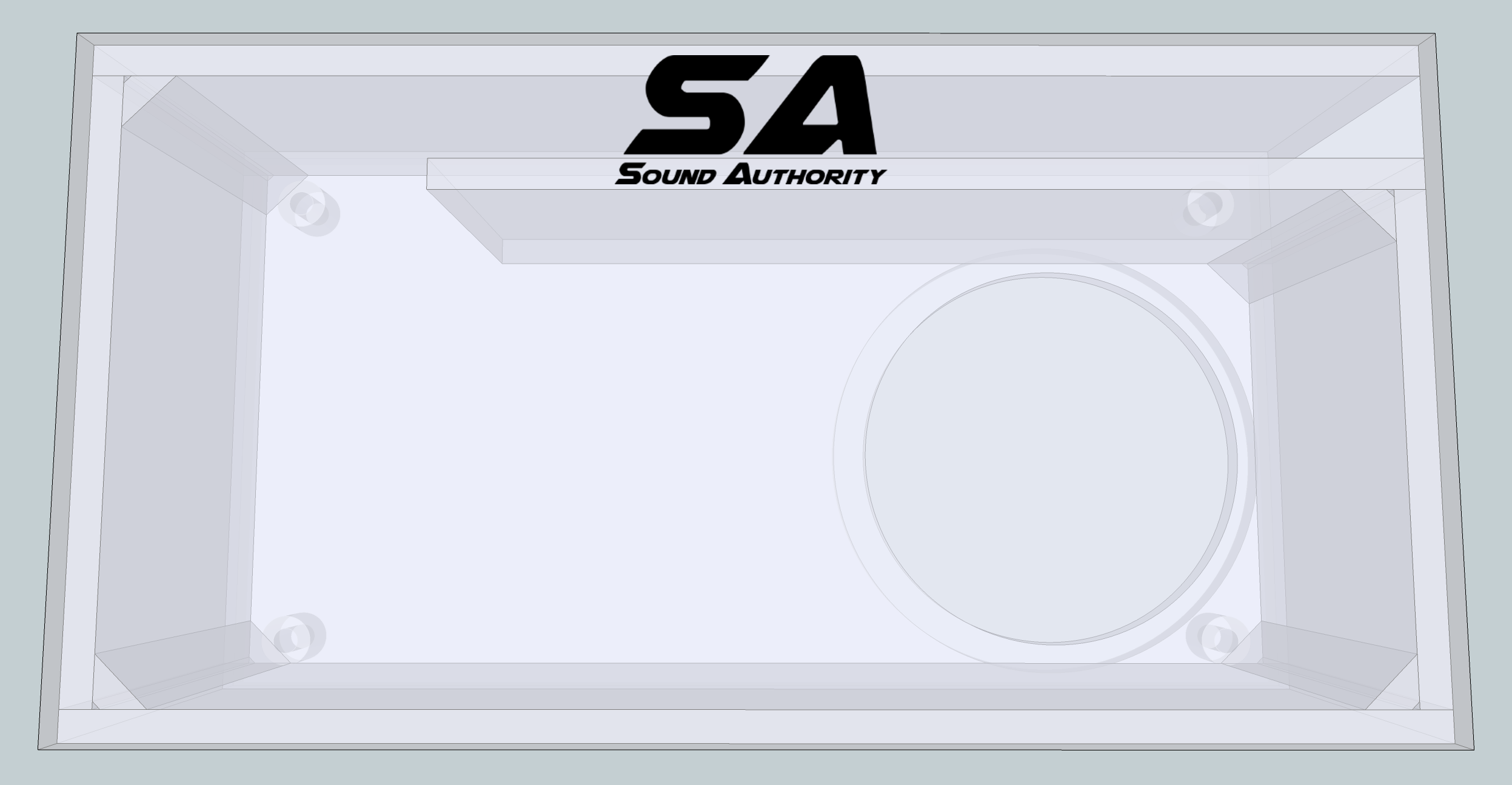

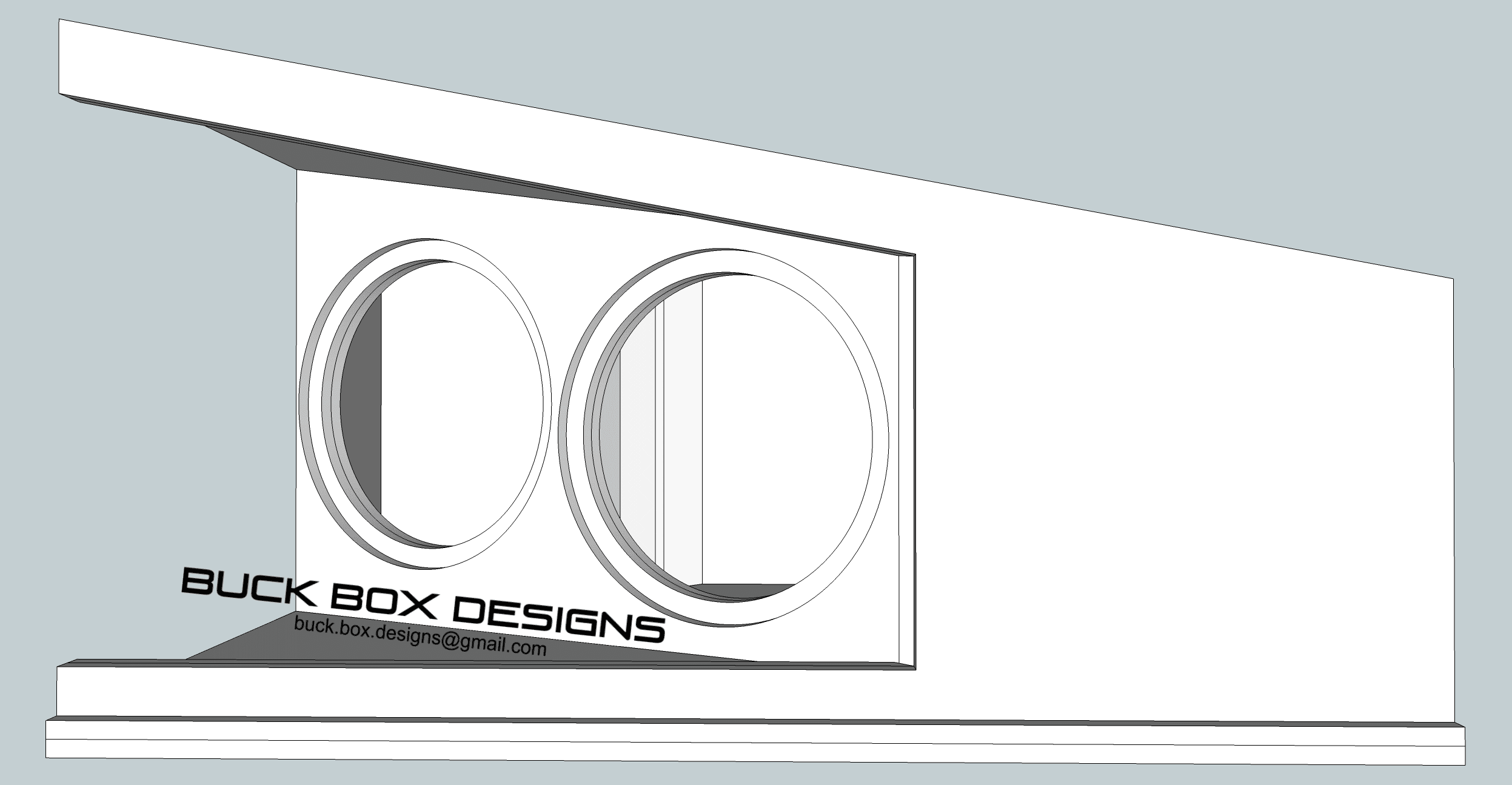

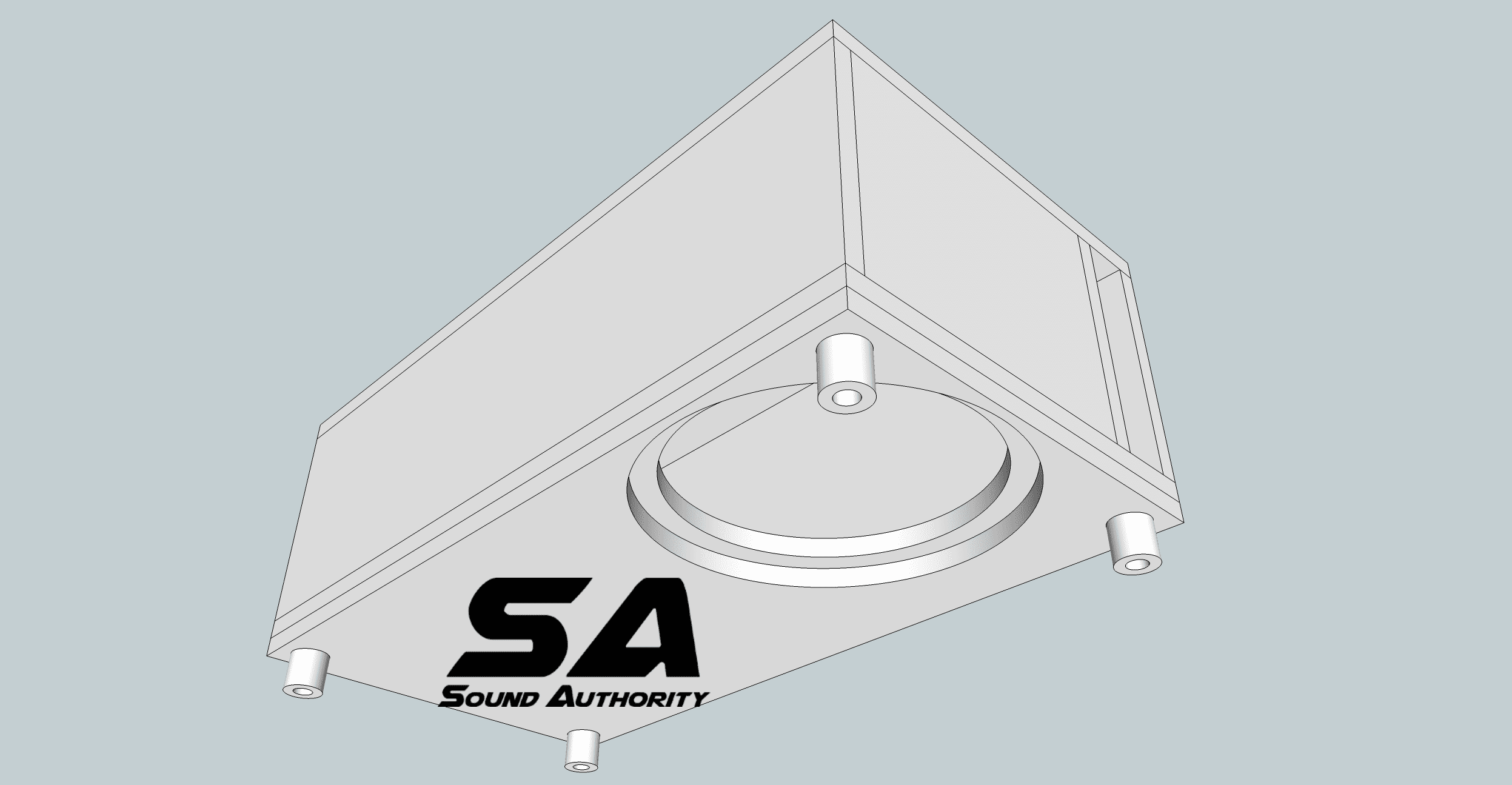

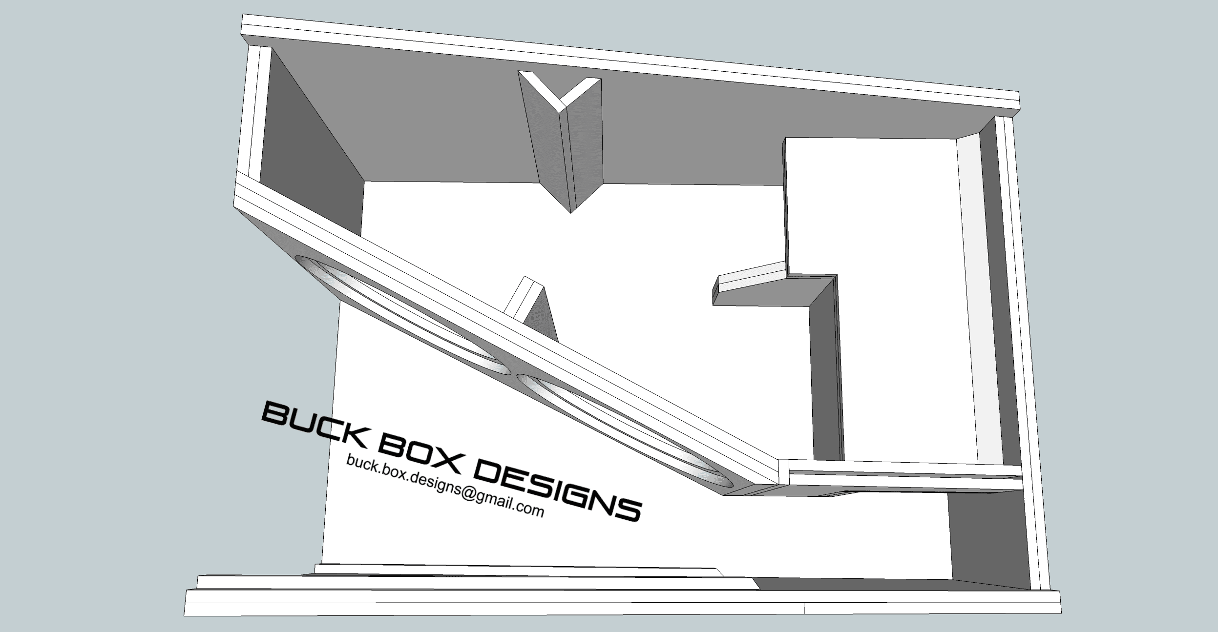

2 Digital Designs 9918 esp's going in a small 2 door coupe in a B-pillar wall. This box is not much smaller than the car itself. This will be on lots of watts, at least amps rated for lots and lots of watts. The amps may change over time, but the wattage rating, iirc, is 16,000 watts. It's tuned very low, as well. Goal is very loud low bass and extension of bandwidth up as high as possible. These 18's weigh about 90 pounds a piece, and they are ~12" mounting depth. It was difficult to find any layout that would work. I couldn't help but do this like I did it. The shape of this shell spoke to me.
