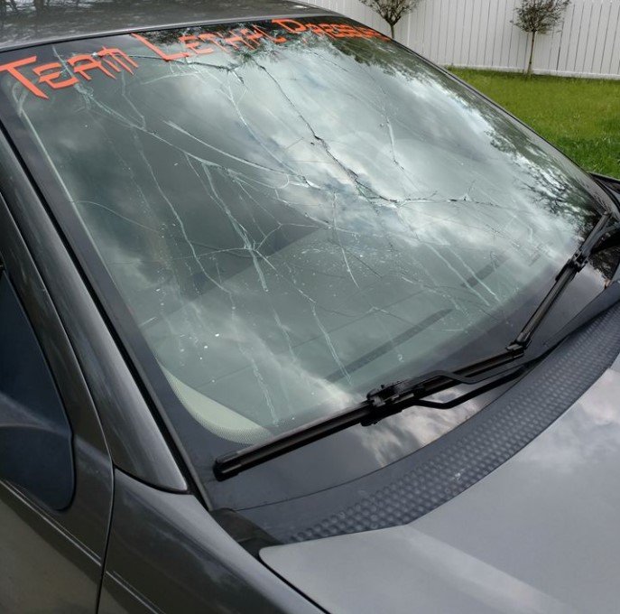

Bustin Windows only 130DB?!

Was probably already cracked then the flex caused it to crack more. Took me over 155 to break my windshields.
Looked into Isobaric enclosures.
Scientifically proven to increase SPL, and VAS.
Though the cone area is the same, the (movement of air) takes less power and effort = Efficiency.
The reset is also quicker; The other sub is pulling the sub to reset = Efficiency.
So basically the conclusion is the Subs we’re able to crack the front windshield probably because
- Super Efficient.
- Super SPL.
- Super VAS.
Plus dual (4) Neo.
Still I’m pretty sure he said 130DB.
Possibly proof you don’t actually need that much DB to crack a windshield.
That crack is forming because there was already a chip there in the glass. Isobaric mounting isn't magic and is expected to be less efficient than the same number of drivers mounted normally in sufficient airspace.
