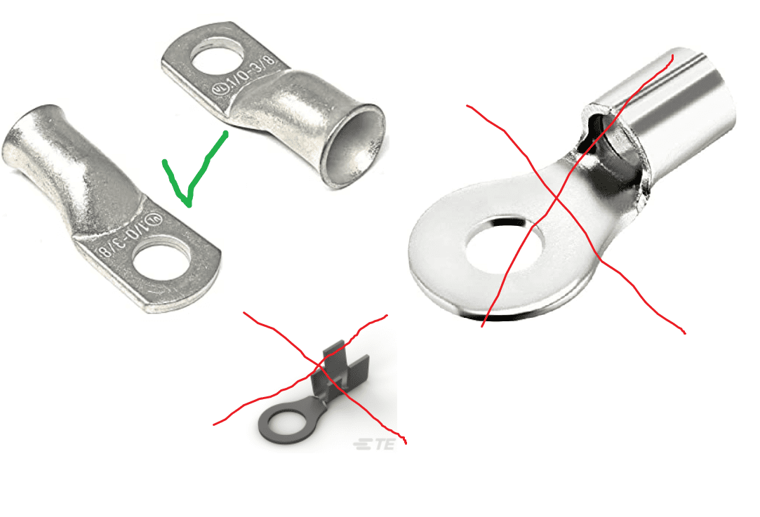

If you do that, make sure you use really high end ring terminals. You don't want a 0 gauge wire flopping around in your engine bay if the wire comes off the starter.

Things under the hood go through many heat cycles, and I wouldn't trust just a regular cheap 0 gauge ring terminal for years and years on the starter. That's what I mean. There are different quality ring terminals, for sure.

Only concern I would have is making sure the terminated ends of the wire are sealed well. Heat shrink is usually sufficient. I know here in Iowa, exposed copper wire on a cheap wire terminal would corrode quickly on the underside of an engine. I would definitely use a lug that's sealed on the end.
