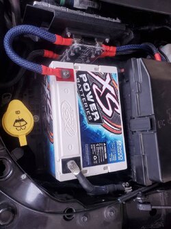

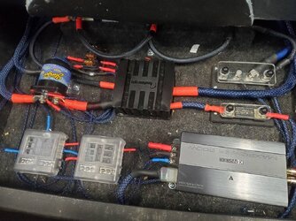

Upgraded my fuse block. One goes to the cars electrical system, the 1/0 goes to my bass amp and a I added a third run for my dsp/6 channel amp while I was st it. Figured it was easier to run it now than later. Took me a while to figure out where to put it but I am happy with the end result. 20190516_022130.jpg20190526_113202.jpg

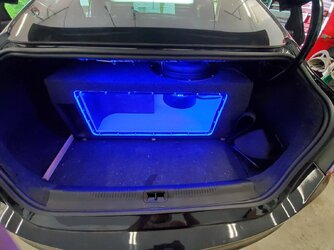

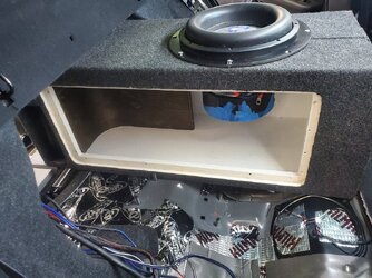

Got the box in, didn’t go quite as planned. The box fits but since the sub is designed to go in the top, I had to slide the box in through the trunk then i had to remove the rear seat and slide the box into the cab. I then installed the sub with the box part way in the cab then slid it back and i had to compress the sub to get it in. This was not exactly what i had in mine. Since i had to remove the carpet from the trunk in order to do this. I now needed to pick the box up to get the carpet in. So i used ratchet straps to pick it up and slide the carpet back in. 20190527_114447.jpg20190527_115713.jpg

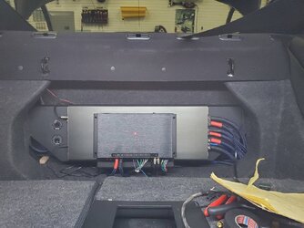

I decided to follow the advice of some people on this forum and deleted the rear deck speakers. Right now i am still wiring things up. I forgot to take a picture of the amp rack. i will do that tomorrow.

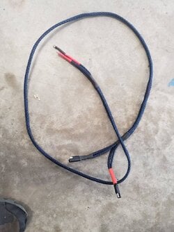

I added battey tender hook ups to my trunk. I had to do two because i have an idolater. I decided this was the easiest route instead of activating the isolator. That little fuse box by the idolater is for the battery tender.

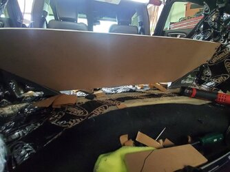

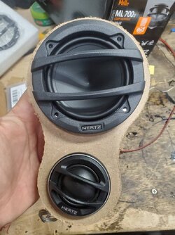

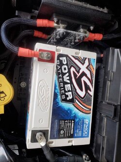

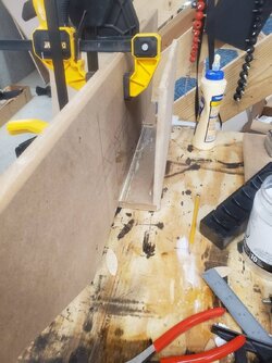

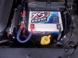

I also upgraded my front battery ground, i just didnt like the looks of how i had it ran before. I also started making stuff for the a pillars. 20190605_115116.jpg20190605_130437.jpg20190605_115851.jpg20190603_113321.jpg

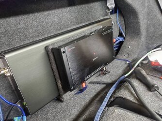

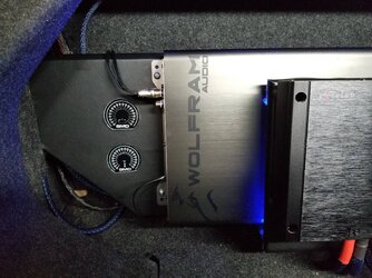

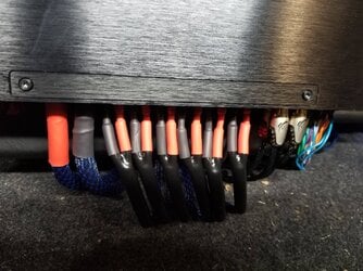

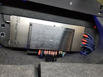

been busy, I redid the amp rack for a couple of reasons. 1, there wasnt enough room between the two amps so the support of the kenwood could hit the wolfram also i wanted to wrap it in vinyl.
Here it is i have some wire clean up left to do.

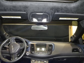

I hired a local shop to build my a pillars. I am happy with the results. I also finished hooking everything up and running the wires.

Thanks, working on learning how to use the audio frog RTA and get this thing tuned correctly. i want to do something to hold the power wires for the map and keep them spaced evenly just cant decide on a good design I also need to make a cover for the sub box.
