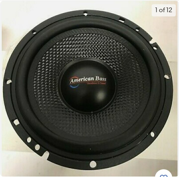

Those Silver Flutes look like home theater subs not midbass speakers. I guess if you have the mounting depth they will work. I still liked my AB VFL65MB's. I don't think they make them anymore. 100-3K. Sensitivity is high 103.5. 1-½" voice coil.

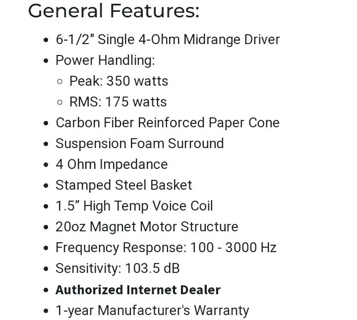

Those American bass look fine and while they are rated at higher power I have 0 issue running 125w to these 80w silverflutes and plan on running 150-200w in the future. What amazes me is the cost per mid. $30 is cheap as hell for the performance you get

Sensitivity? How loud are they?

And sensitivity doesn't really matter much when you have ample power to play with. Its 91.5db for reference. It gets plenty loud and I don't expect a single pair to produce midbass and keep up with 2 big 15s. Once you get into the higher pressure systems your subs generally overtake all your midbass anyway. My more modest systems most midbass drivers can keep up with very well and I can cross my subs lower. Generally I cross both my subs and mid at 63hz. And I still don't have a gaping hole at 63-100hz like most systems.
They are still plenty loud and if I cross them at 100hz like your ab mids I can feed them alot of power safely. The 1.25inch voice coil should handle 200w just fine as long as power stays clean and it's not bottoming out from bass
