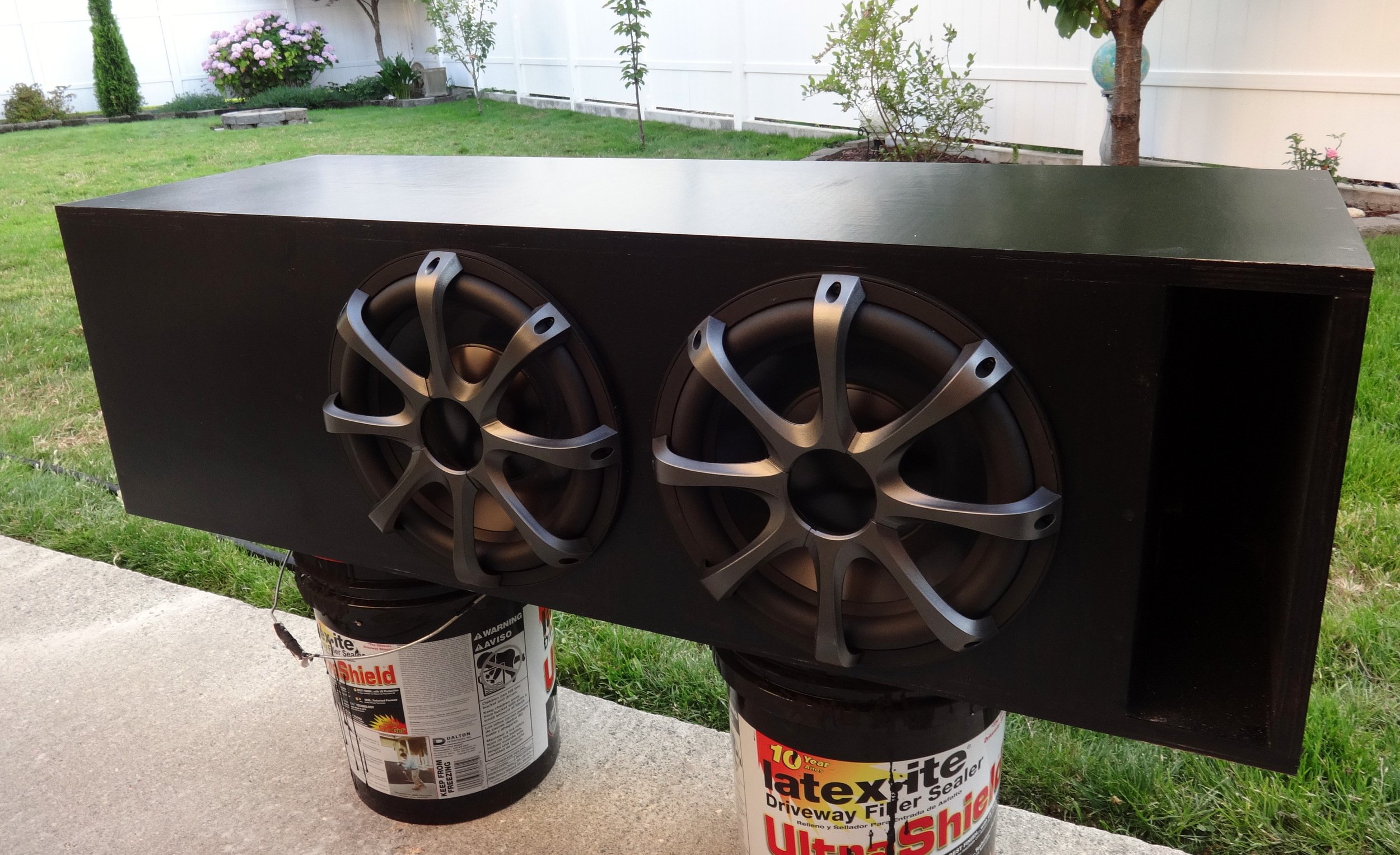

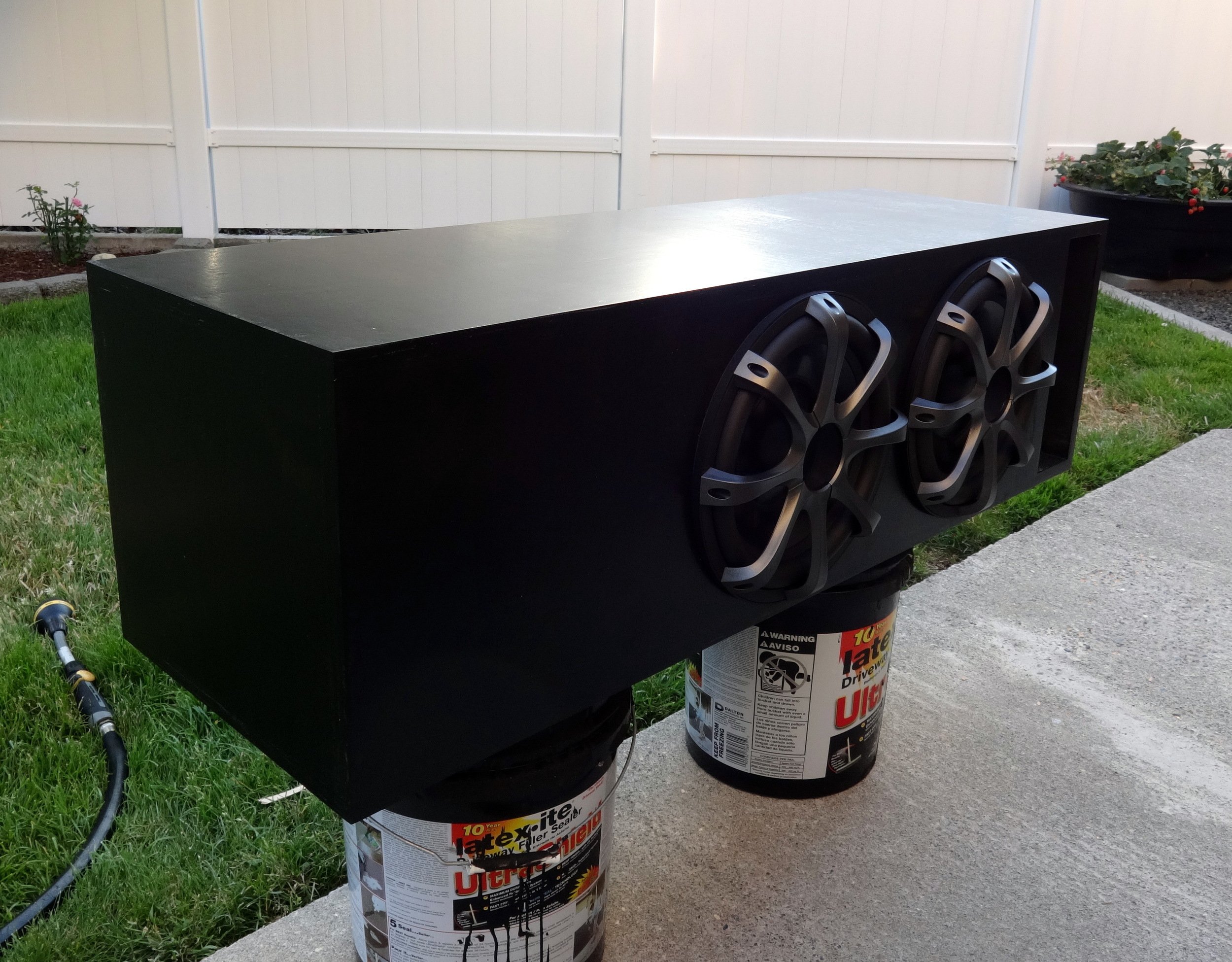

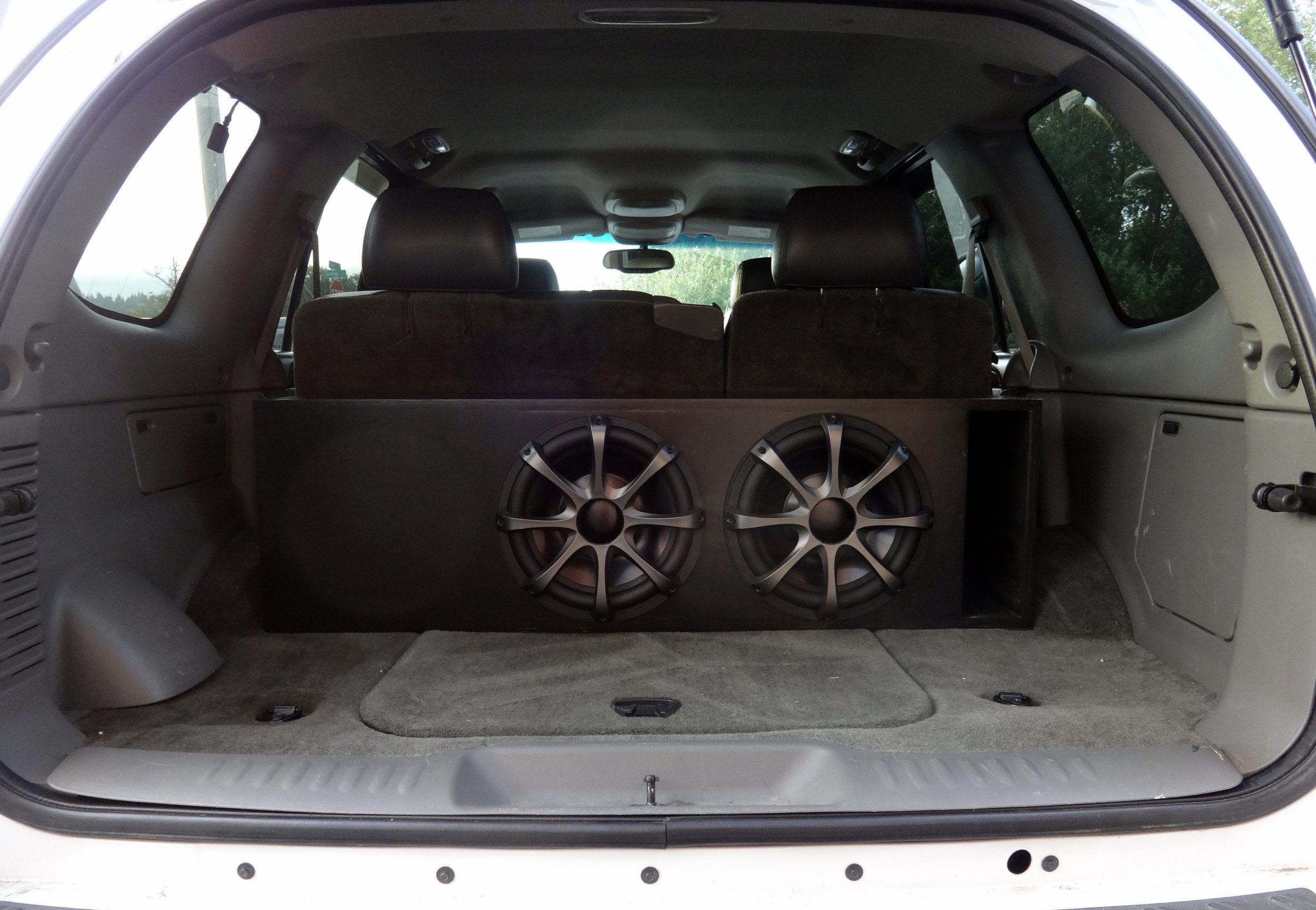

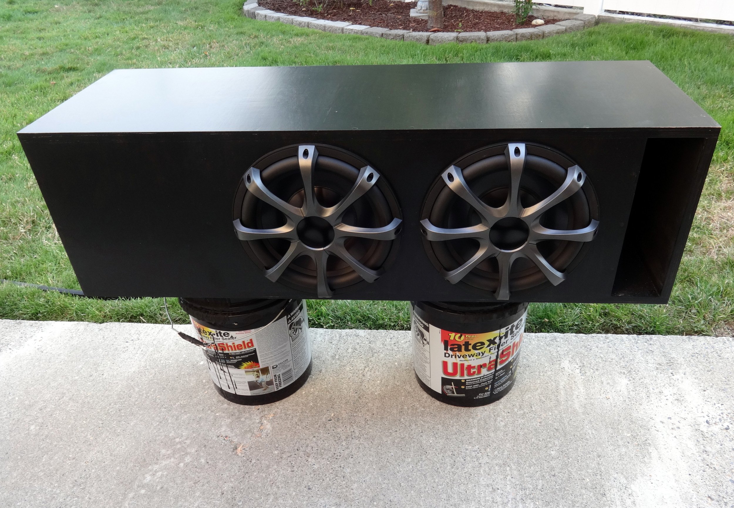

Messed up the 2nd baffle and didn't have any pieces of ply big enough, so for now it's a single. Tried some new black gel stain and some water based poly and got decent coverage but there is few flaws.
Also threw some Kicker grilles on them too.
Only listened to a couple quick tracks but I'm honestly pretty happy with what I'm hearing. Kicks are super tight and clean with a good thump you can feel in your chest and lows are very present and clean not bloated or muddy in the least..
They Crush the 10w3v2's I was running prior so it was a worthy upgrade.View attachment 41353View attachment 41354View attachment 41355View attachment 41356
Man Looks Badd Azz for sure!! If you notice any issues with the subs hitting the grills.. You can get a small bag of washers and use like 3-4 to move the grills out a bit on ea Screw. I had do that a couple times with some subs using protective grills. Have you tried turning those subs up port Up in there yet?/ It sounded and performed better in my old CRV. Looks Awesome though man.Nice!!
