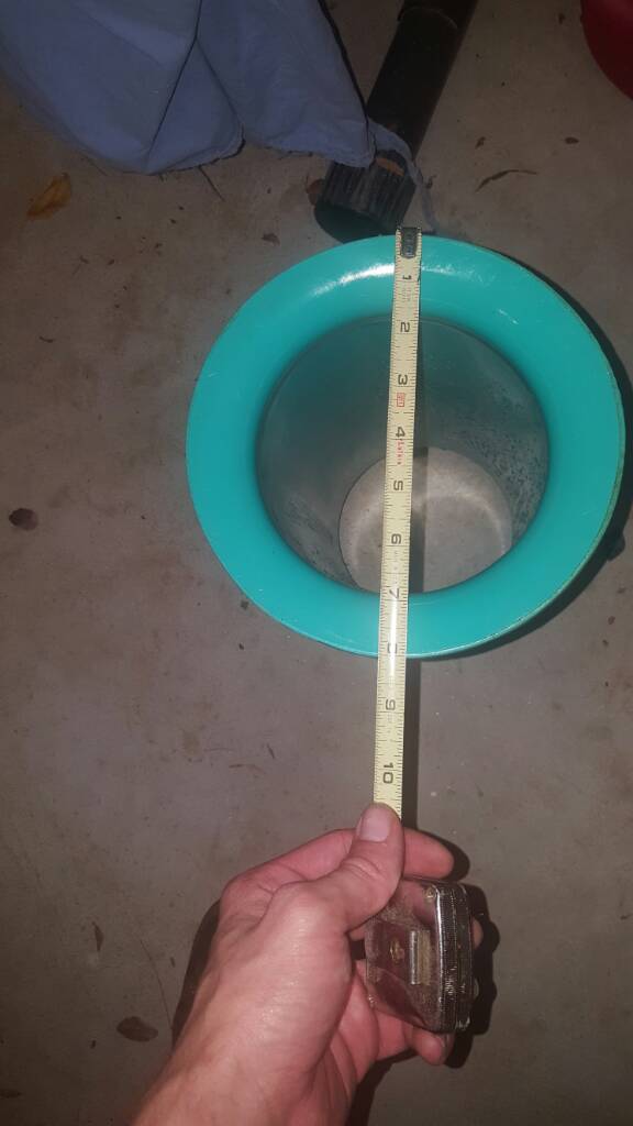

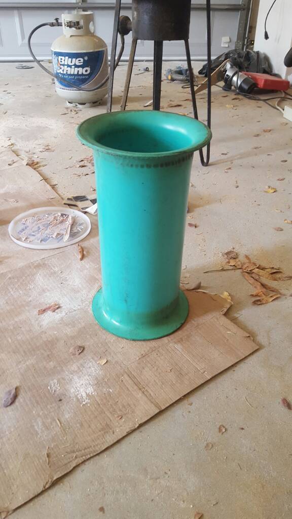

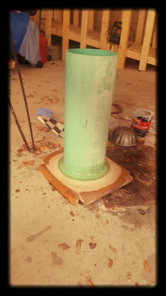

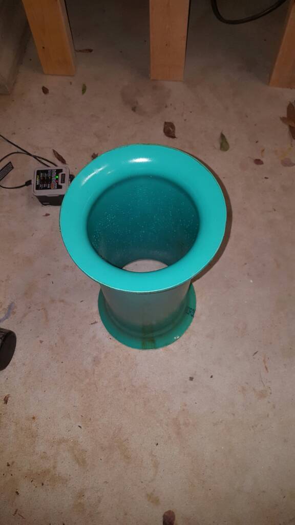

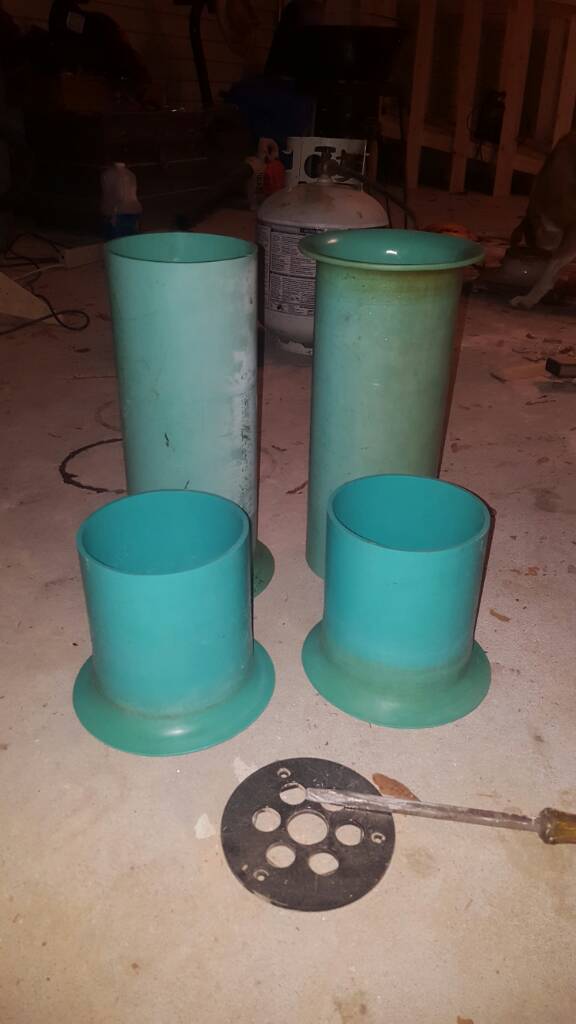

Here's some adjustable aero's I made using a fish fryer and a jig. I also made a jig so I can make my own couplers. They fit tight enough to seal, but you can work the port tube out to change them out. If you do it, grab some bondo and cut some circles out of mdf to make a jig. It's worth the extra time.

This is my what I'm planning on doing exactly, minus the fish fryer Lol A+ on creativity!! Those look awsome
