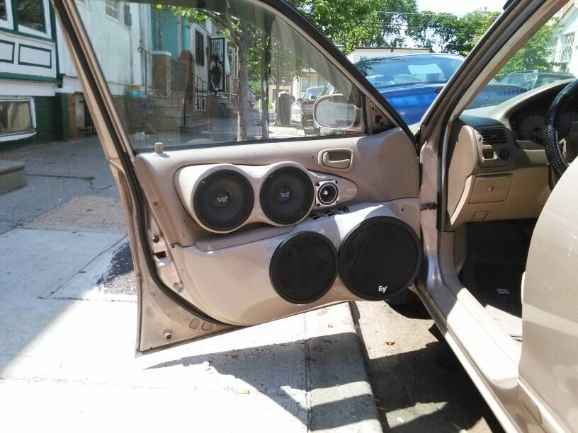

these the one i made for my 98 corolla

How are you guys mounting them to the door panel...
Sent from my SGH-T999 using Tapatalk
Mine are just screwed from behind the door card at the speaker and one in the middle which is an origional securing hole for the door card....
