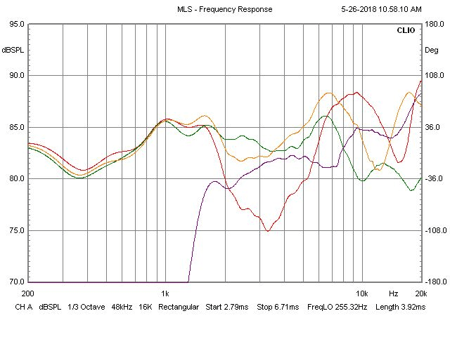

a little glimpse of the chaos of what actually happens with soo many drivers playing the same frequency with different inherent tweeter design, tweeter size and moving mass, resonant frequency etc.. You need to learn more about electromechanical parameters of speakers and how it actually affects the sound vs reading amazon reviews aka the same reviewers that say "oh these boss phantoms blew out my windshield"
