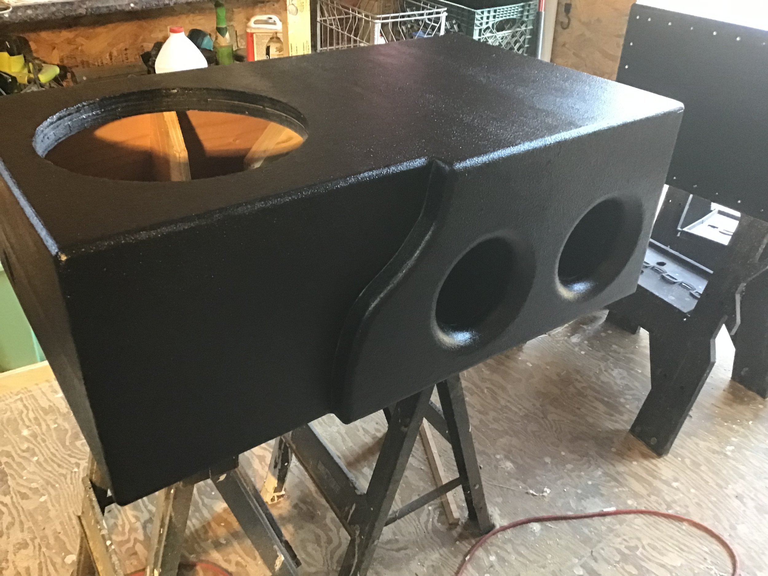

I use iron armor from harbor freight. 1 gallon is 65$ I think. I use black oil base paint first, then the bedliner. This one has 1 coat black paint and 2 coats of bed liner and it’s been pretty durable in my suv. It covers quite a bit of flaws too. I didn’t do a superb sanding job and it still covered ok

Nice box. I have some Duratex on hand, it's just to cold or i would use it. It's only a couple of bookshelf speakers that I can spray in the garage real quick and move then into the house to dry, a lot of work to roll it from a 1 gallon canister that is inside and hasn't been opened yet. Just being wintertime lazy!

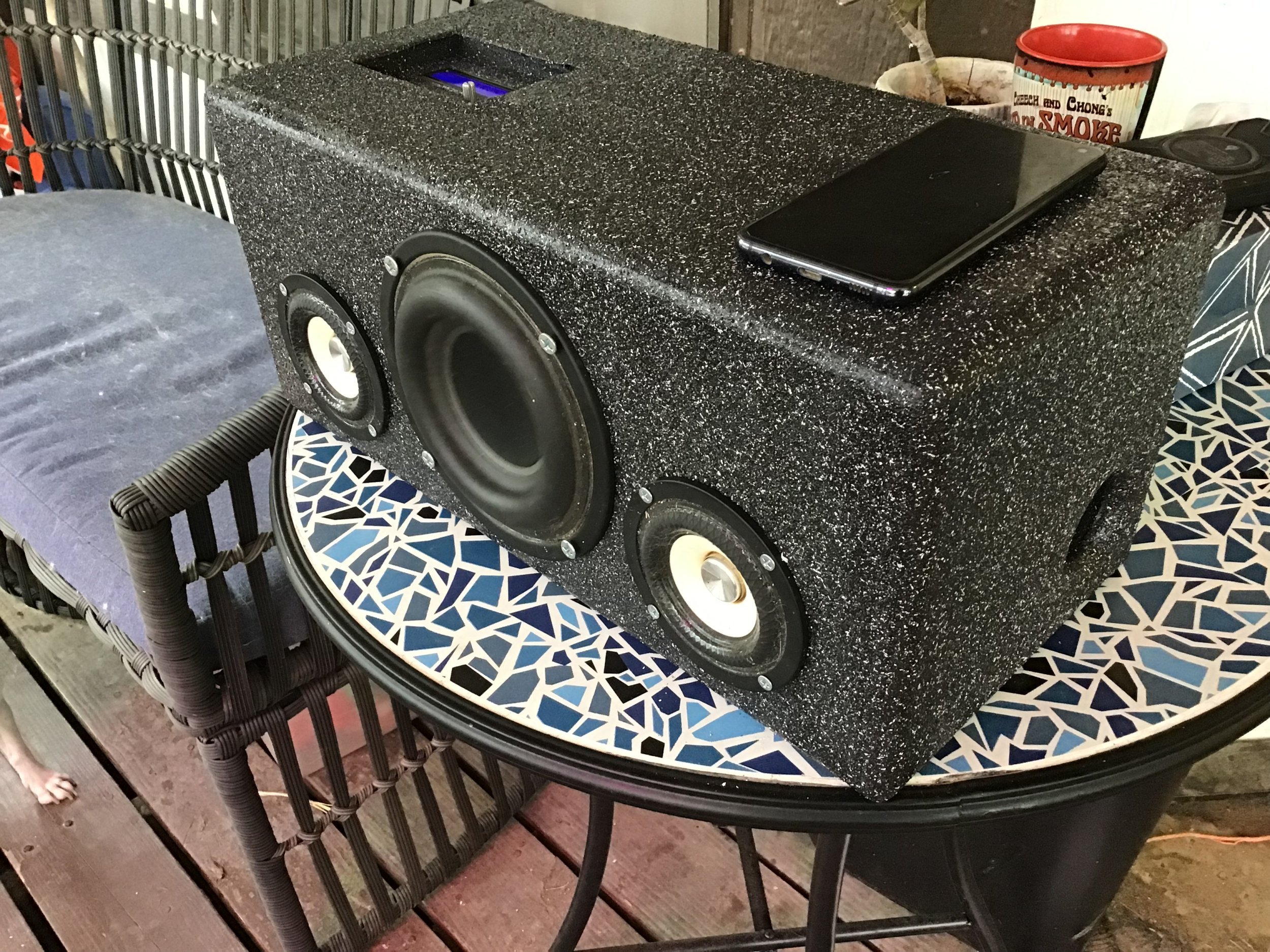

I did my Bluetooth stereo with some fleck paint. I think it’s called Stone Creations. It comes out nice. I’ve used it on sub boxes also. You’ll need a clear coat on top to make it a little durable,
