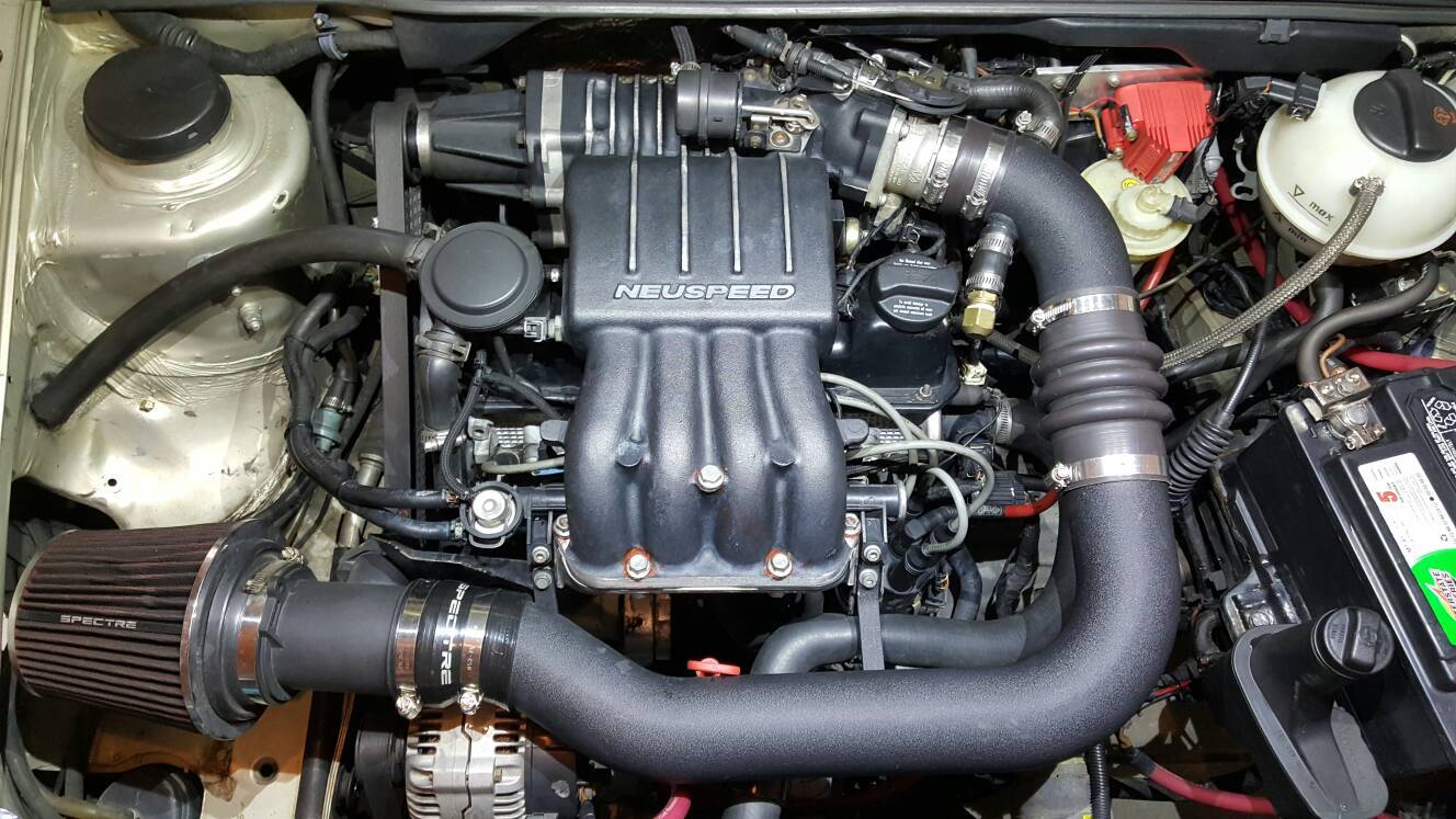

Hi all im currently pushing 1200w rms and will be upgrading to 2100w rms and i still only have 90a alternator and single acid battery up front. Big three is already done. My issue is that i tried to intall a HO alternator but i cant because i have a supercharger kit and an idler pulley is attatched to the alternator. The HO alternator does not have the mounting hole for the pulley so i cant use it. Can i get away with extra batterys in the back untill i buy a different car that i can put an alternator in? Im not sire what to do. Any advice?

I have an idler pulley that is not a factory pulley attatched to the altenator housing for my supercharger. The HO alternator does not have the mounting hole i need. It simply wont work unless i took my supercharger off and went back to stock. Ill take pics later tonight.

95 vw jetta nuespeed supercharged.

Why can't you add the mounting hole on your h/o alt for the idler pully
I'm sure a shop would do it for a hundred bucks or so

Its an aftermarket supercharger and the idler pulley is not factory i added it in to get the correct belt tension on the supercharger. The HO does not have the same flange i can drill into like the factory one.
