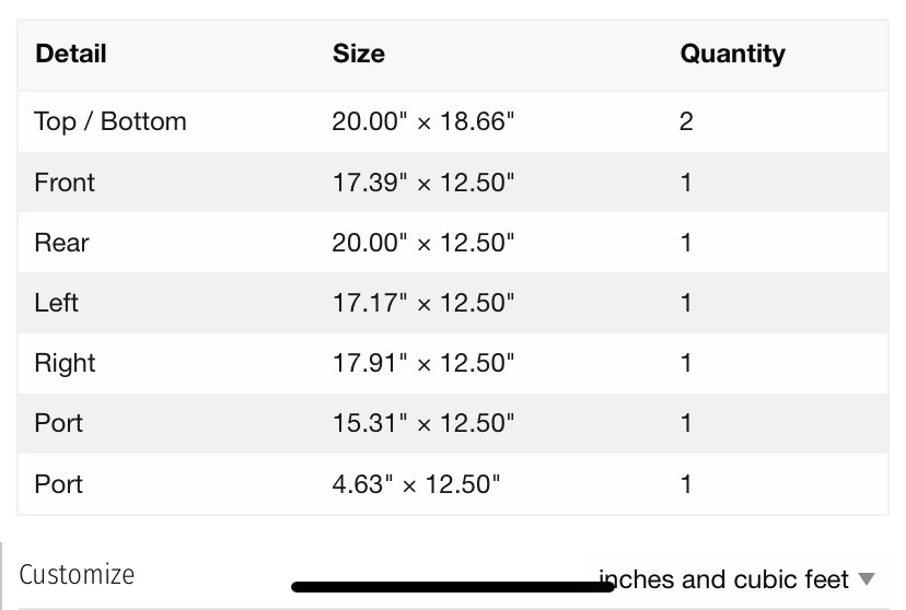

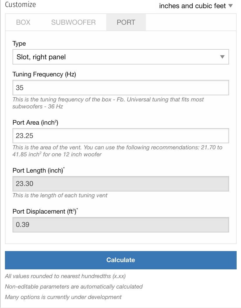

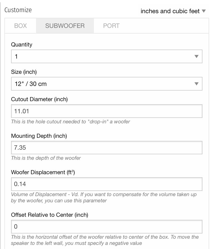

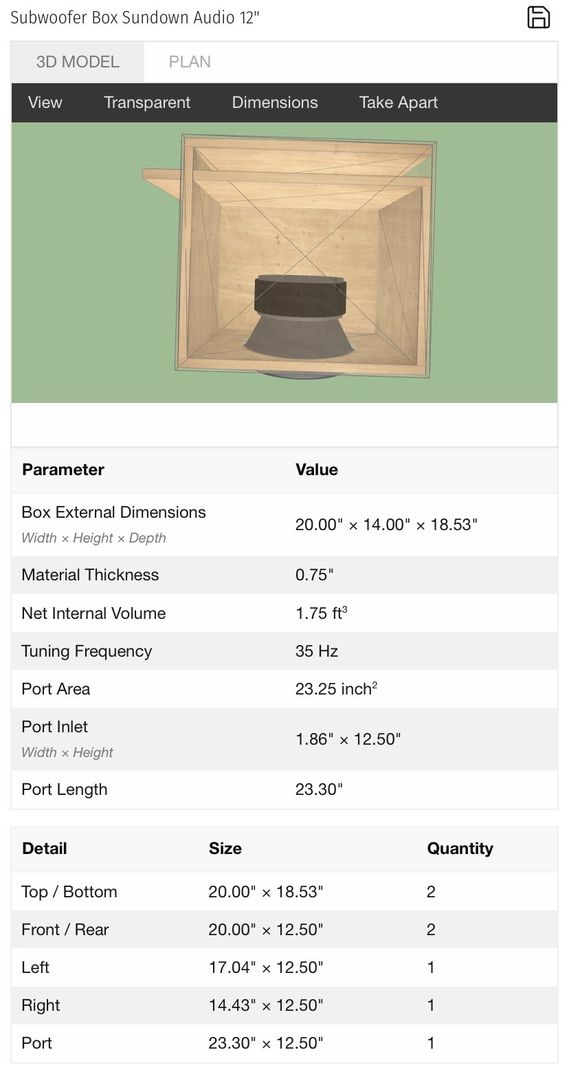

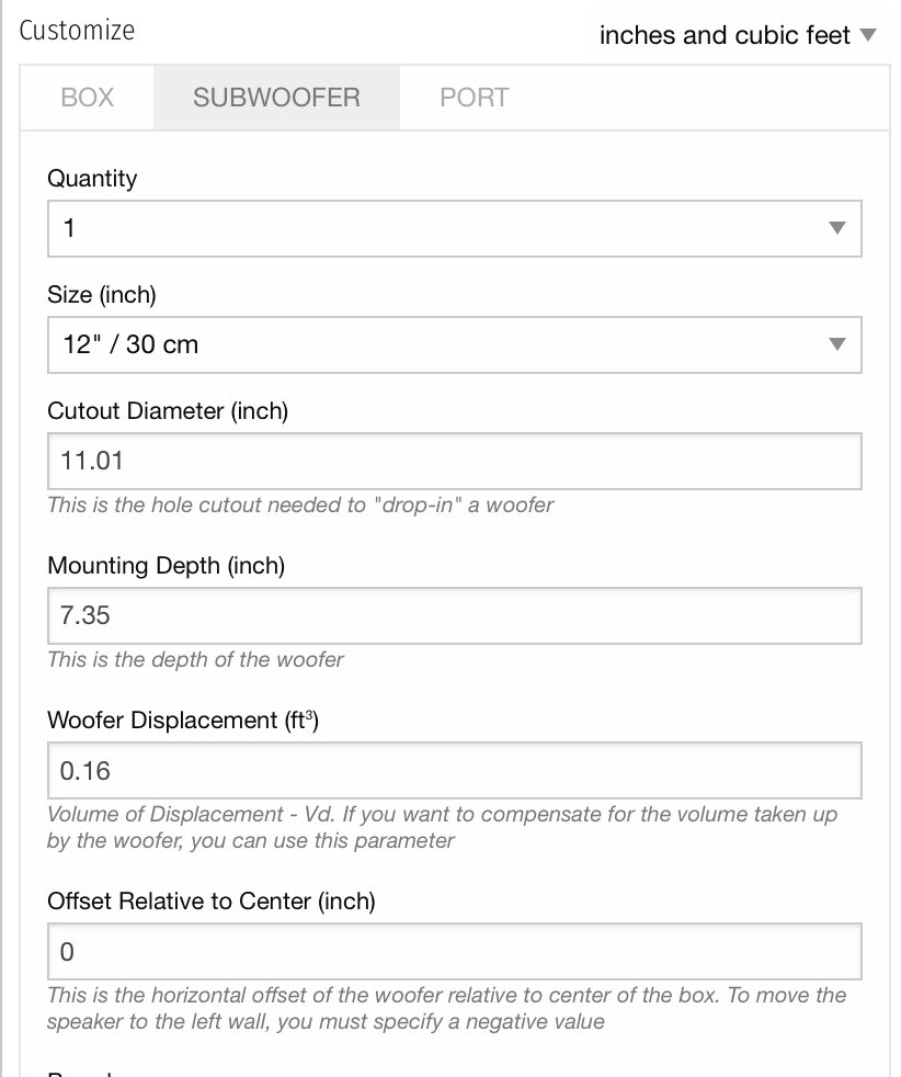

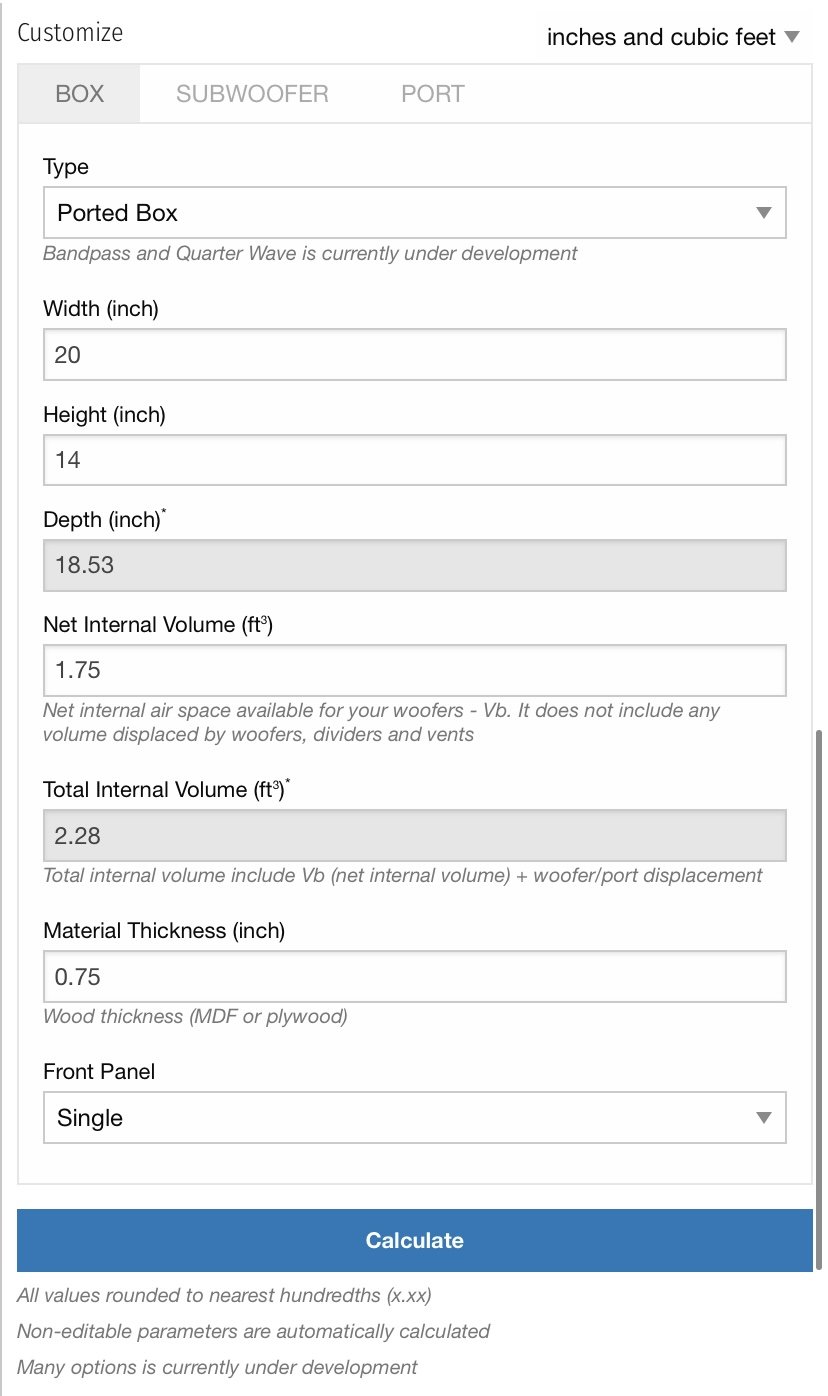

Attached are some screenshots of the design I came up with for my oddly shaped trunk. I appreciate any feedback!
I’ll be running a single SA12 v.2 D2 on a Kicker CXA1200.1@1 ohm.
The only things I wasn’t sure about are the exact driver displacement for that model (I used 0.14, which is listed as the displacement of the v1); and whether to tune to 35 hz (listed in that sub’s box recommended specs) or 32.75 hz (the specific enclosure design for that driver on their site).

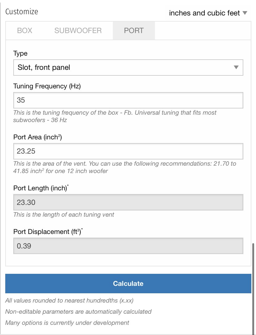

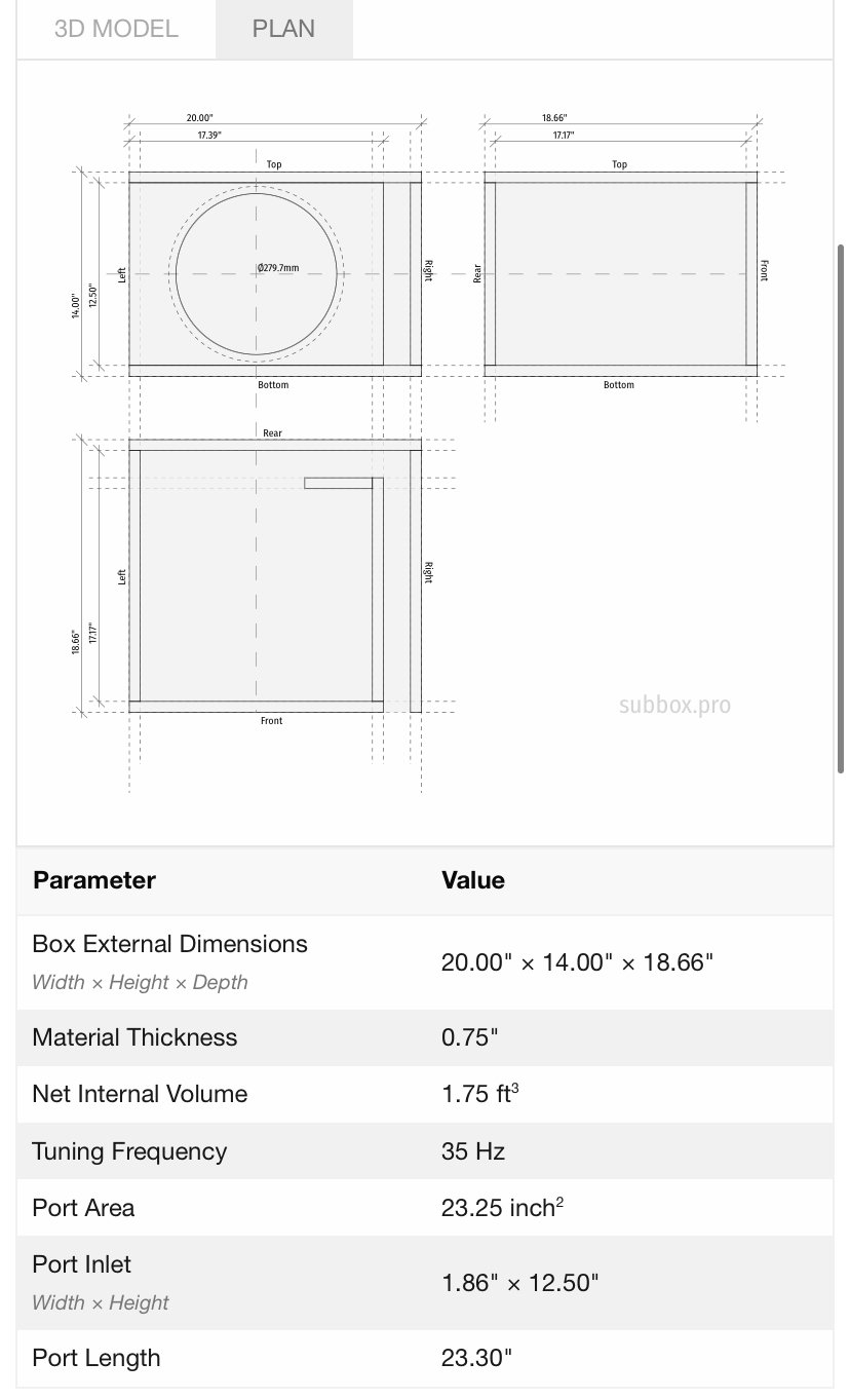

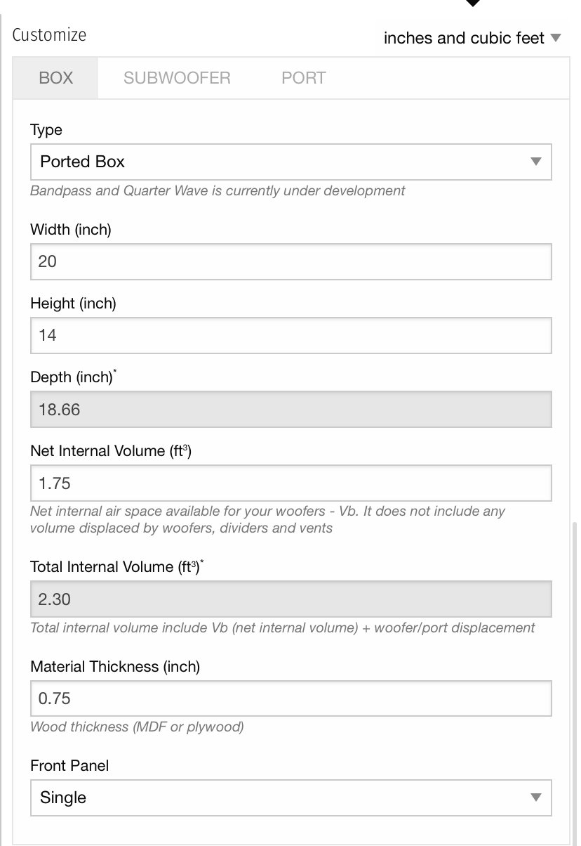

I’m an idiot. New screenshots attached
