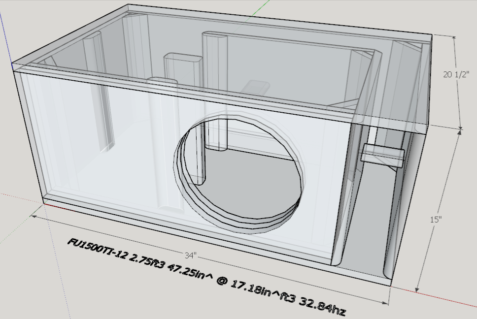

Out of curiosity I'm gonna ask... what enclosure do you have currently? Cause if you step-up in power a bunch you might need to redo it anyways. I looked at what I'd do for port and volume and settled on something like this if I had 3K to throw at it.

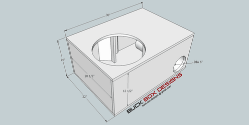

As it shows. I had Buck design a box for me and built it about 3 months ago. I also copied and pasted the wrong model number. Its a 15" not a 12". The box is 3.15 cubes tuned to 33hz. I was looking at some amps yesterday and was thinking about getting the 2500 watt Orion amp or maybe even something that does 3000 watts like the Wolfram amp but I'm still waiting for some more input

youd triple baffle the front? that seems excessive for a single 12 in a slot ported box
