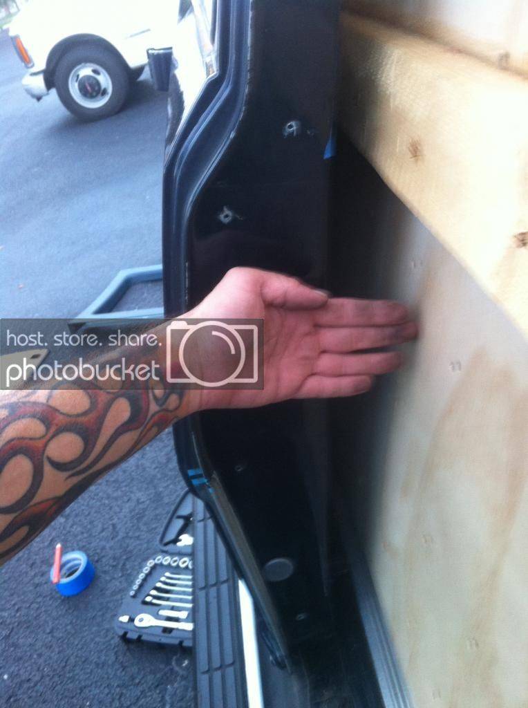

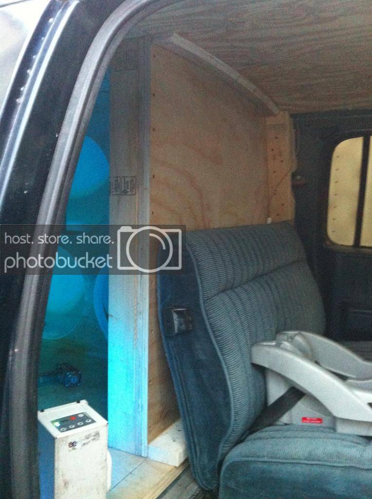

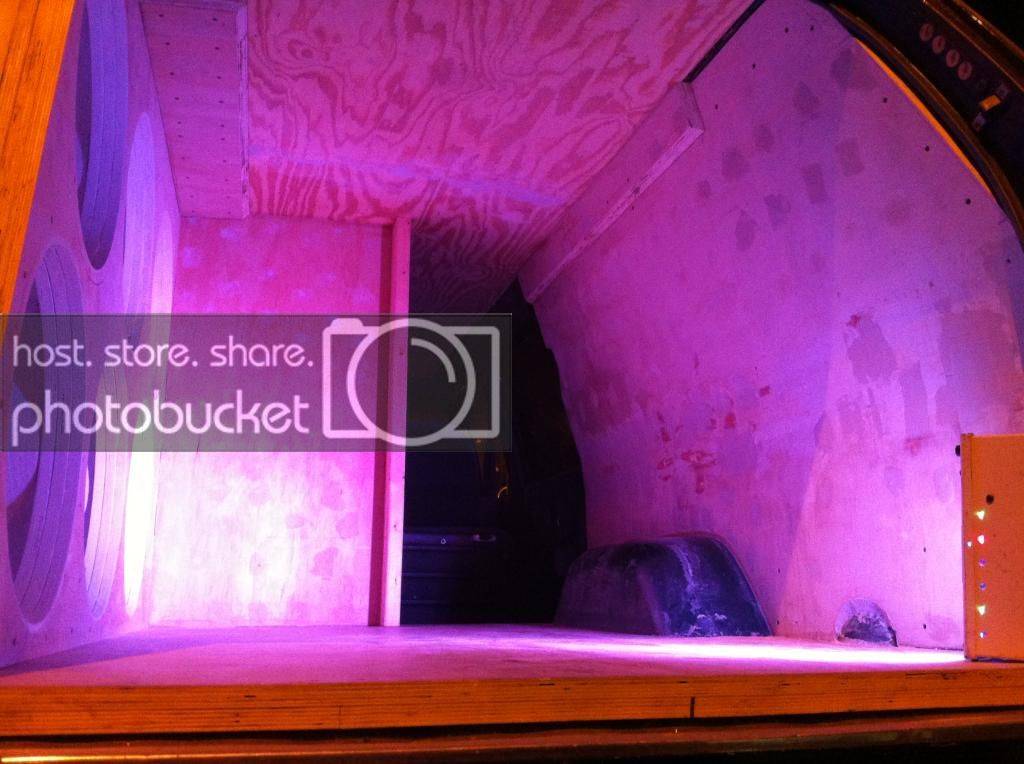

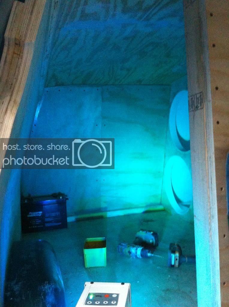

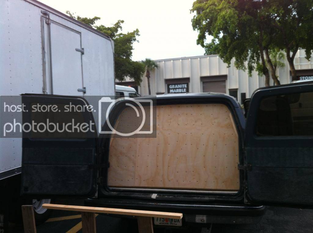

as for the side wall flex - i was curious about this yesterday - so i got inside and put my back against the baffle wall - and tried pressing my feet against the plywood wall on the pasanger side of the truck. i kno i can do 400+ pound squat thrusts so i figured if i cant flex this wall with my legs then the subs probably wont either.

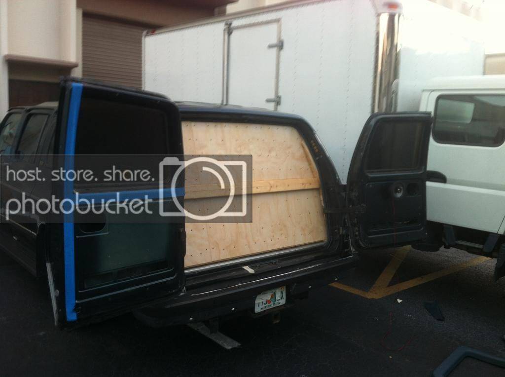

im confident that its sturdy. what you dont see behind the plywood - was 2x4 bracing pieces that i added in the spot where my window goes before i put on my first layer. since i was testing flex - i figured id put my feet on the roof - and try and flex that to see if it had any give also... again - its just as solid as can be. there is so much wood in my roof - and tubes of locktite pl adhesive applied in the roof its not going to move anywehre. id be suprised if i even needed a stripper pole vertical because its just so solid....

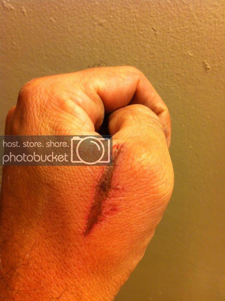

aparently im not the greatest at bondo
my belt sander ran over my left hand - and pinched / pulled the skin up in the back side as it was going a little... was sanding wood at the time
not so fun actually

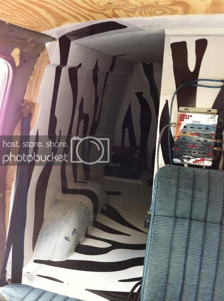

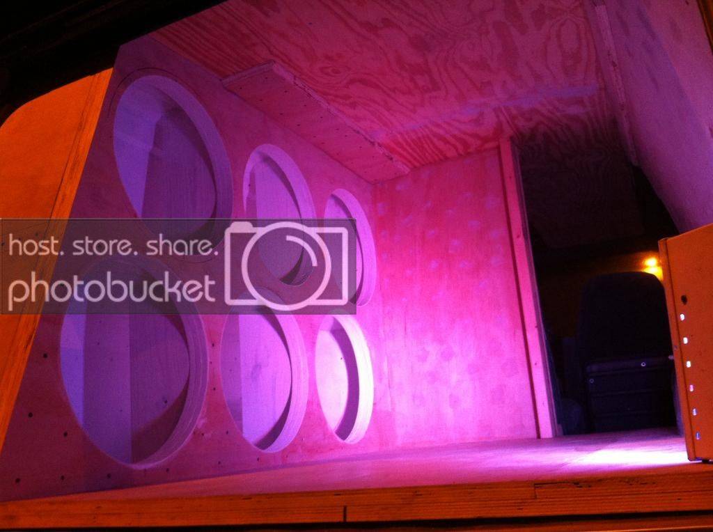

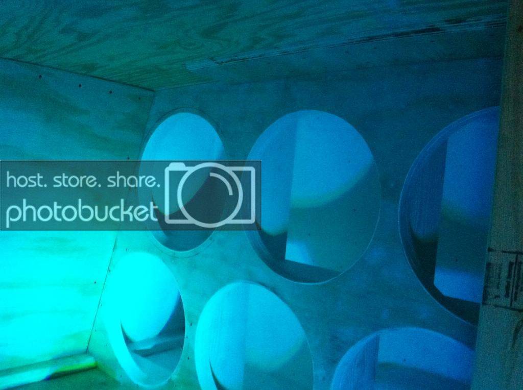

just a few little 45deg. angle pieces left to finish off - then run final bead caulk to seal it real good - and bondo / sand / bondo / sand / bondo and sand
then paint and install the gear again... should be playing in less than 14 days

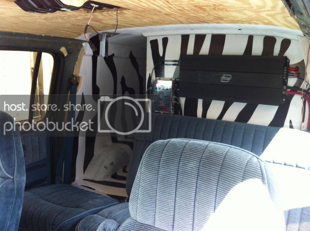

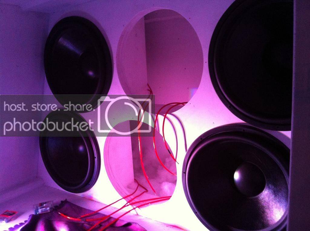

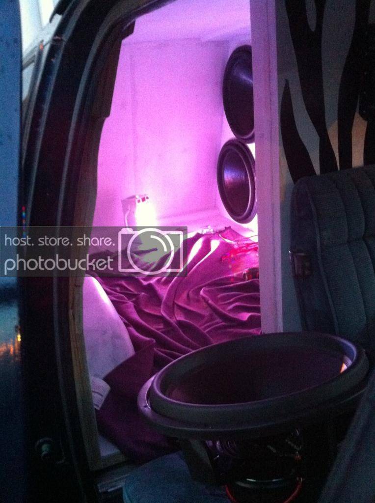

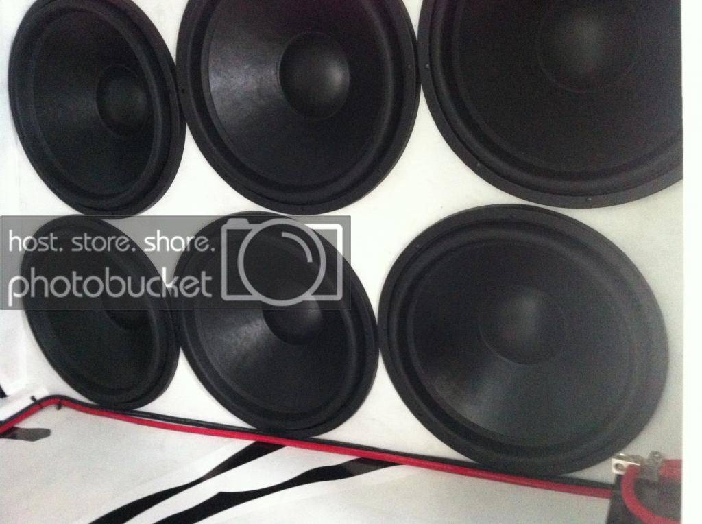

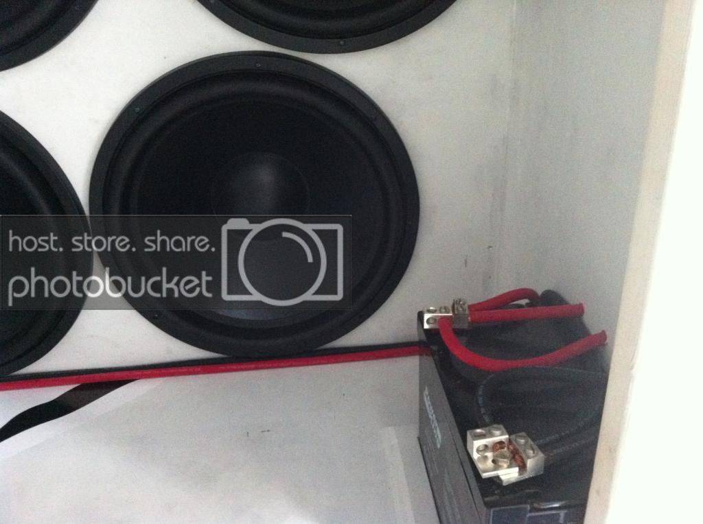

all subs are in - wired up my amps = one of my 4 chans ( mb quart discus 4125 ) decided to start a fireworks show inside its heat sink //content.invisioncic.com/y282845/emoticons/frown.gif.a3531fa0534503350665a1e957861287.gif
still have a good one tho to power my front doors and active super tweeters... tossed in a old schooler rf punch 400a4 to power my midbassers.
still no headunit
still a crappy crossover
tried using a line driver but it introduced ugly ground noise to the system... so not using that
still

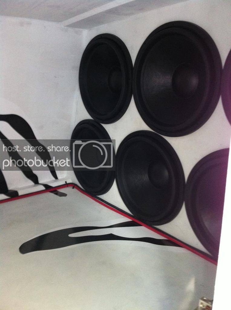

it plays
and sound pretty rad... its loud also. like silly loud - draws a croud whenever turned up ( gain knob for ddm3a has clipping indicator ) so i kno how far i can turn up before playing dirty signal is pretty nice feature actually.
and
dang its loud. its just brutal to sit in - plays the range pretty good - and digs nice and low.

wow i havent updated this in a while... newest trend - bass is shaking everything apart in my burb. its brutal.
had to take my door pannel off today ( driver door ) and fish all the hardware that shook loose and fell inside the door ( rattling around in there ) but some of the bolts and screws were holding my window regulator motor in place shook off from bass causing my driver window to stop functioning.

ok burnt up a mb quart discus 4125 refurb 4 chan. sad that amp was nice. still have one more. old school rockford punch 400a4 is in blown amps place.
ddm3a is getting swapped for atomic 5k - when i have time to install it - and buy some more 1/0 wire for a second run ( dual imputs )

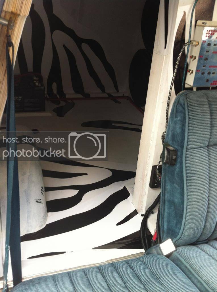

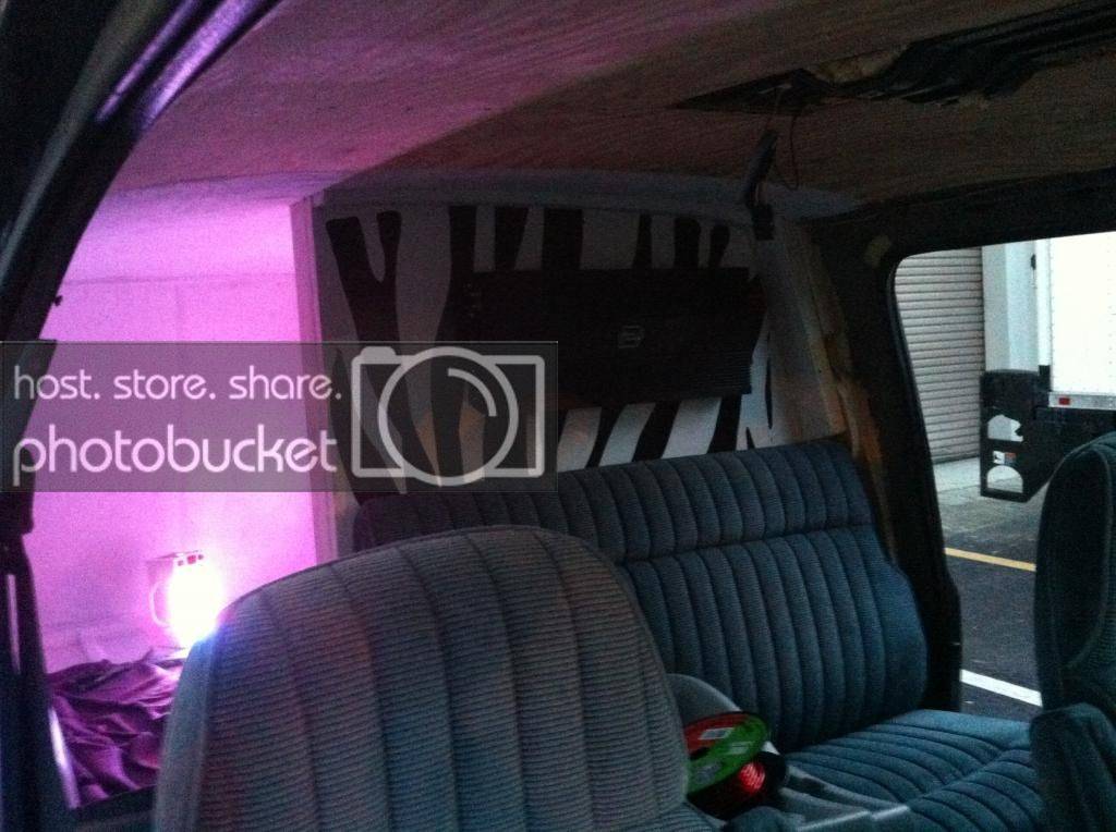

more zebra sticker getting applied

twenty six 6.5" speakers are ordered for my doors... that should be fun ( not realley )

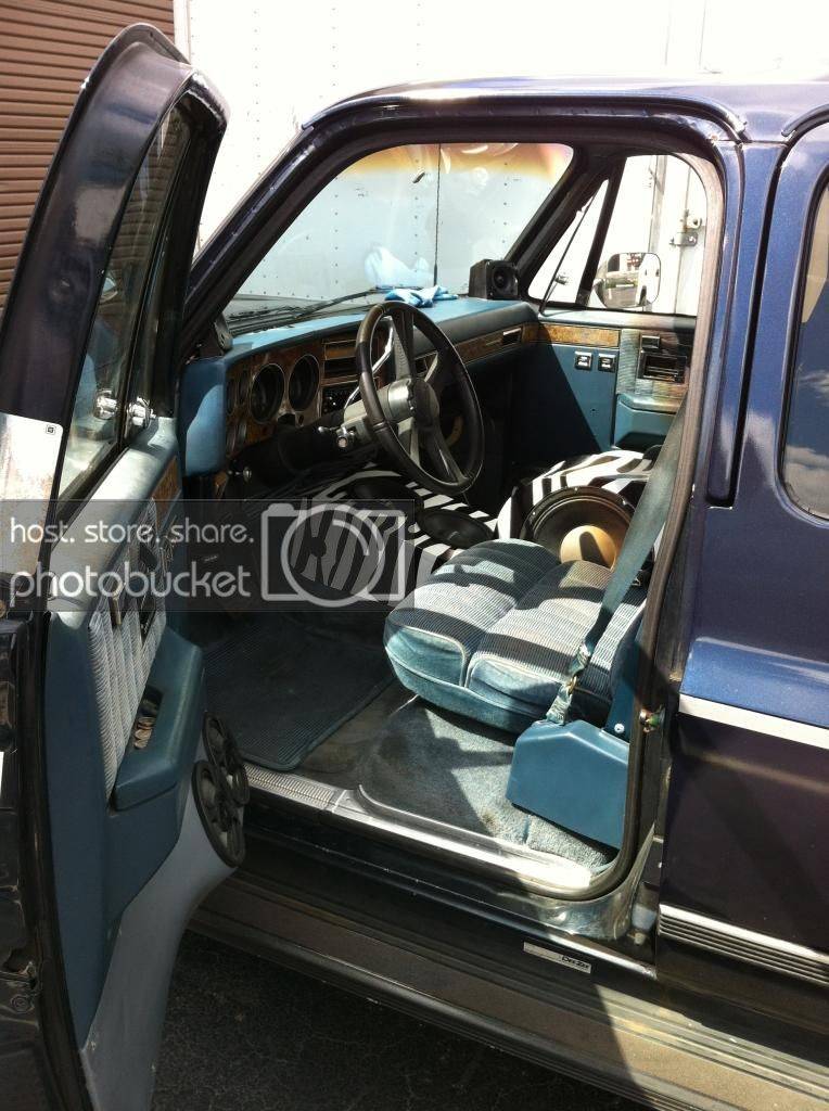

Dude I was reading page 1 and then I skipped to the last page and I am SHOCKED at how good this is coming out!!!!

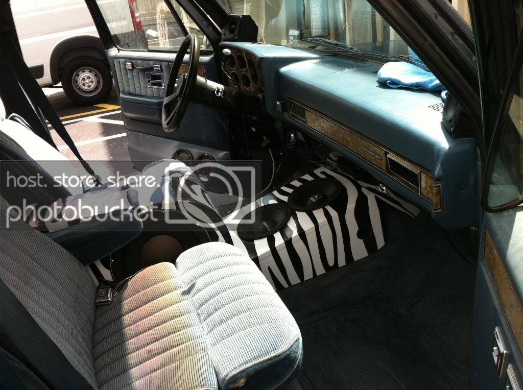

Get some freakin zebra interior for the front and you'll be all set :p

im convincing my work we need a heavy duty sewing machine for me to make us slip covers for our furnature when we truck them to a show - we use blanket pads wich ****. i need to make custom slip covers to protect everything... . + once i have a good sewing machine at my shop - you know im going to re do my interior in something crazy. the zebra was like eh at first - but its realley growing on me....
i guess i am realley ghetto

I'm a fan of the zebra stuff! I used to be against that sort of stuff like I thought it was too flashy or ghetto but it's grown on me too... I mean **** we're building sound systems that can shake buildings... that's about as flashy as it gets lol.
