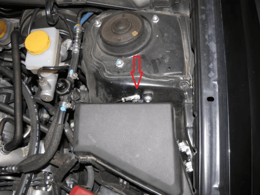

Where is the factory ground location? Where do you see .4 ohms? This is in your Subaru? I'm not familiar with them; do they have a frame or a unibody?

The factory ground location for the front battery is on the driver side strut housing. I'm seeing 0.4 ohms from the rear battery (XS Power d3400) negative to where it is grounded underneath the rear seat. Yes this is in my 05 Outback XT. After some research it seems to be a unibody design.

By "strut housing" I assume you mean upper strut mount (where the struts bolt to the body on either side of the engine bay)? That sounds like a poor oem grounding system all around. Personally, I would run ground wires for everything rather than rely on the factory system. It will be more money, more work, and more reliable.

The ground is not on the strut mounting bolts, rather it is on the side of the housing wall. Like this.
32881
(This is not my car, just an example). On mine, when the big 3 was done by a shop they slapped the 0 gauge negative ground wire on top of the factory ground wire, but didn't strip any additional paint off. Seems to me like that could cause a poor connection and cause a bottleneck.
I think the plan right now is to buy a paint stripping kit and redo the ground for this front battery to make sure there is a good connection. As for the second battery, I am not sure how to get that resistance reading down from 0.4 ohm as the grounding connection looks good with paint stripped. Maybe I'll try to find another location back there. If nothing else, overdrive pulley for the alt might be in my future.
