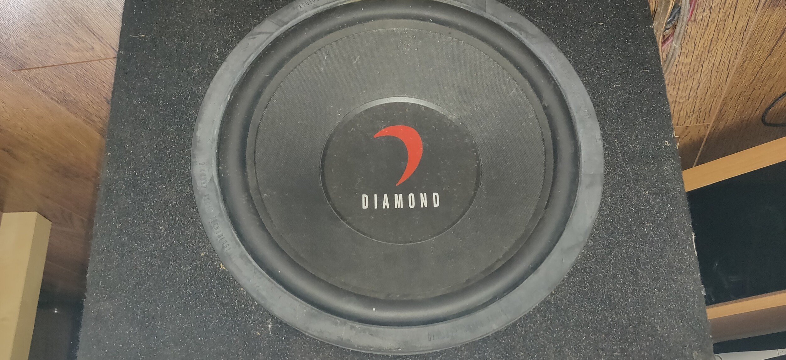

Hi, new to the forum.
Just picked up 2 of these diamond subs. Can anyone tell anything about them? I have no idea on the model number and what they are rated at. I believe 300rms each.
What are diamond subs like ?
Also is it possible to wire these 2 separate subs to one amp ?
Thanks

Diamond subs should be good quality...you can wire both subs to one amp but you'll have to know what ohm voice coils a d if they are dual or single voice coil so you can match the amp to them

Further research shows these might be the ones;
Could you advice on what amp would work with both wired into.
Thanks
If they are dual 2 ohm subs they'd need a 5-600 watt 2 ohm mono amplifier . And the subs would have to be wired series parallel to work ...

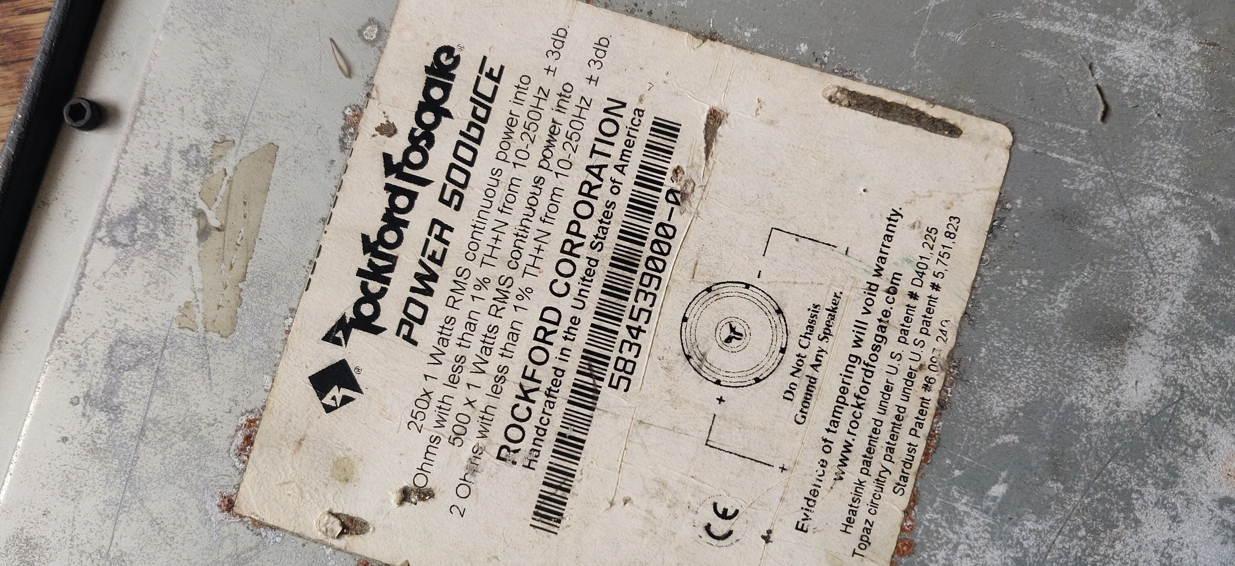

I've got a Rockford Fosgate 500bd monoblock amp. Will that work with the above setup. Thanks .

Is this the way I need to wire up both subs?
Thanks
I would put a multimeter on the terminals and measure the ohm reading just to be sure. A single set of terminals indicates a single voice coil. So wiring two of them together would either give you half the resistance (parallel) or double it (series). i.e. if you have a 2 ohm VC then wiring these in parallel would give you 1 ohm, so you would need a 1 ohm stable amp to drive them without overheating the amp. Series wiring would give you a 4 ohm load.
