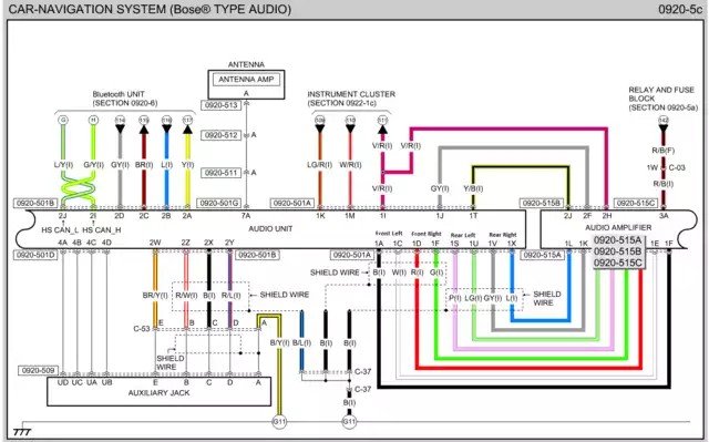

There is no need to run new wires. The issue about that is that on the OEM amplifier, you have to identify the signal wires that come from the stereo, and the ones that go to the speakers. Then you either cut and splice onto them, or cut into the sheath and splice into them. At the radio side, there should be a harness that allows you to plug & play an aftermarket radio.

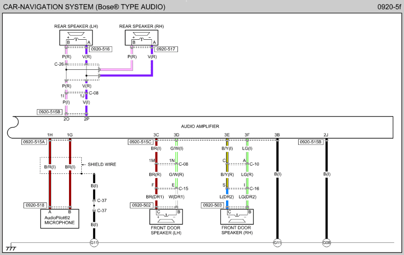

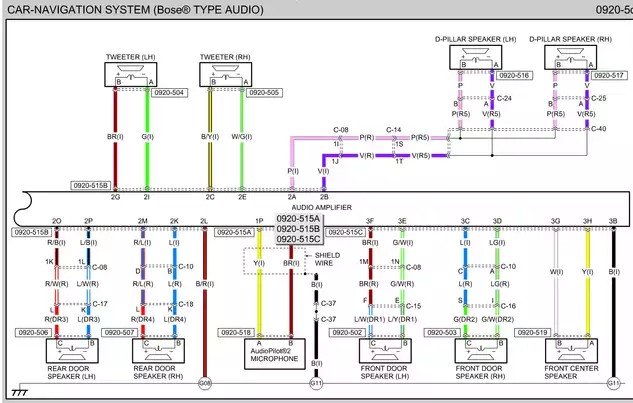

so what if i byepass that bose amp how do i do it ? dont the speaker wires run from a harness from the amp to the speakers ?
Yes, this is the pinout for the amplifier output-
